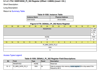

  • And I looked at the spec document and saw that to read the MR5 register it would be through the 0x0F3083B0h register, is this correct?, but the value I read in SBL1 and the devmem2 command on the kernel are both 0x0.
    What is MR5_DATA_F0_0, MR5_DATA_F1_0....? they are both for reading register 5, what is the difference?

  • Hi Huy, it would probably be more practical to come up with a common configuration that would work for both memories.  The interface to write/read MR registers requires that the controller/PHY be in an initialized state, which requires that the memory should already be initialized and trained.  Thus you would need to have a DDR configuration to get to that point anyway.
    You should be able to achieve a common configuration with the 2 devices you mentioned. If there are parameters with different timings, ensure you choose the highest value for the parameter for min valued specs.

    Can you guide me to read it in the SBL of the AM62x chip? How to put the controller/PHY into initial state? and then read the MR register.
    In my test, after Ram init I read register 0x0F3083B0h, its value is still 0x0, is there anything I did wrong?

  • Huy,
    check towards the end of this thread.  This gives you the sequence to read from one of the MR registers.  Ensure you add the delay after the read() function as mentioned.

  • Hello James,
    Thank you for your help, I have read the MR5 register.
