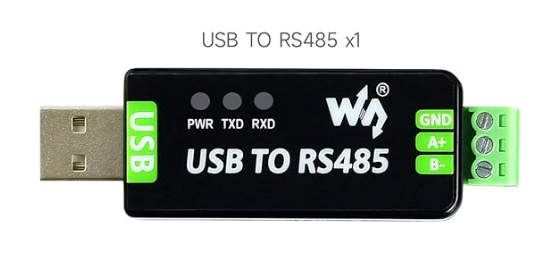

I'm planning to do a proof of concept for a PTZ module with AM67 evaluation kit. The PTZ unit has RS485 interface for the data transmission. The Evaluation kit has USB-A ports. Will the USB-A to RS485 convertor be compatible for it?
Can i control the PTZ unit with this?

    If this USB module implements the standard USB serial gadget function, yes it can be used in Linux to provide UART/RS485 function. However, if you plan to use PTZ modules on your final custom board, I would recommend to find a PTZ evaluation module which has RS232 interface (RXD/TXD/RS485-DE) instead of USB interface, to not bring USB software stack into the path, since it won't be used in the final product.
