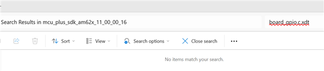

AM625: Where is board_gpio.c.xdt mentioned in mcu sdk interrupt example
Part Number: AM625
board_gpio.c.xdt was mentioned in the user guide, but didn't find it.
  • Hi Tony,
    Thanks for your query.
    This looks like a bug in the documentation. You will need to do changes in the board.c file present in the gpio project example.
    Tushar

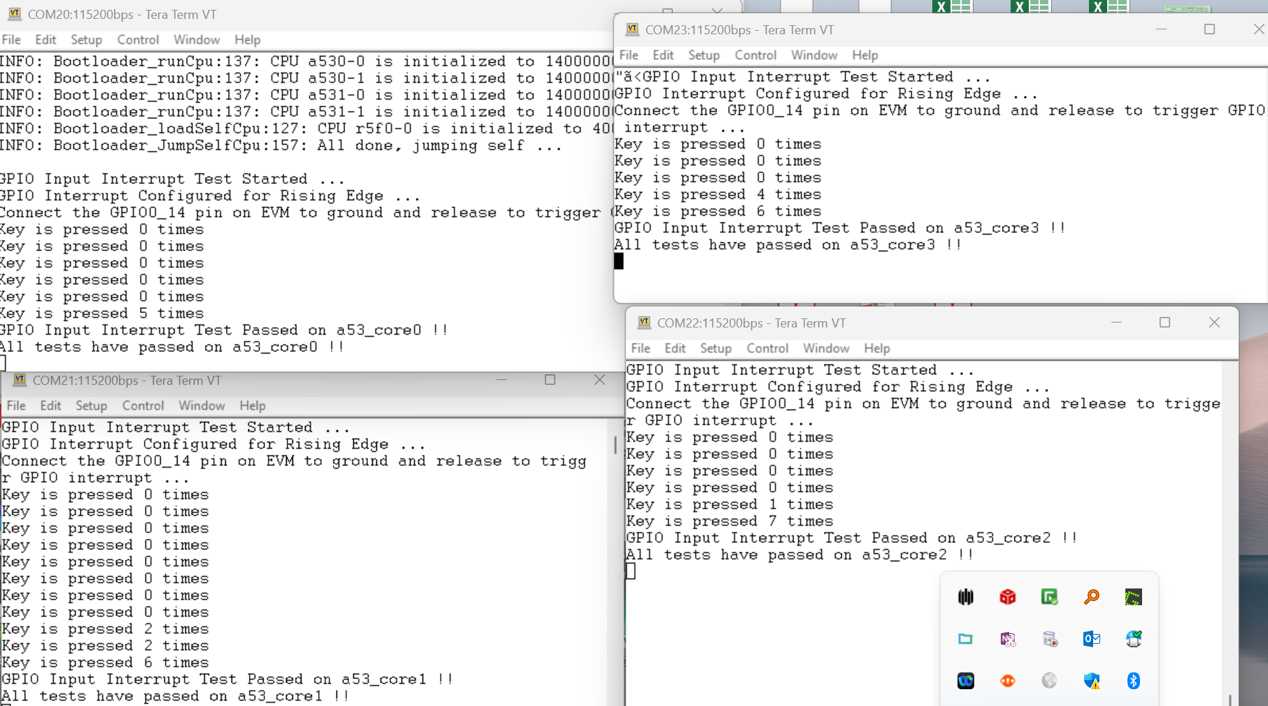

  • There is not such content in board.c
    % if(args.project.cpu == "a53ss0-1"){
    #define BOARD_BUTTON_GPIO_INTR_NUM      (CSLR_GICSS0_COMMON_0_SPI_MAIN_GPIOMUX_INTROUTER0_OUTP_1)
    #define BOARD_BUTTON_GPIO_SWITCH_NUM    ("GPIO0_14")
    % else if(args.project.cpu == "a53ss0-1"){
    #define GPIOMUX_INTROUTER_OUTP (1U)
    it is below in board.c
     * Board info
    #define BOARD_BUTTON_GPIO_INTR_NUM      (CSLR_GICSS0_COMMON_0_SPI_MAIN_GPIOMUX_INTROUTER0_OUTP_0)
    /** \brief bank interrupt source index base */
    #define SRC_IDX_BASE_GPIO_BANK  (CSLR_MAIN_GPIOMUX_INTROUTER0_IN_GPIO0_GPIO_BANK_0)
    /* This is based on TISCI device config and core */
    #define GPIO_MUX_INTROUTER_ID          (TISCI_DEV_MAIN_GPIOMUX_INTROUTER0)
    /* GPIO mux introuter output number */
    #define GPIOMUX_INTROUTER_OUTP (0U)
    board.c are same in four gpio interrupt project. not difference, but works.

  • But for AM62x device the board.c file is not autogenerated
    In user guide: “In this way different SPI_MAIN_GPIOMUX_INTROUTER and GPIO mux introuter output number can be assigned to other a53 cores”
    But the four example use the same  CSLR_GICSS0_COMMON_0_SPI_MAIN_GPIOMUX_INTROUTER0_OUTP_0
  • Hi Tony,
    Yes, by default the example uses CSLR_GICSS0_COMMON_0_SPI_MAIN_GPIOMUX_INTROUTER0_OUTP_0 router output, you can configure this to supported values of the router output.
