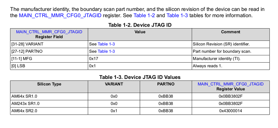

in ti am64x/am243x erreta,   refer to  https://www.ti.com/lit/er/sprz457i/sprz457i.pdf?ts=1750196386747&ref_url=https%253A%252F%252Fwww.ti.com%252Fproduct%252FAM6442
there is a Silicon Revision 1.0 2.0.
How to verify that info in my firmware so that I know which version of chips that I am using.

It is not clear that there is a relationship to Silicon Revision. 1.0 or 2.0
How to check the Silicon Revision 1.0 2.0? If I am running   am2432BSFFHIALV,   from the CPU type, can it tell? or from software.
