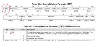

  • After more deep investigation I found that in case of 3.2 kernel PARAM_SET OPT register looks like:
    EDMA_OPT 0x80102000
    The bit 31 (PRIV) has value 1. In case of 6.12 kernel this bit is 0.
    Can it be  the reason?
    Thank you!
