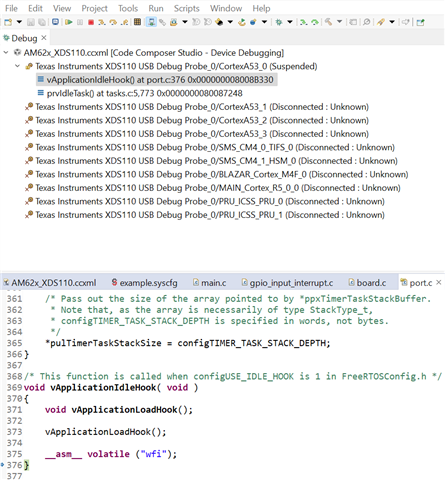

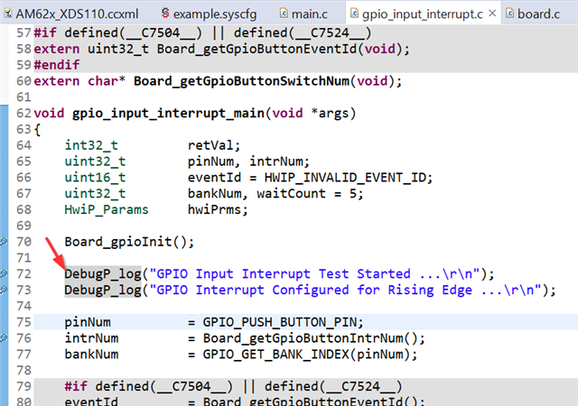

it can run over Board_gpioinit(). but doesn't return from DebugP_log()
Suspend, program stop here:
Console UART doesn't work after re-load?

  • Hi Tony,
    Are you seeing any error message coming on the console? I can see the code is stuck at WFI instruction.
    Have you loaded the example properly?
    Have you reset the core before reloading the program?

  • Hi Tushar,
    No any message output on console on the second running. as you can see, it stuck in DebugP_log().

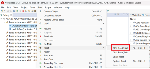

    Sure, CPU reset(HW) before reloading the program. otherwise the program can't run.

  • Hi Tony,
    You can run the example again by doing a System Reset from the CCS.
    Please refer below video.
    Tushar
  • I got it, need to disconnect before do a System Reset. then reconnect, and reload, can make it work.
