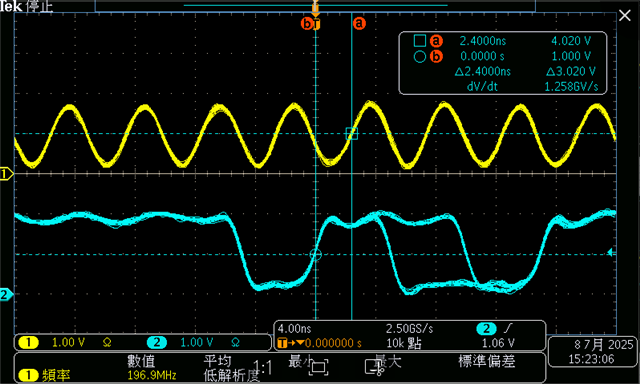

May I ask if the driving strength of the eMMC can be adjusted? If so, how can it be configured? We are currently observing signal attenuation on the CLK line, and the CLK frequency is 200 MHz.

Why do you feel this is a problem? The signal amplitude has significant margin over the VIL (0.35% VDD = 0.63V) and VIH (0.65% VDD = 1.17V) levels defined in the eMMC standard.

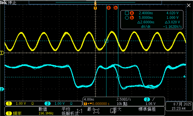

Can you attach a scope capture that shows the clock to data relationship? Make sure you are probing near the eMMC device using a high bandwidth scope with two high bandwidth scope probes that have been de-skewed. I would like to see the setup/hold margin being provided to the eMMC device.

The host is providing plenty of setup and hold time margin to the eMMC device during write operations. You are not able to measure setup and hold time for read operations since the AM62x device captures read data with an internally delayed clock that is positioned in the center of the data valid window by a tuning algorithm.

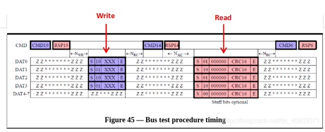

What is happening when you say the peripheral is not working at 200MHz? Is it completely broken, or is it intermittent? How many PCB assemblies have been tested? Do they all experience the same symptoms?
Are you able to read/write data to the attached eMMC device without any issue at a reduced operating frequency? If so, you could potentially try various combinations of reduced rate read/write operations to determine if the issue you are having is associated with reading or writing data at the faster rate.
Can you capture the software log when the failure occurs? If so, this may provide some insight into what is happening.
