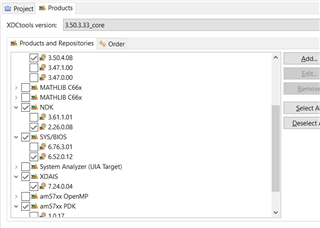

  • Hi Josue,
    Sorry for the confusion here, I couldn't find the SDK version through CCS studio, so I manually gone through the program directory and found the version.
    I'll share the screenshot of my ccs studio build configuration, If this info is not what you expecting can you point out from where I can find this specific info?
    Installed SDK's in my CCS studio
    On ARM side
    Shashank
  • Shashank,
    Thanks for the confirmation. Looks like you have the correct bios installed but you are using the one from an older SDK and not the one from the corresponding SDK version (6.76.3.01).
    I will hopefully make time to look into your query this week.
    -Josue

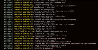

  • Hi Josue,
    An update from my side, I initialized shared memory SR_0 in both the DSP as per the example, Now the DSP1 is loading fine but when I try to load DSP2 I get a memory fault error, I get this error as I'm trying to use already initialized memory but if my understanding is correct this shouldn't happen as in ipc.cfg.xs the owner of the shared memory is DSP1 and the same ipc.cfg.xs is copied to DSP2 path too, Correct me if I'm wrong...
    Kernel logs when I try to load dsp1 and dsp2
    Updated Resource table for DSP1

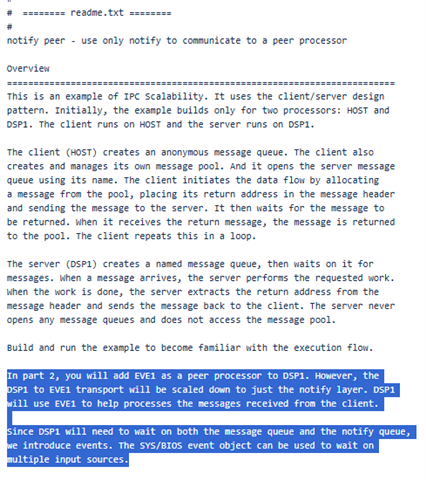

  • Hello Shashank,
    Is your query still open? Have you seen the README on this site? https://git.ti.com/cgit/ipc/ipc-examples/tree/src/examples/templates/ex13_notifypeer/readme.txt
    From this I gather that the second processor would be set as a peer processor, the host would remain the same (A15) and communication from DSP to DSP would be scaled down to notify layer.
    There is also some instruction on how to do this. This  Is no longer validated in the newer SDKs so support for these examples in older SDKs is very limited. I apologize for the delay.
    -Josue
