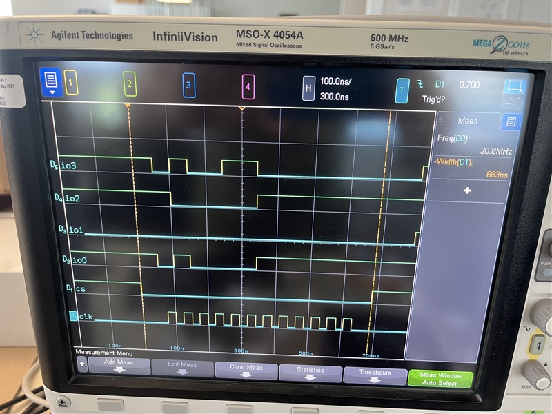

Below is the oscilloscope output, confirming that the communication works correctly and all signals appear as expected:
I’m also able to read 16 bytes at a time without any failures.

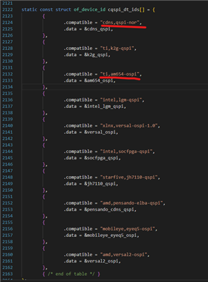

So it matches with the compatible string "ti,am654-ospi" first.

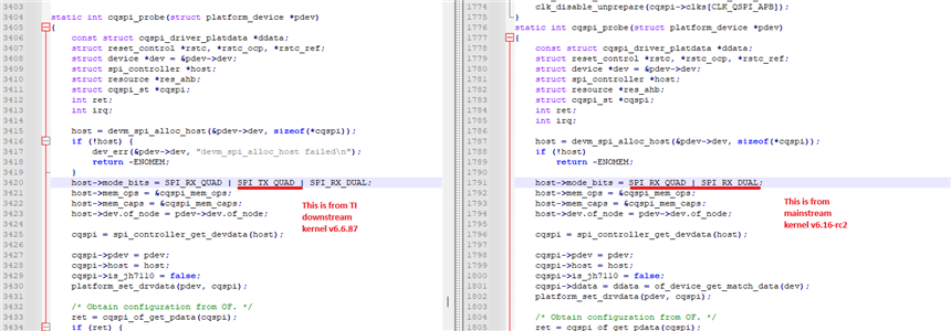

1. Which transfer modes are supported by spi-cadence-quadspi.c?
2. Why do you think read operations succeed while similar write operations fail?
3. When comparing TI’s spi-cadence-quadspi driver in the TI repository versus the one in the mainline Linux kernel, which repository offers broader feature support? Shall we go with linux main stream instead of TI's downstream?
Thanks.
    That particular ti-linux-6.6.y kernel version should have the driver that includes the following commit, that specifically adds the SPI_TX_QUAD transfer mode:
    $ git show 7a78c89eb58bad042c55b7b0234300ab9f561919
    commit 7a78c89eb58bad042c55b7b0234300ab9f561919
    Author: Santhosh Kumar K <s-k6@ti.com>
    Date:   Wed Jul 17 11:56:01 2024 +0530
        spi: cadence-quadspi: Enable SPI_TX_QUAD
        Enable SPI_TX_QUAD in spi_controller->mode_bits to add support for
        the 1S-4S-4S operations.
        Signed-off-by: Santhosh Kumar K <s-k6@ti.com>
        Tested-by: Prasanth Babu Mantena <p-mantena@ti.com>
    diff --git a/drivers/spi/spi-cadence-quadspi.c b/drivers/spi/spi-cadence-quadspi.c
    index 97069f8d27847..c2f83d2c50988 100644
    --- a/drivers/spi/spi-cadence-quadspi.c
    +++ b/drivers/spi/spi-cadence-quadspi.c
    @@ -2801,7 +2801,7 @@ static int cqspi_probe(struct platform_device *pdev)
                    dev_err(&pdev->dev, "devm_spi_alloc_host failed\n");
                    return -ENOMEM;
    -       host->mode_bits = SPI_RX_QUAD | SPI_RX_DUAL;
    +       host->mode_bits = SPI_RX_QUAD | SPI_TX_QUAD | SPI_RX_DUAL;
            host->mem_ops = &cqspi_mem_ops;
            host->mem_caps = &cqspi_mem_caps;
            host->dev.of_node = pdev->dev.of_node;

    >> In any of the write attempts, do you see any signaling coming out of the device at all (e.g., clock signal) on the scope?
    Nothing appears on the oscilloscope when writing. The issue occurs at the spi_mem_supports_op() API call, which is used just before spi_mem_exec_op().
    If I call spi_mem_exec_op() directly without checking whether the operation is supported, it returns an 'invalid parameters' error—and again, nothing shows up on the scope.
    The commit you mentioned, SPI_TX_QUAD, is present in our kernel version 6.6.87, which we obtained from TI’s downstream branch.
    Interestingly, I checked the latest mainline Linux kernel (version 6.16-rc2 as of today), and that commit does not appear to be included there.
    Based on this small patch, it seems we should stick with the TI downstream branch. Maybe we can try version 6.12 from your downstream, as you suggested.

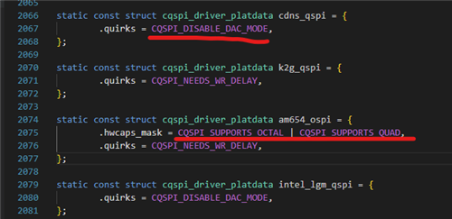

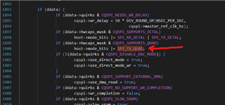

    In the meantime, I have a few questions regarding the device tree OSPI bindings. In your k3-am62-main.dtsi, the OSPI compatible driver is defined as both "ti,am654-ospi", "cdns,qspi-nor". However, in spi-cadence-quadspi.c, both of these strings are listed in the compatibility table, each associated with different quirks. As far as I understand, Linux matches only the first compatible string in the device tree, which would render the second entry irrelevant, right? This matters because the hwcaps_mask used in the probe function is determined based on the quirks defined in those compatibility entries and they are different.
    And later in the probe function SPI_TX_QUAD support added only if hwcaps_mask has CQSPI_SUPPORTS_QUAD which is not the case for "cdns,qspi-nor" but for "ti,am654-ospi"

  • In the meantime, I have a few questions regarding the device tree OSPI bindings. In your k3-am62-main.dtsi, the OSPI compatible driver is defined as both "ti,am654-ospi", "cdns,qspi-nor". However, in spi-cadence-quadspi.c, both of these strings are listed in the compatibility table, each associated with different quirks. As far as I understand, Linux matches only the first compatible string in the device tree, which would render the second entry irrelevant, right?
    It'll pick the first item from the list in the DTS file and try to match it. If it fails, it'll pick the second. And so on. On the other hand, the order of the entries in the matching table in the driver code doesn't matter here.
