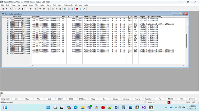

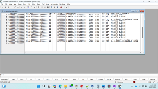

  • in MAIR i cant find never execute (xn) bit, I can only find non-execute, please help with bit getting never execute bit (xn) set in for the above mentioned snip locations.

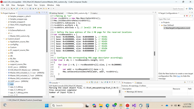

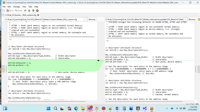

  • Hi Chittapu,
    It looks like the following line is missing in your MMU configuration, Please add this line into your configuration. let us know if this helps.
    attrs0.noExecute = true;
    Karthik
  • we already using that but xn bit is not getting set. above we added the snip of MMU .cfg code at start of ticket.

  • Hi Vishnu,
    Please check below example snippet for setting no execute bit for the memory area that you mentioned above. I just added entries for first two locations in the memory snapshot you have shared. You can extend the rsvdBaseAddrs array for other addresses. Please add this to you bios config and give a try.
    var rsvdAttrs = new Mmu.DescriptorAttrs();
    Mmu.initDescAttrsMeta(rsvdAttrs);
    rsvdAttrs.noExecute = 1;
    rsvdAttrs.accPerm = 0;
    rsvdAttrs.attrIndx = 1; // level2: 2MB area
    // Define the base address of the 2 MB page for the reserved locations
    var rsvdBaseAddrs = [
    { base: 0x40000000, size: 0x03200000 }, // RSVD1
    { base: 0x43600000, size: 0x04A00000 } // RSVD2
    // Configure the corresponding MMU page descriptor accordingly
    for (var i =0; i < rsvdBaseAddrs.length; i++)
    for (var j = 0; j < rsvdBaseAddrs[i].size; j += 0x200000)
    var addr = rsvdBaseAddrs[i].base + j;
    Mmu.setSecondLevelDescMeta(addr, addr, rsvdAttrs);
    - Pratap.
  • Hi Team,
    we have updated the code as below snip (highlighted in green color).
    Before updating the MMU configuration,
    After updating the MMU configuration, result is same. still some memory regions showing as "ex".
    Can you please help to all memory regions make as "xn".

  • Hi Pratap,
    We updated the code as below attached screenshot. After adding the code, My application is not booting. If possible shall we schedule a short session.
    Vishnu

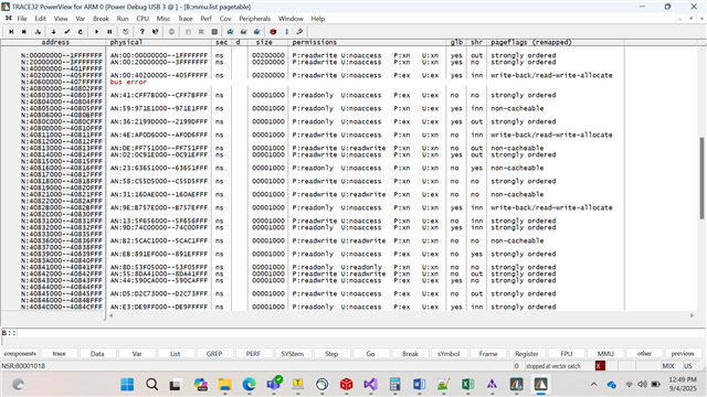

  • Hi Vishnu,
    Looks like reserved memory with base address 0x40200000 is causing some issue for the MMU init which is making the boot failure. Can you please remove this address entry from the array for now and check if you are able to boot your application. If it boots, please confirm if never execute bits are set for other memory locations.
    - Pratap.
  • Hi Pratap,
    Removed 0x40200000 memory location, it is booted but exception occurred. so for this, We tried to enable only one memory region at a time in the same list to check where the exception is happens. But after enabling only 0x40600000 location no exception was observed but it seems, if we configure the MMU configuration second time a BUS error was occurred(as observed in Trace32).
    If Possible, shall we schedule a quick session for better understanding the issue.
