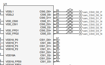

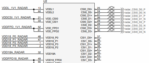

  • Hi Lucas,
    Thank you very much for your help.
    1. I previously tried to forward RX0/1 to CSI port 0 and RX2/3 to CSI port 1, but only CSI port 0 could output the video stream.  After reviewing the schematic, I noticed that each UB960 chip only has one CSI port enabled. Does this mean the board cannot support the configuration of forwarding RX0/1 to CSI port 0 and RX2/3 to CSI port 1 simultaneously?
    2. Can I use the 960 chip on the radar to transmit the other two video streams?
    Thank you.
  • Hi Ying,
    If CSI port 1 output pins of the 960 are not connected to anything, then the port cannot be used. I'm unsure how each of these 960 devices are connected so I cannot comment if the other 960 chip can be used to transmit the other 2 streams.

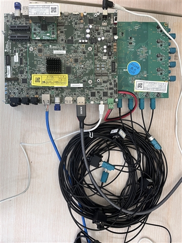

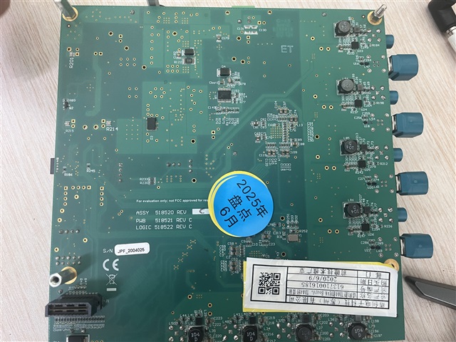

  • Hi Lucas,
    I am using TI's development board and deserializer board, as shown in the figure below.
    My sensor is OX03C10, with output configuration of 1920×1280, 30 fps, raw12. Vertical Blanking Lines is 1365. The serializer is ds90ub953. Theoretically, it should not exceed the bandwidth of 960, but in practice, errors keep occurring.
  • Hi Lucas,
    My problem has been solved. I used the two ub960 chips on this deserializer board to transmit two video streams respectively. Thank you very much for your help these days.
