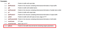

    Secondly, I don't understand the meaning behind the pShift parameters (Pointer to buffer with shift value at every stage of FFT) ? What does it represent ? What's its purpose in the FFT algorithm ?
    Finally, is the FFTLIB_fft1d_i16sc_c16sc_o16sc_ci file providing optimized functions version of the functions from  FFTLIB_fft1d_i16sc_c16sc_o16sc_cn.c  file ?
    In fixed-point arithmetic, the results at each stage of the FFT can grow in magnitude, causing overflow. To prevent this, scaling is applied to the intermediate results using the pshift parameter.

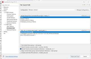

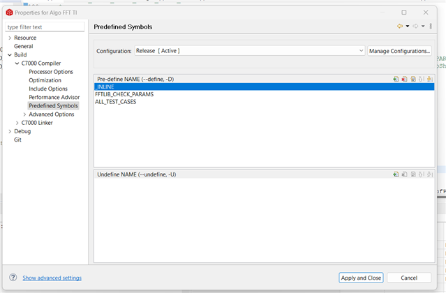

    Firstly, I don't understand why the compiler doesn't find the header since I've put the correct paths. Also, I tried to fix it manually by adding a #include, but then I got new error because the compiler coudln't find again another header file....

    Okay. Do you mean the compiler is unable to fiind the .h file?
    I hope you have included the path in the CCS  "include path".

  • What is the purpose of this parameter in the algorithm? What is its role?
    Betsy Varughese
  • How do I know how to initialize it?
    It depends on how many times SE/SA parameters need to be used within the code.
    Betsy Varughese

    So, that means that there are 3 SE/SA parameters used ? Do I have to use the TI_memalign() function to do the allocation ?
  • Please refer "/ti-processor-sdk-rtos-j784s4-evm-10_01_00_04/fftlib/src/fft_c7x/FFTLIB_fft1d_i16sc_c16sc_o16sc/FFTLIB_fft1d_i16sc_c16sc_o16sc.h"
    /* PBLOCK has to accommodate certain number of SE/SA configurations */
    #define FFTLIB_FFT1D_I16SC_C16SC_O16SC_PBLOCK_SIZE (9 * SE_PARAM_SIZE)
    and check corresponding "d.c file" for the usuage.
    uint8_t FFTLIB_fft1d_i16sc_c16sc_o16sc_pBlock
        [FFTLIB_FFT1D_I16SC_C16SC_O16SC_PBLOCK_SIZE];
    Betsy Varughese

    Yes, I showed you previously my include paths, and everything seemed good to you

        // => Implique l'ajout du predefined symbol ALL_TEST_CASES pour y avoir acces

         * FFTLIB_fft1d_i16sc_c16sc_o16sc_checkParams() : function checks the validity of the parameters passed to init and kernel functions
         * FFTLIB_fft1d_i16sc_c16sc_o16sc_init(): function setting up the configuration for the streaming engine
         * FFTLIB_fft1d_i16sc_c16sc_o16sc_kernel() This function is the main kernel compute function

    However, whenever I try to run the code (in Release mode), the code runs in a loop without stopping.... I added some log, and I saw that the creation of pBlock is done successfully. I don't even understand why but it seems there are some issues now while using FFTLIB functions..
    I tried to declared the FFTLIB_fft1d_i16sc_c16sc_o16sc_pBlock array inside the main function as you suggested, but it didn't change anything
    Mélanie

  • Hi Betsy,
    Tell me if I'm wrong, but if the code run in loop so far, it was because the compiler didn't have the definition of the FFTLIB_fft1d_i16sc_c16sc_o16sc_checkParams function since none of the following predefined symbol were declared : FFTLIB_CHECK_PARAMS ||FFTLIB_FFT1D_I16SC_C16SC_O16SC_CHECK_PARAMS
    As a result, I tried to add one of them :
    Then, I uncommented the use of FFTLIB_fft1d_i16sc_c16sc_o16sc_checkParams in the main() function. However, I got the previous issue again, could you explain why ?
