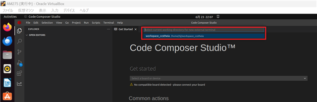

Hi Haley,
I tried CTRL+Shift+C but it doesn't work. Could you try it on linux?
When I press CTRL+Shift+C, following wiondow in red is dsplayed.
Ito
Ito-san,
Please note that CTRL+Shift+C is for opening an external terminal window. To open a terminal window inside the IDE, please use CTRL+Shift+`
I will update the document to reflect this.
Thank y ou
ki
Hi Ki,
Thanks a lots.
I could open the terminal window. It is very helpful for me.
