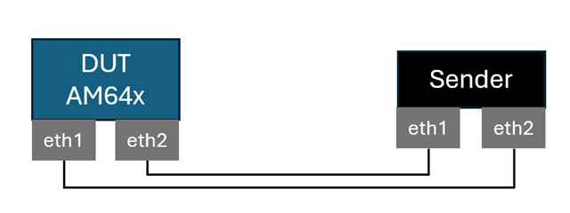

Hello Ti,
I'm currently testing with the release : 11.00.09.04
I found that there are two IRQs coming from queues from eth1 and eth2 for HSR packets. But the duplicated packets should be removed by the PRU firmware, I would expect only one IRQ.
Here is the procedure :

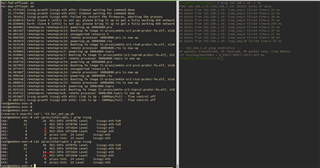

Here is what I've observed :
root@am64xx-evm:~# ethtool -s eth1 speed 100 duplex full
ed 100 duplex fullroot@am64xx-evm:~# ethtool -s eth2 speed 100 duplex full
root@am64xx-evm:~#
root@am64xx-evm:~#
root@am64xx-evm:~#
root@am64xx-evm:~# ./hsr_script_ti.sh hsr_hw eth1 eth2 192.168.1.19
ip=192.168.1.19
if=hsr0
mac=70:ff:76:1f:41:11
slave-a=eth1
slave-b=eth2
Cannot find device "hsr0"
hsr-tag-ins-offload: off
hsr-tag-rm-offload: off
hsr-fwd-offload: off
hsr-dup-offload: off
Actual changes:
hsr-tag-ins-offload: on [not requested]
hsr-dup-offload: on
hsr-tag-rm-offload: on
hsr-fwd-offload: on
hsr-dup-offload: on
Actual changes:
hsr-dup-offload: on
hsr-fwd-offload: on
hsr-dup-offload: on
[   31.757554] icssg-prueth icssg1-eth eth1: timeout waiting for command done
[   31.774708] icssg-prueth icssg1-eth eth2: timeout waiting for command done
[   31.781651] icssg-prueth icssg1-eth: Failed to restart the firmwares, aborting the process
[   34.830876] hsr0: Slave A (eth1) is not up; please bring it up to get a fully working HSR network
[   34.839846] hsr0: Slave B (eth2) is not up; please bring it up to get a fully working HSR network
[   34.869401] remoteproc remoteproc13: powering up 300b4000.pru
[   34.881567] remoteproc remoteproc13: Booting fw image ti-pruss/am65x-sr2-pru0-pruhsr-fw.elf, siz8
[   34.891101] remoteproc remoteproc13: unsupported resource 5
[   34.896760] remoteproc remoteproc13: remote processor 300b4000.pru is now up
[   34.903924] remoteproc remoteproc16: powering up 30084000.rtu
[   34.913148] remoteproc remoteproc16: Booting fw image ti-pruss/am65x-sr2-rtu0-pruhsr-fw.elf, siz0
[   34.922672] remoteproc remoteproc16: remote processor 30084000.rtu is now up
[   34.929805] remoteproc remoteproc7: powering up 3008a000.txpru
[   34.939081] remoteproc remoteproc7: Booting fw image ti-pruss/am65x-sr2-txpru0-pruhsr-fw.elf, si2
[   34.948748] remoteproc remoteproc7: remote processor 3008a000.txpru is now up
[   34.958728] remoteproc remoteproc14: powering up 300b8000.pru
[   34.967992] remoteproc remoteproc14: Booting fw image ti-pruss/am65x-sr2-pru1-pruhsr-fw.elf, siz8
[   34.977474] remoteproc remoteproc14: unsupported resource 5
[   34.983087] remoteproc remoteproc14: remote processor 300b8000.pru is now up
[   34.990236] remoteproc remoteproc15: powering up 30086000.rtu
[   34.999348] remoteproc remoteproc15: Booting fw image ti-pruss/am65x-sr2-rtu1-pruhsr-fw.elf, siz6
[   35.008831] remoteproc remoteproc15: remote processor 30086000.rtu is now up
[   35.015949] remoteproc remoteproc8: powering up 3008c000.txpru
[   35.025142] remoteproc remoteproc8: Booting fw image ti-pruss/am65x-sr2-txpru1-pruhsr-fw.elf, si0
[   35.034722] remoteproc remoteproc8: remote processor 3008c000.txpru is now up
[   35.053607] icssg-prueth icssg1-eth eth1: Link is Up - 100Mbps/Full - flow control off
[   36.089765] icssg-prueth icssg1-eth eth2: Link is Up - 100Mbps/Full - flow control off
root@am64xx-evm:~#

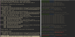

After pinging we see that the number of IRQs are increasing for eth1 and eth2.
I also have these undesired logs when enable HSR offload with the script :
Is it possible to reproduce this on your side ?

    root@am64xx-evm:~# cat /proc/interrupts | grep icssg
    146:         45          7  MSI-INTA 1970792 Level     icssg1-eth-tx0
    150:         16          0  MSI-INTA 1970796 Level     icssg1-eth-tx0
    246:          0          0  MSI-INTA 1971824 Level     icssg1-eth
    262:          0          0  MSI-INTA 1971840 Level     icssg1-eth
    542:          0          0  pruss-intc  24 Level     icssg1-eth
    543:          0          0  pruss-intc  25 Level     icssg1-eth
    146:         61         12  MSI-INTA 1970792 Level     icssg1-eth-tx0
    150:         16          1  MSI-INTA 1970796 Level     icssg1-eth-tx0
    262:         10          2  MSI-INTA 1971840 Level     icssg1-eth

    And we can see that we only receive one IRQ from eth1 or eth2 :
    However, when I try to set link speed with 100Mbps link speed with the command above :
    Here are the logs :

    root@am64xx-evm:~# tcpdump -i hsr0
    [   44.647449] hsr0: entered promiscuous mode
    [   44.651757] kauditd_printk_skb: 5 callbacks suppressed
    [   44.651769] audit: type=1700 audit(1736375607.008:17): dev=hsr0 prom=256 old_prom=0 auid=42949675
    [   44.668586] audit: type=1300 audit(1736375607.008:17): arch=c00000b7 syscall=208 success=yes exi)
    [   44.696447] audit: type=1327 audit(1736375607.008:17): proctitle=74637064756D70002D690068737230
    tcpdump: verbose output suppressed, use -v[v]... for full protocol decode
    listening on hsr0, link-type EN10MB (Ethernet), snapshot length 262144 bytes
    22:33:33.373381 IP6 am64xx-evm > ip6-allrouters: ICMP6, router solicitation, length 16
    ^C
    1 packet captured[   56.086412] hsr0: left promiscuous mode
    1 packet received by filter
    0 packets dropped by kernel
    [   56.091380] audit: type=1700 audit(1736375618.448:18): dev=hsr0 prom=0 old_prom=256 auid=42949675
    [   56.134682] audit: type=1300 audit(1736375618.448:18): arch=c00000b7 syscall=57 success=yes exit)
    [   56.161991] audit: type=1327 audit(1736375618.448:18): proctitle=74637064756D70002D690068737230
    root@am64xx-evm:~# tcpdump -i eth1
    [   58.879618] icssg-prueth icssg1-eth eth1: entered promiscuous mode
    [   58.886092] audit: type=1700 audit(1736375621.240:19): dev=eth1 prom=256 old_prom=0 auid=42949675
    [   58.897597] audit: type=1300 audit(1736375621.240:19): arch=c00000b7 syscall=208 success=yes exi)
    [   58.925443] audit: type=1327 audit(1736375621.240:19): proctitle=74637064756D70002D690065746831
    listening on eth1, link-type EN10MB (Ethernet), snapshot length 262144 bytes
    22:33:41.661365 70:ff:76:1f:41:11 (oui Unknown) > 01:15:4e:00:01:2d (oui Unknown), ethertype Unknow
            0x0000:  0001 7e0a 1706 70ff 761f 4111 0000 0000  ..~...p.v.A.....
            0x0010:  0000 0000 0000 0000 0000 0000 0000 0000  ................
            0x0020:  0000 0000 0000 0000 0000 0000 0000       ..............
    22:33:42.077384 IP6 am64xx-evm > ip6-allrouters: ICMP6, router solicitation, length 16
    22:33:43.677360 70:ff:76:1f:41:11 (oui Unknown) > 01:15:4e:00:01:2d (oui Unknown), ethertype Unknow
            0x0000:  0001 7e0b 1706 70ff 761f 4111 0000 0000  ..~...p.v.A.....
    22:33:45.032544 LLDP, length 214: am64xx-evm
    22:33:45.693362 70:ff:76:1f:41:11 (oui Unknown) > 01:15:4e:00:01:2d (oui Unknown), ethertype Unknow
            0x0000:  0001 7e0c 1706 70ff 761f 4111 0000 0000  ..~...p.v.A.....
    ^C
    5 packets captured[   63.556085] icssg-prueth icssg1-eth eth1: left promiscuous mode
    5 packets received by filter
    [   63.563358] audit: type=1700 audit(1736375625.916:20): dev=eth1 prom=0 old_prom=256 auid=42949675
    [   63.606680] audit: type=1300 audit(1736375625.916:20): arch=c00000b7 syscall=57 success=yes exit)
    [   63.634195] audit: type=1327 audit(1736375625.916:20): proctitle=74637064756D70002D690065746831
    root@am64xx-evm:~#
    I cannot ping from my VM with the same setup :
    My questions here are :
    - For HSR Script, could you confirm that we need first start icssg (up eth1 and eth2) before up hsr0 interface ? (I would say yes since hsr offload is working in this case)
    - When doing like this, if we want to set first with ethtool 100 Mbps link speed eth1 and eth2, the Device Under Tests cannot receive any packets, is it normal ? Maybe could you try to reproduce this on your side ?
    - Tianyi

    Yes sure. The difference between TEST1 and TEST2 is in TEST 2 we set manually 100 Mbps link speed with the following commands.
    With TEST1, we are using ReDBox Hirshman 100 Mbps link speed as sender, therefore, AM64x (DUT) takes 100Mbps link speed with auto negociation
    With TEST2, we are using AM64x as sender, we must here set 100 Mbps link speed on the DUT side to force somehow the 100Mbps link speed.
    Because some of our board support 1000Mbps link speed we must use these command to set to 100Mbps link speed.
    145:        266        159  MSI-INTA 1970792 Level     icssg1-eth-tx0
    149:        127        212  MSI-INTA 1970796 Level     icssg1-eth-tx0
    245:        171        148  MSI-INTA 1971824 Level     icssg1-eth
    261:        140        196  MSI-INTA 1971840 Level     icssg1-eth
    541:          0          0  pruss-intc  24 Level     icssg1-eth
    542:          0          0  pruss-intc  25 Level     icssg1-eth
    root@am64xx-evm:~# [ 6448.294219] icssg-prueth icssg1-eth eth1: Link is Down
    root@am64xx-evm:~# ip link set dev eth1 down
    root@am64xx-evm:~# ip link set dev eth2 down
    [ 6471.799776] icssg-prueth icssg1-eth eth2: Link is Down
    [ 6471.805044] remoteproc remoteproc7: stopped remote processor 3008a000.txpru
    [ 6471.805107] remoteproc remoteproc16: stopped remote processor 30084000.rtu
    [ 6471.805117] remoteproc remoteproc15: stopped remote processor 300b4000.pru
    [ 6471.805128] remoteproc remoteproc8: stopped remote processor 3008c000.txpru
    [ 6471.805137] remoteproc remoteproc14: stopped remote processor 30086000.rtu
    [ 6471.805147] remoteproc remoteproc13: stopped remote processor 300b8000.pru
    root@am64xx-evm:~# [ 6528.677629] page_pool_release_retry() stalled pool shutdown 530 inflight 60 sec
    [ 6532.261631] page_pool_release_retry() stalled pool shutdown 343 inflight 60 sec
    root@am64xx-evm:~# ip link set dev eth1 up
    [ 6553.495535] remoteproc remoteproc15: powering up 300b4000.pru
    [ 6553.495881] remoteproc remoteproc15: Booting fw image ti-pruss/am65x-sr2-pru0-pruhsr-fw.elf, size8
    [ 6553.495911] remoteproc remoteproc15: unsupported resource 5
    [ 6553.495941] remoteproc remoteproc15: remote processor 300b4000.pru is now up
    [ 6553.495973] remoteproc remoteproc16: powering up 30084000.rtu
    [ 6553.496122] remoteproc remoteproc16: Booting fw image ti-pruss/am65x-sr2-rtu0-pruhsr-fw.elf, size6
    [ 6553.496154] remoteproc remoteproc16: remote processor 30084000.rtu is now up
    [ 6553.496177] remoteproc remoteproc7: powering up 3008a000.txpru
    [ 6553.496296] remoteproc remoteproc7: Booting fw image ti-pruss/am65x-sr2-txpru0-pruhsr-fw.elf, siz2
    [ 6553.496326] remoteproc remoteproc7: remote processor 3008a000.txpru is now up
    [ 6553.500665] remoteproc remoteproc13: powering up 300b8000.pru
    [ 6553.500901] remoteproc remoteproc13: Booting fw image ti-pruss/am65x-sr2-pru1-pruhsr-fw.elf, size8
    [ 6553.500927] remoteproc remoteproc13: unsupported resource 5
    [ 6553.500955] remoteproc remoteproc13: remote processor 300b8000.pru is now up
    [ 6553.500994] remoteproc remoteproc14: powering up 30086000.rtu
    [ 6553.501141] remoteproc remoteproc14: Booting fw image ti-pruss/am65x-sr2-rtu1-pruhsr-fw.elf, size4
    [ 6553.501174] remoteproc remoteproc14: remote processor 30086000.rtu is now up
    [ 6553.501195] remoteproc remoteproc8: powering up 3008c000.txpru
    [ 6553.501311] remoteproc remoteproc8: Booting fw image ti-pruss/am65x-sr2-txpru1-pruhsr-fw.elf, siz4
    [ 6553.501340] remoteproc remoteproc8: remote processor 3008c000.txpru is now up
    [ 6553.564689] pps pps1: new PPS source ptp2
    root@am64xx-evm:~# ip link set dev eth1[ 6556.646258] icssg-prueth icssg1-eth eth1: Link is Up - 1Gbf
    ^C
    root@am64xx-evm:~#
    root@am64xx-evm:~#
    root@am64xx-evm:~# ip link set dev eth2 up
    root@am64xx-evm:~# [ 6583.846220] icssg-prueth icssg1-eth eth2: Link is Up - 1Gbps/Full - flow contrf
    [ 6589.093636] page_pool_release_retry() stalled pool shutdown 530 inflight 120 sec
    root@am64xx-evm:~#
    root@am64xx-evm:~# cat /proc/interrupts | grep icssg[ 6592.677635] page_pool_release_retry() stalledc
    145:        304        220  MSI-INTA 1970792 Level     icssg1-eth-tx0
    149:        162        215  MSI-INTA 1970796 Level     icssg1-eth-tx0
    245:        172        148  MSI-INTA 1971824 Level     icssg1-eth
    261:        157        201  MSI-INTA 1971840 Level     icssg1-eth
    root@am64xx-evm:~# uname -a[ 6649.509646] page_pool_release_retry() stalled pool shutdown 530 infligc
    Linux am64xx-evm 6.6.58-rt45-ti-rt-01780-gc79d7ef3a56f-dirty #1 SMP PREEMPT_RT Wed Nov 27 14:15:26 Ux
    root@am64xx-evm:~# [ 6653.093632] page_pool_release_retry() stalled pool shutdown 343 inflight 181 sc
    [ 6709.925646] page_pool_release_retry() stalled pool shutdown 530 inflight 241 sec
    [ 6713.509628] page_pool_release_retry() stalled pool shutdown 343 inflight 241 sec

    [ 6566.528605] remoteproc remoteproc14: remote processor 30084000.rtu is now up
    [ 6566.533777] remoteproc remoteproc7: powering up 3008a000.txpru
    [ 6566.535907] remoteproc remoteproc7: Booting fw image ti-pruss/am65x-sr2-txpru0-pruhsr-fw.elf, si2
    [ 6566.535973] remoteproc remoteproc7: remote processor 3008a000.txpru is now up
    [ 6566.536264] remoteproc remoteproc15: powering up 300b8000.pru
    [ 6566.536421] remoteproc remoteproc15: Booting fw image ti-pruss/am65x-sr2-pru1-pruhsr-fw.elf, siz8
    [ 6566.536441] remoteproc remoteproc15: unsupported resource 5
    [ 6566.536464] remoteproc remoteproc15: remote processor 300b8000.pru is now up
    [ 6566.536484] remoteproc remoteproc16: powering up 30086000.rtu
    [ 6566.536597] remoteproc remoteproc16: Booting fw image ti-pruss/am65x-sr2-rtu1-pruhsr-fw.elf, siz4
    root@am64xx-evm:~# [ 6566.538735] remoteproc remoteproc16: remote processor 30086000.rtu is now up
    [ 6566.538806] remoteproc remoteproc8: powering up 3008c000.txpru
    [ 6566.539040] remoteproc remoteproc8: Booting fw image ti-pruss/am65x-sr2-txpru1-pruhsr-fw.elf, si4
    [ 6566.539081] remoteproc remoteproc8: remote processor 3008c000.txpru is now up
    [ 6566.543135] pps pps1: new PPS source ptp2
    [ 6569.702284] icssg-prueth icssg1-eth eth1: Link is Up - 1Gbps/Full - flow control off
    root@am64xx-evm:~# [ 6579.750251] icssg-prueth icssg1-eth eth2: Link is Up - 1Gbps/Full - flow contf
    145:        278        253  MSI-INTA 1970792 Level     icssg1-eth-tx0
    149:        229        149  MSI-INTA 1970796 Level     icssg1-eth-tx0
    245:        253        131  MSI-INTA 1971824 Level     icssg1-eth
    261:        204        138  MSI-INTA 1971840 Level     icssg1-eth
    root@am64xx-evm:~# [ 6599.525644] page_pool_release_retry() stalled pool shutdown 362 inflight 120 c
    root@am64xx-evm:~# [ 6603.365659] page_pool_release_retry() stalled pool shutdown 331 inflight 120 c
    145:        296        253  MSI-INTA 1970792 Level     icssg1-eth-tx0
    149:        229        155  MSI-INTA 1970796 Level     icssg1-eth-tx0
    245:        261        131  MSI-INTA 1971824 Level     icssg1-eth
    261:        204        142  MSI-INTA 1971840 Level     icssg1-eth
    145:        297        253  MSI-INTA 1970792 Level     icssg1-eth-tx0
    149:        230        155  MSI-INTA 1970796 Level     icssg1-eth-tx0
    245:        262        131  MSI-INTA 1971824 Level     icssg1-eth
    261:        204        143  MSI-INTA 1971840 Level     icssg1-eth
    245:        263        131  MSI-INTA 1971824 Level     icssg1-eth
    261:        204        144  MSI-INTA 1971840 Level     icssg1-eth
    145:        298        253  MSI-INTA 1970792 Level     icssg1-eth-tx0
    149:        231        155  MSI-INTA 1970796 Level     icssg1-eth-tx0
    245:        267        131  MSI-INTA 1971824 Level     icssg1-eth
    261:        204        146  MSI-INTA 1971840 Level     icssg1-eth
    145:        299        253  MSI-INTA 1970792 Level     icssg1-eth-tx0
    145:        306        253  MSI-INTA 1970792 Level     icssg1-eth-tx0
    245:        273        131  MSI-INTA 1971824 Level     icssg1-eth
    261:        204        147  MSI-INTA 1971840 Level     icssg1-eth
    145:        311        253  MSI-INTA 1970792 Level     icssg1-eth-tx0
    245:        277        131  MSI-INTA 1971824 Level     icssg1-eth
    145:        313        253  MSI-INTA 1970792 Level     icssg1-eth-tx0
    245:        278        131  MSI-INTA 1971824 Level     icssg1-eth
    145:        315        253  MSI-INTA 1970792 Level     icssg1-eth-tx0
    245:        279        131  MSI-INTA 1971824 Level     icssg1-eth
    145:        316        253  MSI-INTA 1970792 Level     icssg1-eth-tx0
    245:        280        131  MSI-INTA 1971824 Level     icssg1-eth
    145:        317        253  MSI-INTA 1970792 Level     icssg1-eth-tx0
    245:        281        131  MSI-INTA 1971824 Level     icssg1-eth
    145:        323        253  MSI-INTA 1970792 Level     icssg1-eth-tx0
    245:        284        131  MSI-INTA 1971824 Level     icssg1-eth
    145:        325        253  MSI-INTA 1970792 Level     icssg1-eth-tx0
    245:        286        131  MSI-INTA 1971824 Level     icssg1-eth
    Linux am64xx-evm 6.6.58-rt45-ti-rt-01780-gc79d7ef3a56f-dirty #1 SMP PREEMPT_RT Wed Nov 27 14:15:26 x
    root@am64xx-evm:~# [ 6659.941643] page_pool_release_retry() stalled pool shutdown 362 inflight 181 c
    [ 6663.781648] page_pool_release_retry() stalled pool shutdown 331 inflight 181 sec
    [ 6720.357641] page_pool_release_retry() stalled pool shutdown 362 inflight 241 sec
    [ 6724.197655] page_pool_release_retry() stalled pool shutdown 331 inflight 241 sec

  • Hi Milan/Tianyi,
    1. I was able to reproduce this issue of no ping on 100Mbps line rate configured with ethtool commands, although I did so on SDK 10.1. I've filed a bug on this issue and informed the internal team regarding this issue. I suspect this slipped through our testing because 100Mbps line rate case was not added as an automated test case which I hope to mitigate by adding 100Mbps case as automated test case as well.
    I spent some time looking into this. Because there were several recent changes to HSR firmware and Linux driver changes to support this, I had to move to the latest SDK 11.1 for testing. On top of this SDK there also is an ICSSG Linux driver patch series that needs to be applied to fix ICSSG buffer allocation. This patch series was not integrated into SDK 11.1 because it was getting up streamed before it made it into SDK 11.1. Details of the changes are below.
    Changes that should already be included in SDK 11.1:
    Changes that need to be applied ontop of SDK 11.1:
    • Exact patch that I applied: https://e2e.ti.com/cfs-file/__key/communityserver-discussions-components-files/791/tiL6.12_2D00_v2_2D00_PENDING_2D00_net_2D00_ti_2D00_icssg_2D00_prueth_2D00_Fix_2D00_buffer_2D00_allocation_2D00_for_2D00_ICSSG_2800_1_2900_.patch
    • More details on this patch: https://lore.kernel.org/all/20250717094220.546388-1-h-mittal1@ti.com/
    What I found is that ping at 100M works only for a certain sequence. See below for detailed sequence steps. Would the second sequence below work as a workaround for you?
    1. When the below sequence is used, ping fails at 100M:
    1. Set 100M on eth1 and eth2
    2. Bring up eth interfaces if they are not brought up yet
    3. Set up hsr offload + cut-through
    4. Ping from EVM1 to EVM3
    2. When a different sequence is used, ping passes at 100M:
    1. Ensure eth interfaces are up if they are not brought up yet
    2. Set up hsr offload + cut-through
    3. Set 100M on eth1 & eth2
    4. Ping EVM1 to EVM3
    2. Since for the time being due to the 100Mbps ping issue, I tested this case with 1Gbps line rate (I kept the network services enabled), and I see that even after bringing down and back up the eth1 and eth2 interfaces on all 3 EVMs in my HSR ring setup after the hsr interfaces were already setup, the IRQ count seems to only increase on one port at a time during a ping from EVM1 to EVM3, which seems to be the expected behavior? I checked this by dumping the icssg /proc/interrupts during when ping is happening and checking which counters were incrementing during the ping. Is there something I am missing here? Or this behavior only observable on 100Mbps line rate? If so, how were you able to test this case on 100Mbps given the problem with the ping failure?
    Using the workaround sequence I described above, I tried testing this again at 100Mbps and I still see that the IRQ count seems to only increase on one port at a time during a ping from EVM1 to EVM3, which still seems to be correct behavior? Please let me know if I'm misunderstanding something here.
    EVM1 log: https://gist.github.com/dao-qiu/e9be1f21852f022716bed997c1af6d95
    EVM2 log: https://gist.github.com/dao-qiu/4797213cf81ba6764c4ddc7b4fffc58d
    EVM3 log: https://gist.github.com/dao-qiu/634e8b60d51a5c08526ca9ba58e70332

    Sender is set to 100 mbps link speed
    1 : start hsr script on the DUT
    2 : down eth1 and eth2 of the DUT
    3 : up eth1 and eth2 of the DUT
    4 : with cat /proc/interrupts, only one counter increments,
    Could you confirm my understanding ?

    Is it possible on your side to share a little bit more how you did the test ?
    On my side, I first
    do the following commands to Sender AND DUT :
    Then I start HSR script.
    if I also have a RedBox Hirshmann on my side, so I don't need to set manually 100 MBps with ethtool. I checked if the packets are removed when down/up at both eth1 and eth2.
    I still have the packets that are not removed.

    As a reminder, here is the procedure:
    - step 1 : set 100 MBps link speed for sender and receiver :
    - step 2: enable HSR script for sender and receiver :
    - step 3 : try to ping from the sender to the receiver
    More info with logs:

    I just tried out setting up HSR keeping the eth1 and eth2 interfaces down and I see the following messages. I don't see the last 5 lines in my log show up in your log output, do you perhaps have some of the output from the HSR script redirected to another file?
    root@am64xx-evm:~# ./hsr_setup_v2.sh hsr1 on enable 192.168.10.10 cutthru 257
    ip=192.168.10.10
    if=hsr1
    mac=70:ff:76:1e:9c:46
    slave-a=eth1
    slave-b=eth2
    device=platform/icssg1-eth
    hw_offload=on
    forwarding_method=cutthru
    Actual changes:
    hsr-dup-offload: on
    Actual changes:
    hsr-dup-offload: on
    hsr-fwd-offload: on
    hsr-dup-offload: on
    hsr-fwd-offload: on
    hsr-dup-offload: on
    Enabling cutthru 257
    [ 319.457494] icssg-prueth icssg1-eth eth1: timeout waiting for command done
    [ 319.467766] icssg-prueth icssg1-eth eth2: timeout waiting for command done
    [ 319.467788] icssg-prueth icssg1-eth: Failed to restart the firmwares, aborting the process
    [ 322.505828] hsr1: Slave A (eth1) is not up; please bring it up to get a fully working HSR network
    [ 322.505857] hsr1: Slave B (eth2) is not up; please bring it up to get a fully working HSR network
    My understanding of the last 5 lines in the output from the HSR setup script is that perhaps the ICSSG Linux driver is sending a command to the PRU_ICSSG firmware, but the firmware is not responding so there is a timeout. This is just a speculation because I need to get more information internally, but I think the firmware was modified with the expectation that both interfaces have to be up to load the HSR firmware. As we see from the log, there is no output indicating the HSR firmware was even loaded. Perhaps this could have changed from the firmware that used for Kernel 6.1.

    [  248.364949] remoteproc remoteproc16: powering up 3008c000.txpru
    [  248.366725] remoteproc remoteproc16: Booting fw image ti-pruss/am64x-sr2-txpru1-pruhsr-fw.elf, size 36196
    [  248.366796] remoteproc remoteproc16: remote processor 3008c000.txpru is now up
    [  248.896532] icssg-prueth icssg1-eth eth1: Link is Up - 100Mbps/Full - flow control off
    [  250.368486] icssg-prueth icssg1-eth eth2: Link is Up - 100Mbps/Full - flow control off
    [  251.294034] audit: type=1131 audit(1736360817.116:109): pid=1 uid=0 auid=4294967295 ses=4294967295 msg='unit=serial-getty@ttyS0 comm="systemd" exe="/usr/lib/'
    [  251.483274] audit: type=1130 audit(1736360817.304:110): pid=1 uid=0 auid=4294967295 ses=4294967295 msg='unit=serial-getty@ttyS0 comm="systemd" exe="/usr/lib/'
    Linux am64xx-evm 6.12.29-00424-g56abcc848a46 #1 SMP PREEMPT_RT Wed Aug 20 10:27:15 CEST 2025 aarch64 GNU/Linux
    root@am64xx-evm:~#
    I found similar logs when using ethtool to set 100 Mbps link speed.
    On your logs, it seems the firmware is not start at all. I don't get why it says restart... maybe did u down first eth1 and eth2 before starting the script ?
    - Tianyi
