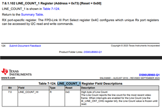

  2. I2C command checks:
    • Accessing address 0x4C returns 0x01, indicating that Port 0 is enabled.

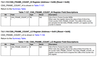

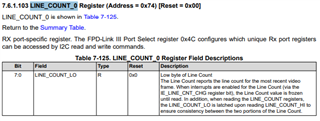

  3. Frame Counter Status Check:
    • Before enabling camera streaming:
      i2cget -y 6 0x3d 0x90 ==> 0x0c
      i2cget -y 6 0x3d 0x91 ==> 0xb5
    • After enabling camera streaming:
      i2cget -y 6 0x3d 0x90 ==> 0x03
      i2cget -y 6 0x3d 0x91 ==> 0xbb
      The above values correspond to the CSI-2 Port 0 Frame Counter registers. The change in these values before and after enabling camera streaming indicates that the frame counter is incrementing, which suggests that the camera is generating and transmitting frames to the DS90UB960Q1-EVM.

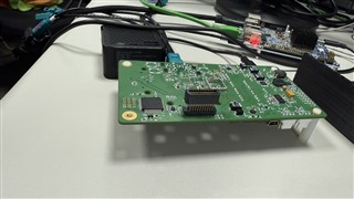

  4. Hardware Connection Setup:
    1. The MIPI-CSI interface from SK-TDA4VM is connected to the DS90UB960Q1-EVM.
    2. The camera module RCM-IMX390 is connected to the DS90UB960Q1-EVM via the connector marked with the number "1" as shown at below picture.

    When I boot up the system, setup_cameras.sh runs automatically, and the camera gets enumerated during the execution of this script.

  • Hi Kathy,
    You can check some of the registers of the deserializer. To see if they're reasonable/correct.
    • DEVICE_STS: Device status register provides read back access to high level link diagnostics.
    • LINE_COUNT_0 and LINE_COUNT_1: The Line Count reports the line count for the most recent video frame.
    Jared

    LINE_COUNT_0 (0x74) & LINE_COUNT_1 (0x73)
    root@tda4vm-sk:/opt/edgeai-gst-apps# i2cget -f -y 6 0x3d 0x73
    0x00
    root@tda4vm-sk:/opt/edgeai-gst-apps# i2cget -f -y 6 0x3d 0x74
    0x00
    It has been confirmed that no video data is received at this point.

    Jared,
    I had a call with this customer a few weeks ago.  We checked the same registers.  If the customer turns on the camera stream, then line count will increase at the deserializer, but no CSI reaches the j721e starter kit.
    I believe this is because the connector on the ub960 evm does not have the CSI lanes connected (from what I saw from the schematics online).  Can you confirm?
    Thanks!
  • Hi Stuart and Kathy,
    Thank you Stuart for pointing this out. The user guide has some details on the matter: https://www.ti.com/lit/ug/snlu226b/snlu226b.pdf
    Default behavior, the CSI outputs go to J1 and J3:
    • "Remove R7, R9, R11, R12, R15, R16, R17, R19, R21, R22, R25, R27, R31, R33, R35, R37, R40 and R42 for CSI-2 source connected to J1/J3 (Default)"

    Thank you for your reply. I think the problem should be here
    I would like to ask if there is any recommended connector? Because I saw QTH used for connection on the datasheet, but there are many types of models, so I came here to ask.
    Kathy
  • Hi Kathy,
    We use the QTH-020-01-L-D-DP-A-K connector on our Fusion 2 board: https://www.ti.com/tool/J7EXPA01EVM
    Jared
