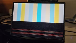

Using the am62a to light on the camera. Right now I can light on the Imx623 with config 1920*1536@60fps raw12 datatype.
But when i switch to other camera OV0X3C with  1920*1280@60fps raw12. Right now the video can not light.
to verify the problem i set the UB953 to let the 953 output with 1920*1280 raw colorbar. The Gsteramer can not work.
but when i using below script to turn on the application  here is the result:
media-ctl -V '"imx219 2-003c":0 [fmt:SRGGB12_1X12/1920x1536 field:none]'
media-ctl -V '"cdns_csi2rx.30101000.csi-bridge":0 [fmt:SRGGB12_1X12/1920x1536 field:none]'
media-ctl -V '"30102000.ticsi2rx":0 [fmt:SRGGB12_1X12/1920x1536 field:none]'
./bin/app_cms_imx219_1920_1280_raw12_Colorbar ./debug/imx219_cam_example_raw12_1920_1536.yaml
but due to the color is 1920*1280. the video show below: only half video is on the screen. that mean that the video can be send out correct. and the SOC setting not correct
can you help to analysis what the problem in Gsteramer and v4l2. Thanks very much

  • Hello Mr. Meng,
    Why did you use 1920x1536 for OV0X3C which has 1920x1280 resolution?
    I can using the v4l2 to read the video. but the streamer can not start. here is the log
    Were both captures running with OV0X3C? Did the captured raw images look correct?
    I have using gstreamer command to open the camera. below is the log
    Can you share the log of "media-ctl -p"?
    Thank you.
    Jianzhong
  • Hello Mr Xu Jianzhong:
    The streaming  coming from camera is the same  resolution 1920*1280 and i have using the color bar to instead of the ov0X3c video to avoid that the problem coming form sensor.
    the reason that i change the SOC v4l2 to 1920*1536 is that with  1920*1536 config of v4l2 i can light on the screen(even that the screen  with huge black area in the screen ). with the setting of  1920*1280. the gstreamer can not start.
