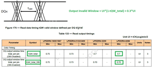

    The App Note SPRACN9 has design parameters for LPDDR4 eye mask. But I have concern on eye width requirement of 0.7*UI for data rate 4266MT/s.
    For Data read, as per JEDEC the Output Invalid window is 0.3*UI for LPDDR4 memory chip(below image FYR). The TDA4AL requires 0.7*UI eye width(TdIVW) which is not possible if we consider 0.3*UI invalid window for LPDDR4 memory DQ signals as PCB will also add some jitter. So, below are few queries please provide your feedback ASAP.
    1. Is this 0.7*UI eye width(TdIVW) requirement for TDA4AL is excluding DRAM memory Invalid Window of 0.3*UI ?
    2. If I need to include DRAM memory Invalid window(0.3*UI), then there should be some relaxation from 0.7*UI requirement for PCB. Could you please confirm ?
    Below are the screenshots from JEDEC specs & TDA4AL APP Note on above concerns.
    JEDEC spec:
    TDA4AL TdIVW requirement from APP NOTE:
    Hoysalachar N N

    My understanding is that you do not need to add 0.3 UI to the read mask.
    Kevin
