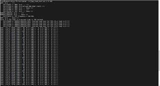

  • hi
    After our model was running, it seemed that the load on C7x was quite high. Could this be related to the cpsw_proxy_client issue?
    And is it related to the insufficient power supply? Because of the high power consumption of C7x..
    This should not be the case. The issue comes from the fact that there is no completion interrupt for cpsw tx packets which is causing the tx queue to lock up. I am trying to replicate this with EVM. So this could be a DMA issue.

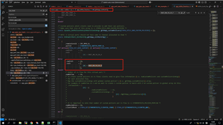

    We have found that changing numTxCh from 2 to 1 might increase the probability of timeout occurrence. You can give it a try.
  • hi
    In our program, both VPAC1 and VPAC2's MSCs are used simultaneously. We found that when we replaced the MSC node of VPAC2 with that of VPAC1, the problem disappeared.
    So it seems that the use of MSC with VPAC2 would cause this problem. What could be the possible reasons for this issue?Are there any differences between VPAC1 and VPAC2?
