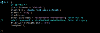

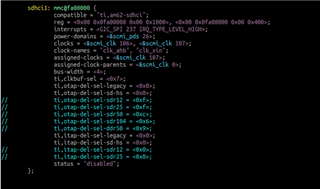

  • Hi  ,
    Thank you for your response.
    To confirm, you have validated your custom board setup on 11.00.05.02 - Yes
    This issue hass been solved and now i have completely booted the board.The issue was with the sdhci1 dts node. I have added one more extra property . But without this i was able to boot properly in the old release .What could be the reason for this and it only works with HS & legacy mode.
    And just to confirm  : I was able to see eMMC speed mode has been changed to HS200 , But the SD card is fails to boot in the default setup which is SDR104.This support is not added yet?
    It was because the UHS speed modes support was not there in the previous release. And so the SD card was being enumerated in HS mode only.
    This is possibly because of your custom board. The UHS modes require voltage switch mechanism from 3.3V to 1.8V which may not be there on your board. Please have a look at the following thread:

  • Hi ,
    Yes , I have tried the changes done over that thread and it is booting as expected (without voltage switching - SD HS Mode).But only thing when my custom board supports voltage switching and here by this configuration it seems to be not accepting the card. So what changes has to be done to support voltage switching and i'm currently using UHS Micro sd for booting purpose.

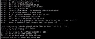

  • Hi ,
    The board hanging issue is not there anymore .But i have tried some testcases and the thing is it does not even once detect in SDR104 speed .I will share the log and dts changes i did. Please let me know where i should change my source so that i can detect micro sd card in SDR104 speed mode.
    Resetting board also fails due to this changes.

    DTS Changes for the updated-with-vmmc-supply : -
    &sdhci1 {
            /* SD/MMC */
            vmmc-supply = <&vdd_mmc1>;
            pinctrl-names = "default";
            pinctrl-0 = <&main_mmc1_pins_default>;
            status = "okay";
            disable-wp;
            bootph-all;
            vdd_mmc1: regulator-2 {
                    /* TPS22918DBVR */
                    bootph-all;
                    compatible = "regulator-fixed";
                    regulator-name = "vdd_mmc1";
                    regulator-min-microvolt = <3300000>;
                    regulator-max-microvolt = <3300000>;
                    regulator-boot-on;
                    enable-active-high;
                    vin-supply = <&vcc_3v3_sys>;
            vcc_3v3_sys: regulator-1 {
                    /* output of LM61460-Q1 */
                    regulator-name = "vcc_3v3_sys";
                    vin-supply = <&vmain_pd>;
                    regulator-always-on;
                    regulator-boot-on;
    DTS Changes for the updated without-vmmc-supply and in Old sdk.
    sdhci1 {
            /* SD/MMC */
    //      vmmc-supply = <&vdd_mmc1>;
            /delete-property/ ti,otap-del-sel-sdr12;
            /delete-property/ ti,otap-del-sel-sdr25;
            /delete-property/ ti,otap-del-sel-sdr50;
            /delete-property/ ti,otap-del-sel-sdr104;
            /delete-property/ ti,otap-del-sel-ddr50;
            /delete-property/ ti,itap-del-sel-sdr12;
            /delete-property/ ti,itap-del-sel-sdr25;
            status = "okay";
            disable-wp;
            bootph-all;

    The below attached is what i get when i dont comment the newly added properties in the sdhci1 node compared to the older release .What could be the reason for this issue?
    NOTICE:  bl1_plat_arch_setup arch setup
    NOTICE:  Booting Trusted Firmware
    NOTICE:  BL1: v2.12.0(release):11.00.15-dirty
    NOTICE:  BL1: Built : 05:53:30, Jun 27 2025
    NOTICE:  BL1: dram_class: 11
    NOTICE:  lpddr4: post start - PI training status=0x27c0a000
    NOTICE:  bl1_platform_setup DDR init done
    NOTICE:  k3_bl1_handoff ENTERING WFI - end of bl1
    NOTICE:  BL31: v2.12.0(release):11.00.15-dirty
    NOTICE:  BL31: Built : 05:53:32, Jun 27 2025
    NOTICE:  SYSFW ABI: 4.0 (firmware rev 0x000b '11.0.12-v11.00.12 (Fancy Rat)')
    ERROR:   Agent 0 Protocol 0x10 Message 0x7: not supported
    U-Boot SPL 2025.01-g1d6ba4a32cdd-dirty (Jun 30 2025 - 18:10:53 +0530)
    SPL initial stack usage: 1744 bytes
    Trying to boot from MMC2
    mmc@fa00000: No vmmc supply
    mmc@fa00000: No vqmmc supply
    selecting mode MMC legacy (freq : 0 MHz)
    Card did not respond to voltage select! : -110
    spl: mmc init failed with error: -95
    SPL: failed to boot from all boot devices
    ### ERROR ### Please RESET the board ###

    Are you referring to Uncomment this "with and without UHS modes enabled in the device tree"?
  • Otherwise, please apply the following patch and share the logs with and without UHS modes enabled in the device tree:
    I mean share the logs with HS and SDR104 mode respectively.

    I have made some changes and now whatever im able to  get in my evm board is same to that of my custom board (from u-boot to kernel voltage switching is working and getting detected in 200Mhz).
    Just to verify it once : In u-boot level Only mmc0 is suuported with 200Mhz and mmc1 with 50Mhz.
                                       In kernel : Both emmc and sd supports 200Mhz speed mode.
