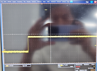

We use MCU_GPIO0_20 as example.
I think pinmux is ok.
we let gpio keep low in init state, and then trigger high (Raising edge), it trigger wakeup event even software setting Failing edge.
We can see that is no bounce problems.
And then, we let gpio keep HIGH in init state, and then trigger LOW (falling edge), it trigger wakeup event.
We can also see that is no bounce problems.

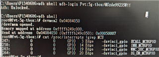

SW : 10.0, we set wakup source only in Linux side.
Do I miss any thing?

    This isn't the same case for GPIOs used for wakeup sources from low power modes. When the SoC is in Deep Sleep or MCU Only mode, the pad that is PinMuxed for a GPIO is searching for any change of the signal. This means from a hardware perspective, its not able to distinguish between a rising edge and falling edge, rather it only understands there is a signal change on the pad to cause a wakeup.
    Since the hardware cannot determine a rising edge or a falling edge, then it won't follow whats defined in the device tree overlay.
    The rising edge and falling edge device tree definition will apply for general GPIO interrupts but not wakeup events.
    Possible Solution
    It should be possible to connect a pull up resistor to the GPIO to keep the signal high. Then ground the signal for a moment to trigger the wakeup event.
    Alternatively, you could try with the internal PADCONFIG Pull resistor as well but be aware that this would be a weak resistor. This can be done by setting Bit 16 = 0 and Bit 17 = 1 (PADCONFIG = 0x60007) so the signal stays high in Deep Sleep, then ground the signal to wakeup the device.
    In either of these solutions, the signal will be high in Deep Sleep so it will ignore any rising edge signal changes and will only respond to falling edge signal changes.
