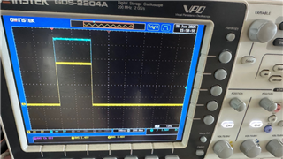

My usecase is to get acurate PPS out signal needed to sync other devices.
I've connected Meinberg grandmaster clock via PRP to PRU0 and PRU1 and the connection and redundancy works ok.
After successfully activating the PPS out using command "/root/ptp/testptp -d /dev/ptp2 -P 1" i've got pps signal which is shifted comparing to
the reference PPS from the master clock (as shown bellow; blue is gm pps, yellow is am64x pps).
Then I run ptp4l which after a while synchronizes the clock (ptp4l log bellow), but PPS signal generated by AM64x has still large offset comparing to reference gm pps.
Then when I turn it off and on again the pps out signal only comes close to the reference signal.

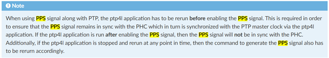

    Please note that the PPS signal from testptp can only be synchronized to ptp4l by ensuring that testptp runs after ptp4l is running. If ptp4l were ever to restart, you should also ensure that testptp restarts so that the PPS signal can be resynchronized to ptp4l. Please see the below
    https://software-dl.ti.com/processor-sdk-linux/esd/AM64X/latest/exports/docs/linux/Foundational_Components/Kernel/Kernel_Drivers/Network/CPSW-PTP.html
    Although the link I referenced is for CPSW ethernet, the same concept would apply to running PTP on PRU_ICSSG ethernet.

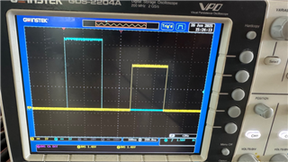

    The problem I described also occurs in another situation. According to the note, even if I first start the ptp4l (wait for synchronization) and then turn on the PPS output and in the next step disconnect the master clock for a long time (for example, 30 minutes), then the AM64x clock loses synchronization and thus the PPS output moves a lot away from the reference PPS pulse from the Grand Master Clock then after reconnecting the master clock to the AM64x the PPS output never synchronizes with the reference PPS as it did before disconnecting the master clock. It will be offset by a few milliseconds until the PPS output is turned off and on again using testptp.
    Maybe there is a solution (fix / improvement in the kernel drivers) to avoid this behavior and make ptp4l always able to synchronize the PPS output ?
    It's hard to detect from linux userspace if PPS is properly synchronized or not. Ptp4l shows that the master offset is a few nano seconds while the PPS output is offset by a few milliseconds.

    When the master clock is disconnected the ptp4l still works and looks for the master clock so according to the note stopping and starting again the PPS signal should not be required.

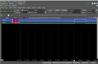

    I tried to replicate the particular case you described by setting up the following:
    Test topology:
    • AM64x EVM (Grandmaster clock) <---> AM64x EVM (Follower clock)
    • Both EVMs running Yocto built RT-Linux SDK 10.1 (this was what I had handy, it will take me some time to setup with the same Debian RT-Linux SDK 11.0)
    • Connected on eth2 (PRU-ICSSG) interfaces on both EVMs
    • Measure the PPS signal on the J18 header on both EVMs with a Logic Analyzer (did not have an oscilloscope handy with me)
    Test sequence:
    1. Start synchronization with ptp4l -P -2 -H -i eth2 -f gPTP.cfg --step_threshold=1 -m -q -p /dev/ptp2 where the contents of the gPTP.cfg file is specified in the below code snippet.
    2. Wait for synchronization to complete
    3. Turn on PPS output with /usr/kernel-selftest/ptp/testptp -d /dev/ptp2 -P 1
    4. Disconnect the cable and wait for 30 minutes
    5. Reconnect the cable and observe the PPS offset

    However I was unable to see the milisecond level PPS offset you mentioned. I captured this similarly with a wait time of about 10 minutes after cable disconnection see my ptp4l logs and PPS capture from my logic analyzer.

  • Hi Daolin,
    To accurately reproduce the case I described, you would have to use a “real” grand master clock to have a reference PPS ouput signal and reference source of time synchronization.
    My tests shows that if I disconnect the masterclock (I used a Meinberg Lantime M600 or Hyperion400 for testing) from the PRU-ICSSG eth interface for a long time (it's hard to say exactly how long), then the PPS output will shift relative to the reference PPS output from the master clock. There is an offset threshold (I can't determine the exact value) and if it is exceeded then the ptp4l is not able to synchronize the pps output with the AM64x
    However, I've asked if there is a chance to get PPS signal dynamically adjusted to the PTP clock correction without having to restart PPS. As a disclaimer, it might take some time get some feedback as the developer is working on some other high priority activities this week.
    That would be the best solution. Then the information provided by ptp4l regarding synchronization accuracy would be correlated with the PPS output.
    The PPS output from my board using AM64x was to synchronize multiple slave modules, which must be precisely synchronized with the reference PPS signal. Under AM64x linux user space I am not able to confirm 100% that the PPS signal coming out of the board is synchronized with the PPS output from the master clock, which disqualifies its use in an industrial solution, it can only be used for testing purposes.
    From my understanding, the most accurate way to measure PPS synchronization accuracy is to measure the actual PPS signal with an oscilloscope and compare the PPS signals of each device/modules in your network. I'm not aware of a specific way from linux user space to measure PPS synchronization accuracy across all connected devices. The ptp4l synchronization logs should in theory be a reflection of the PPS synchronization but the most accurate way to check would still be using an oscilloscope.
