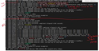

    We need more information about what you are testing. Here are the details I was able to figure out so far:
    Anshu told me that you were running tests with this Linux script:
    while true; do echo mem > /sys/power/state; done;
    Based on that input, I assume that the terminal output you showed is broken into several wakeup / suspend cycles, like this:
    We can verify from the output "fifo 1 has unexpected unread messages" that the M4F is the one who did not read the mailbox message during #2 in the above image (i.e., not Linux).
    In case anyone wants to double-check the thought process on how we can verify what "fifo 1" means, I'll attach the relevent code snippets.

    Based on the terminal timestamps of 7897 seconds, I assume that you had many successful low power mode entries and exits before you hit an error.
    QUESTION 1: Is it true that you had multiple successful low power mode cycles before running into an issue?
    One potential issue is that you could have a race condition between Linux and the M4F core.
    There is only 3 milliseconds between receiving the ECHO_REPLY mailbox from the M4F, and starting the next suspend. Perhaps Linux is sending the next low power mode signal to the M4F before the M4F has finished changing state back from "low power mode" to "system running", and that is causing an issue.
    TEST 1: Add a short delay in the Linux test script
    If Linux waits for a half second or a second before it starts the next low power mode, what happens? Does the crash behavior go away?
    If yes, then you have a race condition.

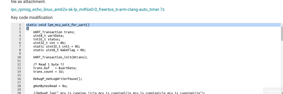

    Key code modification
    static void lpm_mcu_wait_for_uart()
        UART_Transaction trans;
        uint8_t uartData;
        int32_t status;
        uint32_t cnt = 0U;
        static uint32_t cnt1 = 0U;
        static uint8_t WakeFlag = 0U;
        UART_Transaction_init(&trans);
        /* Read 1 byte */
        trans.buf   = &uartData;
        trans.count = 1U;
        DebugP_memLogWriterPause();
        gNumBytesRead = 0u;
    	//DebugP_log(" mcu is running !\r\n mcu is running\r\n mcu is running\r\n mcu is running\r\n");
    	vTaskDelay(1000);
    	SOC_triggerMcuLpmWakeup();
    	SemaphoreP_pend(&gLpmResumeSem, SystemP_WAIT_FOREVER);
    	cnt1++;
    	DebugP_log("wake soc success,cnt = %u\r\n",cnt1);
    #if 0
        while(1)
    		if(cnt < 0x7FFFF)
                cnt++;
    		else
    			cnt1++;
    			DebugP_log("cnt = %u\r\n",cnt1);
    			cnt = 0U;
    			if (cnt1 == 5)
    				cnt1 = 0U;
    				break;
        	// mcu透过api唤醒soc code
            if(cnt < 0x7FFFFF)
                cnt++;
    		else
    			cnt1++;
    			break;
        /* Wait for any key to be pressed */
        status = UART_read(gUartHandle[CONFIG_UART0], &trans);
        DebugP_assert(status == SystemP_SUCCESS);
        while (gNumBytesRead == 0u && gbSuspended == 1u)
        if (gNumBytesRead != 0)
            DebugP_log("[IPC RPMSG ECHO] Key pressed. Notifying DM to wakeup main domain\r\n");
            /* Wait for resuming the main domain */
            DebugP_log("[IPC RPMSG ECHO] Main domain resumed due to MCU UART \r\n");
        else if (gbSuspended == 0u)
            UART_readCancel(gUartHandle[CONFIG_UART0], &trans);
            DebugP_log("[IPC RPMSG ECHO] Main domain resumed from a different wakeup source \r\n");
    #endif
        DebugP_memLogWriterResume();

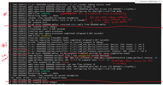

    [   74.934434] PM: suspend entry (deep)
    [   74.940791] Filesystems sync: 0.002 seconds
    [   74.962326] Freezing user space processes
    [   74.968598] Freezing user space processes completed (elapsed 0.002 seconds)
    [   74.975654] OOM killer disabled.
    [   74.978887] Freezing remaining freezable tasks
    [   74.984862] Freezing remaining freezable tasks completed (elapsed 0.001 seconds)
    [   74.992274] printk: Suspending console(s) (use no_console_suspend to debug)
    --> 57ms
    [   75.008295] ti-sci 44043000.system-controller: ti_sci_cmd_set_device_constraint: device: 179: state: 1: ret 0
    [   75.008486] ti-sci 44043000.system-controller: ti_sci_cmd_set_device_constraint: device: 178: state: 1: ret 0
    [   75.016090] omap8250 2800000.serial: PM domain pd:146 will not be powered off
    [   75.016769] ti-sci 44043000.system-controller: ti_sci_cmd_set_device_constraint: device: 117: state: 1: ret 0
    [   75.016961] ti-sci 44043000.system-controller: ti_sci_cmd_set_latency_constraint: latency: 100: state: 1: ret 0
    [   75.040593] Disabling non-boot CPUs ...
    [   75.043143] psci: CPU1 killed (polled 0 ms)
    [   75.047649] psci: CPU2 killed (polled 0 ms)
    [   75.051339] psci: CPU3 killed (polled 0 ms)
    [   75.053039] Enabling non-boot CPUs ...
    [   75.053478] Detected VIPT I-cache on CPU1
    [   75.053534] GICv3: CPU1: found redistributor 1 region 0:0x00000000018a0000
    [   75.053603] CPU1: Booted secondary processor 0x0000000001 [0x410fd034]
    [   75.054937] CPU1 is up
    [   75.055238] Detected VIPT I-cache on CPU2
    [   75.055274] GICv3: CPU2: found redistributor 2 region 0:0x00000000018c0000
    [   75.055323] CPU2: Booted secondary processor 0x0000000002 [0x410fd034]
    [   75.056354] CPU2 is up
    [   75.056650] Detected VIPT I-cache on CPU3
    [   75.056686] GICv3: CPU3: found redistributor 3 region 0:0x00000000018e0000
    [   75.056738] CPU3: Booted secondary processor 0x0000000003 [0x410fd034]
    [   75.057784] CPU3 is up
    [   75.058442] ti-sci 44043000.system-controller: ti_sci_resume: wakeup source: 0x90
    [   75.075295] am65-cpsw-nuss 8000000.ethernet: set new flow-id-base 19
    [   75.084626] am65-cpsw-nuss 8000000.ethernet eth0: PHY [8000f00.mdio:00] driver [TI DP83867] (irq=POLL)
    [   75.084650] am65-cpsw-nuss 8000000.ethernet eth0: configuring for phy/rgmii-rxid link mode
    [   75.249195] OOM killer enabled.
    [   75.252343] Restarting tasks ... done.
    [   75.258819] random: crng reseeded on system resumption
    [   75.266115] k3-m4-rproc 5000000.m4fss: Core is on in resume
    [   75.271949] k3-m4-rproc 5000000.m4fss: received echo reply from 5000000.m4fss
    [   75.285786] PM: suspend exit
    -->277ms

  • Hi, Anshu & Nick
    Replies as below.
    Q1/A1 : Is it true that you had multiple successful low power mode cycles before running into an issue?
    Yes, so far, we have two round testig. 4k times suceess has one faild, and 9k times suceess has one failed.
    so try to avoid race condition potential issues, I ask cutomer add some delay (~1 sec) in code before MCU trigger A53 wakeup.

    2) thank you for sharing test code
    Comments based on the code posted on June 27:
    https://e2e.ti.com/support/processors-group/processors/f/processors-forum/1532839/am620-q1-ipc-crash-in-resume-from-mcu-only-mode/5896055#5896055
    a) the system might not work as expected if something else wakes up the processor other than the M4F core (since the code to handle that usecase has been commented out)
    b) The code is still calling UART_Transaction_init. I think this should be ok, since it seems like the function is just initializing the UART transaction structure and not actually starting anything running like UART_read https://software-dl.ti.com/mcu-plus-sdk/esd/AM62X/10_01_00_33/exports/docs/api_guide_am62x/group__DRV__UART__MODULE.html#ga07908a73787a9ef3e8356c51524b8c44
