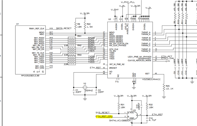

I am using a costume board with Am3352. I am using KSZ9031RNX for the PHY. I tried everything to get the link up(verify the reset, put delay , remove computability line, check the device tree).
Still get this msg:

root@tux-yocto:~# dmesg |grep phy -i
[ 0.000000] Booting Linux on physical CPU 0x0
[ 3.509888] Micrel KSZ9031 Gigabit PHY: probe of 4a101000.mdio:00 failed with error -5
[ 3.510021] davinci_mdio 4a101000.mdio: phy[0]: device 4a101000.mdio:00, driver Micrel KSZ9031 Gigabit PHY
[ 3.536199] am335x-phy-driver 47401300.usb-phy: supply vcc not found, using dummy regulator
[ 3.536668] am335x-phy-driver 47401300.usb-phy: dummy supplies not allowed for exclusive requests
[ 3.555418] am335x-phy-driver 47401b00.usb-phy: supply vcc not found, using dummy regulator
[ 3.555830] am335x-phy-driver 47401b00.usb-phy: dummy supplies not allowed for exclusive requests
[ 24.059712] Generic PHY 4a101000.mdio:00: attached PHY driver (mii_bus:phy_addr=4a101000.mdio:00, irq=POLL)

My device tree:
My circuit:
Any idea??
