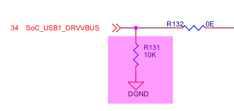

Hi Walter, Gibbs,
The ROM configures a watchdog timer for the system. The TIFS will pet the watchdog timer periodically. If the watchdog timer expires after 3 minutes without a pet, then SoC will reset itself. When this occurs, it could possibly indicate that the TIFS has crashed at somepoint.
This mechanism will exist when the SoC is in any state.
What we noticed is when we have a USB A device connected to the TI EVM, then attempt to suspend, it will run into this behavior.
We fixed this on the SK-AM62-LP board by removing the pull down resistor to keep the USB1_DRVVBUS signal high:
After removing this pull down resistor in the SK-AM62-LP board, we are able to suspend and resume without any issues.

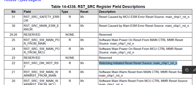

Hi, Anshu
I think there is no relationship with USB device A, because there is no USB device on EVM.
Because we use this function (SOC_triggerMcuLpmWakeup()) trigger A53 (Linux) wake up cycling & repeat without any real GPIO trigger, it still happen.
each cycle around ~ 10 sec.
vTaskDelay(1000); SOC_triggerMcuLpmWakeup(); SemaphoreP_pend(&gLpmResumeSem, SystemP_WAIT_FOREVER);
The only thing that we know, TIFS should be crash, so it caused watchdog reset.
Do we have any mechanism or log to track this issue?
What's the reason caused watchdog reset?

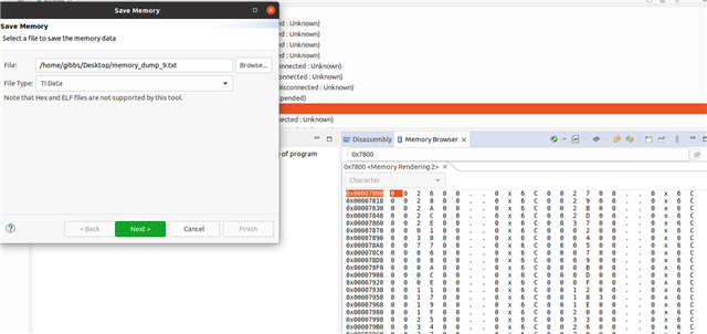

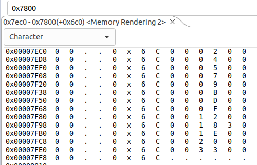

Hi, Anshu
Short update,
(1) I already dump SYSFW trace, I can see "DEVICE_OFF()" or "DEVICE_ON()" from PM, but I can not see "PM_LPM_SEQ()" in log, Do I miss anyrthing?
download linl as below.
https://tidrive.ext.ti.com/u/q9QPGX7UD3e51A8W/d5afe620-f0a2-435b-85ae-29e000db95fb?l
password : 1x7|twFz
(2) Before system is going to reboot, I found PM try to Power ON/OFF GPU (AM62X_DEV_GPU0) many times repeatly, but our device is AM620_Q1.
I am not sure this is normal case.

(1) How to check DM R5 (sysfw) reset ?
sysfw = dm + pm
If sysfw reboot, it will show some boot string like "Sciserver", example like below.
Search key word "Sciserver" to label (find) rebot time slot in log.
gibbs@gibbs-HP-ZBook-15-G5:~/work/am62_lp/ti-processor-sdk-linux-am62xx-evm-10.01.10.04/bin$ grep Sciserver am62x_deepsleep_9.1_0716.txt Sciserver Testapp Built On: Nov 14 2024 14:00:38 Sciserver Version: v2024.11.0.0-REL.MCUSDK.K3.10.01.00.10+ Starting Sciserver..... PASSED
(2) What's happen before board reboot?
I believe root cause "should be" sysfw R5 reset first, and then it caused (board) system reboot
I try to capture two log file, both of them have reboot issue, and I saw both of them seem have similar failed pattern, capture as below.
Follow what I observated, when AM62 start to go to MCU LPM, it will try to power off MMCSD1 first, so it should be an landmark w/ LPM starting procedure in log file.
DEVICE_OFF(Device has been Turned OFF): Device ID: 58
0x6180030E: Power Management: MSG_RECEIVED(TI-SCI message received): Message ID: 0x0000030E 0x61800200: Power Management: MSG_RECEIVED(TI-SCI message received): Message ID: 0x00000200 0x61C0003A: Power Management: MSG_PARAM_DEV_CLK_ID(TI-SCI message content: dev/clk-ids): Device ID: 58 Clock ID: 0 0x62000000: Power Management: MSG_PARAM_VAL(TI-SCI message content: value): Target Value: 0x00000000 0x6040003A: Power Management: DEVICE_OFF(Device has been Turned OFF): Device ID: 58 0x63D2A001: Power Management: MODULE_PUT(Module Put): PSC ID: 1 LPSC ID: 21 Module Use Count: 1 0x63D4402A: Power Management: MODULE_PUT(Module Put): PSC ID: 1 LPSC ID: 34 Module Use Count: 42 0x60C000B9: Power Management: CLOCK_DISABLE(Clock has been Turned OFF): Clock ID: 185 0x60C00088: Power Management: CLOCK_DISABLE(Clock has been Turned OFF): Clock ID: 136 0x6452A001: Power Management: RETENTION_PUT(Retention Put): PSC ID: 1 LPSC ID: 21 Module Retention Count: 1 0x6310005F: Power Management: PD_PUT(Power Domain Put): PSC ID: 1 Power domain ID: 0 PD Usage Count: 95 0x6454402A: Power Management: RETENTION_PUT(Retention Put): PSC ID: 1 LPSC ID: 34 Module Retention Count: 42 0x6310005E: Power Management: PD_PUT(Power Domain Put): PSC ID: 1 Power domain ID: 0 PD Usage Count: 94 0x61800200: Power Management: MSG_RECEIVED(TI-SCI message received): Message ID: 0x00000200 0x61C0004E: Power Management: MSG_PARAM_DEV_CLK_ID(TI-SCI message content: dev/clk-ids): Device ID: 78 Clock ID: 0 0x62000000: Power Management: MSG_PARAM_VAL(TI-SCI message content: value): Target Value: 0x00000000 0x6040004E: Power Management: DEVICE_OFF(Device has been Turned OFF): Device ID: 78 0x63D00015: Power Management: MODULE_PUT(Module Put): PSC ID: 1 LPSC ID: 0 Module Use Count: 21 0x64500014: Power Management: RETENTION_PUT(Retention Put): PSC ID: 1 LPSC ID: 0 Module Retention Count: 20 0x6310005D: Power Management: PD_PUT(Power Domain Put): PSC ID: 1 Power domain ID: 0 PD Usage Count: 93 0x61800200: Power Management: MSG_RECEIVED(TI-SCI message received): Message ID: 0x00000200 0x61C0004D: Power Management: MSG_PARAM_DEV_CLK_ID(TI-SCI message content: dev/clk-ids): Device ID: 77 Clock ID: 0 0x62000000: Power Management: MSG_PARAM_VAL(TI-SCI message content: value): Target Value: 0x00000000 0x6040004D: Power Management: DEVICE_OFF(Device has been Turned OFF): Device ID: 77 0x63D00014: Power Management: MODULE_PUT(Module Put): PSC ID: 1 LPSC ID: 0 Module Use Count: 20 0x64500013: Power Management: RETENTION_PUT(Retention Put): PSC ID: 1 LPSC ID: 0 Module Retention Count: 19 0x6310005C: Power Management: PD_PUT(Power Domain Put): PSC ID: 1 Power domain ID: 0 PD Usage Count: 92 0x61800200: Power Management: MSG_RECEIVED(TI-SCI message received): Message ID: 0x00000200 0x61C00039: Power Management: MSG_PARAM_DEV_CLK_ID(TI-SCI message content: dev/clk-ids): Device ID: 57 Clock ID: 0 0x62000000: Power Management: MSG_PARAM_VAL(TI-SCI message content: value): Target Value: 0x00000000 0x60400039: Power Management: DEVICE_OFF(Device has been Turned OFF): Device ID: 57 0x63D28001: Power Management: MODULE_PUT(Module Put): PSC ID: 1 LPSC ID: 20 Module Use Count: 1 0x63D44029: Power Management: MODULE_PUT(Module Put): PSC ID: 1 LPSC ID: 34 Module Use Count: 41 0x60C000B8: Power Management: CLOCK_DISABLE(Clock has been Turned OFF): Clock ID: 184 0x60C00087: Power Management: CLOCK_DISABLE(Clock has been Turned OFF): Clock ID: 135 0x64528001: Power Management: RETENTION_PUT(Retention Put): PSC ID: 1 LPSC ID: 20 Module Retention Count: 1 0x6310005B: Power Management: PD_PUT(Power Domain Put): PSC ID: 1 Power domain ID: 0 PD Usage Count: 91 0x64544029: Power Management: RETENTION_PUT(Retention Put): PSC ID: 1 LPSC ID: 34 Module Retention Count: 41 0x6310005A: Power Management: PD_PUT(Power Domain Put): PSC ID: 1 Power domain ID: 0 PD Usage Count: 90 0x61800200: Power Management: MSG_RECEIVED(TI-SCI message received): Message ID: 0x00000200 0x61C000B3: Power Management: MSG_PARAM_DEV_CLK_ID(TI-SCI message content: dev/clk-ids): Device ID: 179 Clock ID: 0 0x62000000: Power Management: MSG_PARAM_VAL(TI-SCI message content: value): Target Value: 0x00000000 0x604000B3: Power Management: DEVICE_OFF(Device has been Turned OFF): Device ID: 179 0x63D1A001: Power Management: MODULE_PUT(Module Put): PSC ID: 1 LPSC ID: 13 Module Use Count: 1 0x6451A001: Power Management: RETENTION_PUT(Retention Put): PSC ID: 1 LPSC ID: 13 Module Retention Count: 1 0x63100059: Power Management: PD_PUT(Power Domain Put): PSC ID: 1 Power domain ID: 0 PD Usage Count: 89 0x61800200: Power Management: MSG_RECEIVED(TI-SCI message received): Message ID: 0x00000200 0x61C000B2: Power Management: MSG_PARAM_DEV_CLK_ID(TI-SCI message content: dev/clk-ids): Device ID: 178 Clock ID: 0 0x62000000: Power Management: MSG_PARAM_VAL(TI-SCI message content: value): Target Value: 0x00000000 0x604000B2: Power Management: DEVICE_OFF(Device has been Turned OFF): Device ID: 178 0x63D18001: Power Management: MODULE_PUT(Module Put): PSC ID: 1 LPSC ID: 12 Module Use Count: 1 0x64518001: Power Management: RETENTION_PUT(Retention Put): PSC ID: 1 LPSC ID: 12 Module Retention Count: 1 0x63100058: Power Management: PD_PUT(Power Domain Put): PSC ID: 1 Power domain ID: 0 PD Usage Count: 88 0x61800200: Power Management: MSG_RECEIVED(TI-SCI message received): Message ID: 0x00000200 0x61C0000D: Power Management: MSG_PARAM_DEV_CLK_ID(TI-SCI message content: dev/clk-ids): Device ID: 13 Clock ID: 0 0x62000000: Power Management: MSG_PARAM_VAL(TI-SCI message content: value): Target Value: 0x00000000 0x6040000D: Power Management: DEVICE_OFF(Device has been Turned OFF): Device ID: 13 0x63D52001: Power Management: MODULE_PUT(Module Put): PSC ID: 1 LPSC ID: 41 Module Use Count: 1 0x63D44028: Power Management: MODULE_PUT(Module Put): PSC ID: 1 LPSC ID: 34 Module Use Count: 40 0x60C000B6: Power Management: CLOCK_DISABLE(Clock has been Turned OFF): Clock ID: 182 0x60C00037: Power Management: CLOCK_DISABLE(Clock has been Turned OFF): Clock ID: 55 0x60C00036: Power Management: CLOCK_DISABLE(Clock has been Turned OFF): Clock ID: 54 0x64552001: Power Management: RETENTION_PUT(Retention Put): PSC ID: 1 LPSC ID: 41 Module Retention Count: 1 0x63104002: Power Management: PD_PUT(Power Domain Put): PSC ID: 1 Power domain ID: 2 PD Usage Count: 2 0x64544028: Power Management: RETENTION_PUT(Retention Put): PSC ID: 1 LPSC ID: 34 Module Retention Count: 40 0x63104001: Power Management: PD_PUT(Power Domain Put): PSC ID: 1 Power domain ID: 2 PD Usage Count: 1 0x63100057: Power Management: PD_PUT(Power Domain Put): PSC ID: 1 Power domain ID: 0 PD Usage Count: 87 0x61800200: Power Management: MSG_RECEIVED(TI-SCI message received): Message ID: 0x00000200 0x61C0004B: Power Management: MSG_PARAM_DEV_CLK_ID(TI-SCI message content: dev/clk-ids): Device ID: 75 Clock ID: 0 0x62000000: Power Management: MSG_PARAM_VAL(TI-SCI message content: value): Target Value: 0x00000000 0x6040004B: Power Management: DEVICE_OFF(Device has been Turned OFF): Device ID: 75 0x63D38002: Power Management: MODULE_PUT(Module Put): PSC ID: 1 LPSC ID: 28 Module Use Count: 2 0x60C000C0: Power Management: CLOCK_DISABLE(Clock has been Turned OFF): Clock ID: 192 0x60C0008A: Power Management: CLOCK_DISABLE(Clock has been Turned OFF): Clock ID: 138 0x64538002: Power Management: RETENTION_PUT(Retention Put): PSC ID: 1 LPSC ID: 28 Module Retention Count: 2 0x63100056: Power Management: PD_PUT(Power Domain Put): PSC ID: 1 Power domain ID: 0 PD Usage Count: 86 0x61800200: Power Management: MSG_RECEIVED(TI-SCI message received): Message ID: 0x00000200 0x61C00092: Power Management: MSG_PARAM_DEV_CLK_ID(TI-SCI message content: dev/clk-ids): Device ID: 146 Clock ID: 0 0x62000000: Power Management: MSG_PARAM_VAL(TI-SCI message content: value): Target Value: 0x00000000 0x60400092: Power Management: DEVICE_OFF(Device has been Turned OFF): Device ID: 146 0x63D44027: Power Management: MODULE_PUT(Module Put): PSC ID: 1 LPSC ID: 34 Module Use Count: 39 0x60C000D9: Power Management: CLOCK_DISABLE(Clock has been Turned OFF): Clock ID: 217 0x60C000CF: Power Management: CLOCK_DISABLE(Clock has been Turned OFF): Clock ID: 207 0x64544027: Power Management: RETENTION_PUT(Retention Put): PSC ID: 1 LPSC ID: 34 Module Retention Count: 39 0x63100055: Power Management: PD_PUT(Power Domain Put): PSC ID: 1 Power domain ID: 0 PD Usage Count: 85 0x61800200: Power Management: MSG_RECEIVED(TI-SCI message received): Message ID: 0x00000200 0x61C000BA: Power Management: MSG_PARAM_DEV_CLK_ID(TI-SCI message content: dev/clk-ids): Device ID: 186 Clock ID: 0 0x62000000: Power Management: MSG_PARAM_VAL(TI-SCI message content: value): Target Value: 0x00000000 0x604000BA: Power Management: DEVICE_OFF(Device has been Turned OFF): Device ID: 186 0x63D66001: Power Management: MODULE_PUT(Module Put): PSC ID: 1 LPSC ID: 51 Module Use Count: 1 0x63D44026: Power Management: MODULE_PUT(Module Put): PSC ID: 1 LPSC ID: 34 Module Use Count: 38 0x60C000B7: Power Management: CLOCK_DISABLE(Clock has been Turned OFF): Clock ID: 183 0x64566001: Power Management: RETENTION_PUT(Retention Put): PSC ID: 1 LPSC ID: 51 Module Retention Count: 1 0x63112002: Power Management: PD_PUT(Power Domain Put): PSC ID: 1 Power domain ID: 9 PD Usage Count: 2 0x64544026: Power Management: RETENTION_PUT(Retention Put): PSC ID: 1 LPSC ID: 34 Module Retention Count: 38 0x63112001: Power Management: PD_PUT(Power Domain Put): PSC ID: 1 Power domain ID: 9 PD Usage Count: 1 0x63100054: Power Management: PD_PUT(Power Domain Put): PSC ID: 1 Power domain ID: 0 PD Usage Count: 84 0x61800200: Power Management: MSG_RECEIVED(TI-SCI message received): Message ID: 0x00000200 0x61C00068: Power Management: MSG_PARAM_DEV_CLK_ID(TI-SCI message content: dev/clk-ids): Device ID: 104 Clock ID: 0 0x62000000: Power Management: MSG_PARAM_VAL(TI-SCI message content: value): Target Value: 0x00000000 0x60400068: Power Management: DEVICE_OFF(Device has been Turned OFF): Device ID: 104 0x63D44025: Power Management: MODULE_PUT(Module Put): PSC ID: 1 LPSC ID: 34 Module Use Count: 37 0x64544025: Power Management: RETENTION_PUT(Retention Put): PSC ID: 1 LPSC ID: 34 Module Retention Count: 37 0x63100053: Power Management: PD_PUT(Power Domain Put): PSC ID: 1 Power domain ID: 0 PD Usage Count: 83 0x61800200: Power Management: MSG_RECEIVED(TI-SCI message received): Message ID: 0x00000200 0x61C00067: Power Management: MSG_PARAM_DEV_CLK_ID(TI-SCI message content: dev/clk-ids): Device ID: 103 Clock ID: 0 0x62000000: Power Management: MSG_PARAM_VAL(TI-SCI message content: value): Target Value: 0x00000000 0x60400067: Power Management: DEVICE_OFF(Device has been Turned OFF): Device ID: 103 0x63D44024: Power Management: MODULE_PUT(Module Put): PSC ID: 1 LPSC ID: 34 Module Use Count: 36 0x64544024: Power Management: RETENTION_PUT(Retention Put): PSC ID: 1 LPSC ID: 34 Module Retention Count: 36 0x63100052: Power Management: PD_PUT(Power Domain Put): PSC ID: 1 Power domain ID: 0 PD Usage Count: 82 0x61800200: Power Management: MSG_RECEIVED(TI-SCI message received): Message ID: 0x00000200 0x61C00066: Power Management: MSG_PARAM_DEV_CLK_ID(TI-SCI message content: dev/clk-ids): Device ID: 102 Clock ID: 0 0x62000000: Power Management: MSG_PARAM_VAL(TI-SCI message content: value): Target Value: 0x00000000 0x60400066: Power Management: DEVICE_OFF(Device has been Turned OFF): Device ID: 102 0x63D44023: Power Management: MODULE_PUT(Module Put): PSC ID: 1 LPSC ID: 34 Module Use Count: 35 0x64544023: Power Management: RETENTION_PUT(Retention Put): PSC ID: 1 LPSC ID: 34 Module Retention Count: 35 0x63100051: Power Management: PD_PUT(Power Domain Put): PSC ID: 1 Power domain ID: 0 PD Usage Count: 81 0x61800200: Power Management: MSG_RECEIVED(TI-SCI message received): Message ID: 0x00000200 0x61C00075: Power Management: MSG_PARAM_DEV_CLK_ID(TI-SCI message content: dev/clk-ids): Device ID: 117 Clock ID: 0 0x62000000: Power Management: MSG_PARAM_VAL(TI-SCI message content: value): Target Value: 0x00000000 0x60400075: Power Management: DEVICE_OFF(Device has been Turned OFF): Device ID: 117 0x63D00013: Power Management: MODULE_PUT(Module Put): PSC ID: 1 LPSC ID: 0 Module Use Count: 19 0x60C000FB: Power Management: CLOCK_DISABLE(Clock has been Turned OFF): Clock ID: 251 0x64500012: Power Management: RETENTION_PUT(Retention Put): PSC ID: 1 LPSC ID: 0 Module Retention Count: 18 0x63100050: Power Management: PD_PUT(Power Domain Put): PSC ID: 1 Power domain ID: 0 PD Usage Count: 80 0x61800200: Power Management: MSG_RECEIVED(TI-SCI message received): Message ID: 0x00000200 0x61C00077: Power Management: MSG_PARAM_DEV_CLK_ID(TI-SCI message content: dev/clk-ids): Device ID: 119 Clock ID: 0 0x62000000: Power Management: MSG_PARAM_VAL(TI-SCI message content: value): Target Value: 0x00000000 0x60400077: Power Management: DEVICE_OFF(Device has been Turned OFF): Device ID: 119 0x61800200: Power Management: MSG_RECEIVED(TI-SCI message received): Message ID: 0x00000200 0x61C0005F: Power Management: MSG_PARAM_DEV_CLK_ID(TI-SCI message content: dev/clk-ids): Device ID: 95 Clock ID: 0 0x62000000: Power Management: MSG_PARAM_VAL(TI-SCI message content: value): Target Value: 0x00000000 0x6040005F: Power Management: DEVICE_OFF(Device has been Turned OFF): Device ID: 95 0x63D00012: Power Management: MODULE_PUT(Module Put): PSC ID: 1 LPSC ID: 0 Module Use Count: 18 0x64500011: Power Management: RETENTION_PUT(Retention Put): PSC ID: 1 LPSC ID: 0 Module Retention Count: 17 0x6310004F: Power Management: PD_PUT(Power Domain Put): PSC ID: 1 Power domain ID: 0 PD Usage Count: 79 0x61800307: Power Management: MSG_RECEIVED(TI-SCI message received): Message ID: 0x00000307 Sciserver Testapp Built On: Nov 14 2024 14:00:38 Sciserver Version: v2024.11.0.0-REL.MCUSDK.K3.10.01.00.10+ RM_PM_HAL Version: v10.01.08 Starting Sciserver..... PASSED
We found :
(1) I guess device off "AM62X_DEV_WKUP_VTM0" should be the "final step" when swaps INTO MCU LPM
(2) AM62 should be already in MCU LPM succefssful, but failed to wakeup. it caused sysfw reset.
(2) sysfw reset happens when R5 gets message ID 0x00000307, what's mean this TISCI message ID?

(1) Why do you not see the label for "PM_LPM_SEQ"?
Because you need to dump it from CCS w/ JTAG
a) Follow FAQ, select memory dump format.
b) check START & END address, 0x7800~0x7FF8
c) Dump test file as below,
0 x 6 C 0 0 2 7 0 0 . . 0 x 6 C 0 0 2 8 0 0 . . 0 x 6 C 0 0 2 9 0 0 . . 0 x 6 C 0 0 2 A 0 0 . . 0 x 6 C 0 0 2 B 0 0 . . 0 x 6 C 0 0 2 C 0 0 . . 0 x 6 C 0 0 2 D 0 0 . . 0 x 6 C 0 0 2 E 0 0 . . 0 x 6 C 0 0 3 7 0 0 . . 0 x 6 C 0 0 0 1 0 0 . . 0 x 6 C 0 0 0 2 0 0 . . 0 x 6 C 0 0 3 8 0 0 . . 0 x 6 C 0 0 0 4 0 0 . . 0 x 6 C 0 0 7 7 0 0 . . 0 x 6 C 0 0 0 5 0 0 . . 0 x 6 C 0 0 0 6 0 0 . . 0 x 6 C 0 0 0 7 0 0 . . 0 x 6 C 0 0 0 8 0 0 . . 0 x 6 C 0 0 0 9 0 0 . . 0 x 6 C 0 0 0 A 0 0 . . 0 x 6 C 0 0 0 B 0 0 . . 0 x 6 C 0 0 0 C 0 0 . . 0 x 6 C 0 0 0 D 0 0 . . 0 x 6 C 0 0 0 E 0 0 . . 0 x 6 C 0 0 0 F 0 0 . . 0 x 6 C 0 0 1 1 0 0 . . 0 x 6 C 0 0 1 2 0 0 . . 0 x 6 C 0 0 1 7 0 0 . . 0 x 6 C 0 0 1 8 3 0 . . 0 x 6 C 0 0 1 9 0 0 . . 0 x 6 C 0 0 1 E 0 0 . . 0 x 6 C 0 0 1 F 0 0 . . 0 x 6 C 0 0 2 0 0 0 . . 0 x 6 C 0 0 2 5 0 0 . . 0 x 6 C 0 0 3 3 0 0 . . 0 x 6 C 0 0 3 4 0 0 . . 0 x 6 C 0 0 2 6 0 0 . . 0 x 6 C 0 0 2 7 0 0 . . 0 x 6 C 0 0 2 8 0 0 . . 0 x 6 C 0 0 2 9 0 0 . . 0 x 6 C 0 0 2 A 0 0 . . 0 x 6 C 0 0 2 B 0 0 . . 0 x 6 C 0 0 2 C 0 0 . . 0 x 6 C 0 0 2 D 0 0 . . 0 x 6 C 0 0 2 E 0 0 . . 0 x 6 C 0 0 3 7 0 0 . . 0 x 6 C 0 0 0 1 0 0 . . 0 x 6 C 0 0 0 2 0 0 . . 0 x 6 C 0 0 3 8 0 0 . . 0 x 6 C 0 0 0 4 0 0 . . 0 x 6 C 0 0 7 7 0 0 . . 0 x 6 C 0 0 0 5 0 0 . . 0 x 6 C 0 0 0 6 0 0 . . 0 x 6 C 0 0 0 7 0 0 . . 0 x 6 C 0 0 0 8 0 0 . . 0 x 6 C 0 0 0 9 0 0 . . 0 x 6 C 0 0 0 A 0 0 . . 0 x 6 C 0 0 0 B 0 0 . . 0 x 6 C 0 0 0 C 0 0 . . 0 x 6 C 0 0 0 D 0 0 . . 0 x 6 C 0 0 0 E 0 0 . . 0 x 6 C 0 0 0 F 0 0 . . 0 x 6 C 0 0 1 1 0 0 . . 0 x 6 C 0 0 1 2 0 0 . . 0 x 6 C 0 0 1 7 0 0 . . 0 x 6 C 0 0 1 8 3 0 . . 0 x 6 C 0 0 1 9 0 0 . . 0 x 6 C 0 0 1 E 0 0 . . 0 x 6 C 0 0 1 F 0 0 . . 0 x 6 C 0 0 2 0 0 0 . . 0 x 6 C 0 0 2 5 0 0 . . 0 x 6 C 0 0 3 3 0 0 . . 0 x 6 C 0 0 3 4 0 0 . . 0 x 6 C 0 0 2 6 0 0 . . 0 x 6 C 0 0 2 7 0 0 . . 0 x 6 C 0 0 2 8 0 0 . . 0 x 6 C 0 0 2 9 0 0 . . 0 x 6 C 0 0 2 A 0 0 . . 0 x 6 C 0 0 2 B 0 0 . . 0 x 6 C 0 0 2 C 0 0 . . 0 x 6 C 0 0 2 D 0 0 . . 0 x 6 C 0 0 2 E 0 0 . . 0 x 6 C 0 0 3 7 0 0 . . 0 x 6 C 0 0 0 1 0 0 . . 0 x 6 C 0 0 0 2 0 0 . . 0 x 6 C 0 0 3 8 0 0 . . 0 x 6 C 0 0 0 4 0 0 . . 0 x 6 C 0 0 7 7 0 0 . . 0 x 6 C 0 0 0 5 0 0 . . 0 x 6 C 0 0 0 6 0 0 . . 0 x 6 C 0 0 0 7 0 0 . . 0 x 6 C 0 0 0 8 0 0 . . 0 x 6 C 0 0 0 9 0 0 . . 0 x 6 C 0 0 0 A 0 0 . . 0 x 6 C 0 0 0 B 0 0 . . 0 x 6 C 0 0 0 C 0 0 . . 0 x 6 C 0 0 0 D 0 0 . . 0 x 6 C 0 0 0 E 0 0 . . 0 x 6 C 0 0 0 F 0 0 . . 0 x 6 C 0 0 1 1 0 0 . . 0 x 6 C 0 0 1 2 0 0 . . 0 x 6 C 0 0 1 7 0 0 . . 0 x 6 C 0 0 1 8 3 0 . . 0 x 6 C 0 0 1 9 0 0 . . 0 x 6 C 0 0 1 E 0 0 . . 0 x 6 C 0 0 1 F 0 0 . . 0 x 6 C 0 0 2 0 0 0 . . 0 x 6 C 0 0 2 5 0 0 . . 0 x 6 C 0 0 3 3 0 0 . . 0 x 6 C 0 0 3 4 0 0 . . 0 x 6 C 0 0 2 6 0 0 . . 0 x 6 C 0 0 2 7 0 0 . . 0 x 6 C 0 0 2 8 0 0 . . 0 x 6 C 0 0 2 9 0 0 . . 0 x 6 C 0 0 2 A 0 0 . . 0 x 6 C 0 0 2 B 0 0 . . 0 x 6 C 0 0 2 C 0 0 . . 0 x 6 C 0 0 2 D 0 0 . . 0 x 6 C 0 0 2 E 0 0 . . 0 x 6 C 0 0 3 7 0 0 . . 0 0 0 E 0 0 . . 0 x 6 C 0 0 0 F 0 0 . . 0 x 6 C 0 0 1 1 0 0 . . 0 x 6 C 0 0 1 2 0 0 . . 0 x 6 C 0 0 1 7 0 0 . . 0 x 6 C 0 0 1 8 9 0 . . 0 x 6 C 0 0 1 9 0 0 . . 0 x 6 C 0 0 1 E 0 0 . . 0 x 6 C 0 0 1 F 0 0 . . 0 x 6 C 0 0 2 0 0 0 . . 0 x 6 C 0 0 2 5 0 0 . . 0 x 6 C 0 0 3 3 0 0 . . 0 x 6 C 0 0 3 4 0 0 . . 0 x 6 C 0 0 2 6 0 0 . . 0 x 6 C 0 0 2 7 0 0 . . 0 x 6 C 0 0 2 8 0 0 . . 0 x 6 C 0 0 2 9 0 0 . . 0 x 6 C 0 0 2 A 0 0 . . 0 x 6 C 0 0 2 B 0 0 . . 0 x 6 C 0 0 2 C 0 0 . . 0 x 6 C 0 0 2 D 0 0 . . 0 x 6 C 0 0 2 E 0 0 . . 0 x 6 C 0 0 3 7 0 0 . . 0 x 6 C 0 0 0 1 0 0 . . 0 x 6 C 0 0 0 2 0 0 . . 0 x 6 C 0 0 3 8 0 0 . . 0 x 6 C 0 0 0 4 0 0 . . 0 x 6 C 0 0 7 7 0 0 . . 0 x 6 C 0 0 0 5 0 0 . . 0 x 6 C 0 0 0 6 0 0 . . 0 x 6 C 0 0 0 7 0 0 . . 0 x 6 C 0 0 0 8 0 0 . . 0 x 6 C 0 0 0 9 0 0 . . 0 x 6 C 0 0 0 A 0 0 . . 0 x 6 C 0 0 0 B 0 0 . . 0 x 6 C 0 0 0 C 0 0 . . 0 x 6 C 0 0 0 D 0 0 . . 0 x 6 C 0 0 0 E 0 0 . . 0 x 6 C 0 0 0 F 0 0 . . 0 x 6 C 0 0 1 1 0 0 . . 0 x 6 C 0 0 1 2 0 0 . . 0 x 6 C 0 0 1 7 0 0 . . 0 x 6 C 0 0 1 8 3 0 . . 0 x 6 C 0 0 1 9 0 0 . . 0 x 6 C 0 0 1 E 0 0 . . 0 x 6 C 0 0 1 F 0 0 . . 0 x 6 C 0 0 2 0 0 0 . . 0 x 6 C 0 0 2 5 0 0 . . 0 x 6 C 0 0 3 3 0 0 . . 0 x 6 C 0 0 3 4

Configuring trace data version to: 0x03007 0x6C002700: Power Management: PM_LPM_SEQ(Low power mode sequence): Received continue resume Value: 0 0x6C002800: Power Management: PM_LPM_SEQ(Low power mode sequence): Disabled main IO isolation Value: 0 0x6C002900: Power Management: PM_LPM_SEQ(Low power mode sequence): Enabled remaining PLL Value: 0 0x6C002A00: Power Management: PM_LPM_SEQ(Low power mode sequence): Removed DDR reset isolation Value: 0 0x6C002B00: Power Management: PM_LPM_SEQ(Low power mode sequence): Exited DDR self reset Value: 0 0x6C002C00: Power Management: PM_LPM_SEQ(Low power mode sequence): Disabled USB reset isolation Value: 0 0x6C002D00: Power Management: PM_LPM_SEQ(Low power mode sequence): Sent continue resume to TFS Value: 0 0x6C002E00: Power Management: PM_LPM_SEQ(Low power mode sequence): Received sync resume message Value: 0 0x6C003700: Power Management: PM_LPM_SEQ(Low power mode sequence): Unload CAN magic words in MMR Value: 0 0x6C000100: Power Management: PM_LPM_SEQ(Low power mode sequence): DM stub started Value: 0 0x6C000200: Power Management: PM_LPM_SEQ(Low power mode sequence): Unlocked MMRs Value: 0 0x6C003800: Power Management: PM_LPM_SEQ(Low power mode sequence): Load CAN magic words in MMR Value: 0 0x6C000400: Power Management: PM_LPM_SEQ(Low power mode sequence): DDR in reset isolation Value: 0 0x6C007700: Power Management: PM_LPM_SEQ(Low power mode sequence): Unknown Sub Message: 0x77 Value: 0 0x6C000500: Power Management: PM_LPM_SEQ(Low power mode sequence): Enabled USB reset isolation Value: 0 0x6C000600: Power Management: PM_LPM_SEQ(Low power mode sequence): Disabled main LPSC Value: 0 0x6C000700: Power Management: PM_LPM_SEQ(Low power mode sequence): Bypassed main PLL Value: 0 0x6C000800: Power Management: PM_LPM_SEQ(Low power mode sequence): Configured wake-up sources Value: 0 0x6C000900: Power Management: PM_LPM_SEQ(Low power mode sequence): Enabled Main IO isolation Value: 0 0x6C000A00: Power Management: PM_LPM_SEQ(Low power mode sequence): Disabled second set of main LPSC Value: 0 0x6C000B00: Power Management: PM_LPM_SEQ(Low power mode sequence): Switched from MAIN PLL to MCU PLL Value: 0 0x6C000C00: Power Management: PM_LPM_SEQ(Low power mode sequence): Configured clock muxes Value: 0 0x6C000D00: Power Management: PM_LPM_SEQ(Low power mode sequence): Disabled Main PLL Value: 0 0x6C000E00: Power Management: PM_LPM_SEQ(Low power mode sequence): Enabled DM reset mask Value: 0 0x6C000F00: Power Management: PM_LPM_SEQ(Low power mode sequence): Kept main domain in reset Value: 0 0x6C001100: Power Management: PM_LPM_SEQ(Low power mode sequence): Masked main domain reset Value: 0 0x6C001200: Power Management: PM_LPM_SEQ(Low power mode sequence): Gated WWD clock Value: 0 0x6C001700: Power Management: PM_LPM_SEQ(Low power mode sequence): DM in WFI Value: 0 0x6C001830: Power Management: PM_LPM_SEQ(Low power mode sequence): LPM wake event Value: 48 0x6C001900: Power Management: PM_LPM_SEQ(Low power mode sequence): DM exited WFI Value: 0 0x6C001E00: Power Management: PM_LPM_SEQ(Low power mode sequence): unmasked WWD clock Value: 0 0x6C001F00: Power Management: PM_LPM_SEQ(Low power mode sequence): Disabling MCU IO isolation Value: 0 0x6C002000: Power Management: PM_LPM_SEQ(Low power mode sequence): Wrote stub magic word Value: 0 0x6C002500: Power Management: PM_LPM_SEQ(Low power mode sequence): TIFS core is ready Value: 0 0x6C003300: Power Management: PM_LPM_SEQ(Low power mode sequence): Removed DM reset mask Value: 0 0x6C003400: Power Management: PM_LPM_SEQ(Low power mode sequence): Removed main domain reset isolation Value: 0 0x6C002600: Power Management: PM_LPM_SEQ(Low power mode sequence): Loaded FS stub Value: 0 0x6C002700: Power Management: PM_LPM_SEQ(Low power mode sequence): Received continue resume Value: 0 0x6C002800: Power Management: PM_LPM_SEQ(Low power mode sequence): Disabled main IO isolation Value: 0 0x6C002900: Power Management: PM_LPM_SEQ(Low power mode sequence): Enabled remaining PLL Value: 0 0x6C002A00: Power Management: PM_LPM_SEQ(Low power mode sequence): Removed DDR reset isolation Value: 0 0x6C002B00: Power Management: PM_LPM_SEQ(Low power mode sequence): Exited DDR self reset Value: 0 0x6C002C00: Power Management: PM_LPM_SEQ(Low power mode sequence): Disabled USB reset isolation Value: 0 0x6C002D00: Power Management: PM_LPM_SEQ(Low power mode sequence): Sent continue resume to TFS Value: 0 0x6C002E00: Power Management: PM_LPM_SEQ(Low power mode sequence): Received sync resume message Value: 0 0x6C003700: Power Management: PM_LPM_SEQ(Low power mode sequence): Unload CAN magic words in MMR Value: 0 0x6C000100: Power Management: PM_LPM_SEQ(Low power mode sequence): DM stub started Value: 0 0x6C000200: Power Management: PM_LPM_SEQ(Low power mode sequence): Unlocked MMRs Value: 0 0x6C003800: Power Management: PM_LPM_SEQ(Low power mode sequence): Load CAN magic words in MMR Value: 0 0x6C000400: Power Management: PM_LPM_SEQ(Low power mode sequence): DDR in reset isolation Value: 0 0x6C007700: Power Management: PM_LPM_SEQ(Low power mode sequence): Unknown Sub Message: 0x77 Value: 0 0x6C000500: Power Management: PM_LPM_SEQ(Low power mode sequence): Enabled USB reset isolation Value: 0 0x6C000600: Power Management: PM_LPM_SEQ(Low power mode sequence): Disabled main LPSC Value: 0 0x6C000700: Power Management: PM_LPM_SEQ(Low power mode sequence): Bypassed main PLL Value: 0 0x6C000800: Power Management: PM_LPM_SEQ(Low power mode sequence): Configured wake-up sources Value: 0 0x6C000900: Power Management: PM_LPM_SEQ(Low power mode sequence): Enabled Main IO isolation Value: 0 0x6C000A00: Power Management: PM_LPM_SEQ(Low power mode sequence): Disabled second set of main LPSC Value: 0 0x6C000B00: Power Management: PM_LPM_SEQ(Low power mode sequence): Switched from MAIN PLL to MCU PLL Value: 0 0x6C000C00: Power Management: PM_LPM_SEQ(Low power mode sequence): Configured clock muxes Value: 0 0x6C000D00: Power Management: PM_LPM_SEQ(Low power mode sequence): Disabled Main PLL Value: 0 0x6C000E00: Power Management: PM_LPM_SEQ(Low power mode sequence): Enabled DM reset mask Value: 0 0x6C000F00: Power Management: PM_LPM_SEQ(Low power mode sequence): Kept main domain in reset Value: 0 0x6C001100: Power Management: PM_LPM_SEQ(Low power mode sequence): Masked main domain reset Value: 0 0x6C001200: Power Management: PM_LPM_SEQ(Low power mode sequence): Gated WWD clock Value: 0 0x6C001700: Power Management: PM_LPM_SEQ(Low power mode sequence): DM in WFI Value: 0 0x6C001830: Power Management: PM_LPM_SEQ(Low power mode sequence): LPM wake event Value: 48 0x6C001900: Power Management: PM_LPM_SEQ(Low power mode sequence): DM exited WFI Value: 0 0x6C001E00: Power Management: PM_LPM_SEQ(Low power mode sequence): unmasked WWD clock Value: 0 0x6C001F00: Power Management: PM_LPM_SEQ(Low power mode sequence): Disabling MCU IO isolation Value: 0 0x6C002000: Power Management: PM_LPM_SEQ(Low power mode sequence): Wrote stub magic word Value: 0 0x6C002500: Power Management: PM_LPM_SEQ(Low power mode sequence): TIFS core is ready Value: 0 0x6C003300: Power Management: PM_LPM_SEQ(Low power mode sequence): Removed DM reset mask Value: 0 0x6C003400: Power Management: PM_LPM_SEQ(Low power mode sequence): Removed main domain reset isolation Value: 0 0x6C002600: Power Management: PM_LPM_SEQ(Low power mode sequence): Loaded FS stub Value: 0 0x6C002700: Power Management: PM_LPM_SEQ(Low power mode sequence): Received continue resume Value: 0 0x6C002800: Power Management: PM_LPM_SEQ(Low power mode sequence): Disabled main IO isolation Value: 0 0x6C002900: Power Management: PM_LPM_SEQ(Low power mode sequence): Enabled remaining PLL Value: 0 0x6C002A00: Power Management: PM_LPM_SEQ(Low power mode sequence): Removed DDR reset isolation Value: 0 0x6C002B00: Power Management: PM_LPM_SEQ(Low power mode sequence): Exited DDR self reset Value: 0 0x6C002C00: Power Management: PM_LPM_SEQ(Low power mode sequence): Disabled USB reset isolation Value: 0 0x6C002D00: Power Management: PM_LPM_SEQ(Low power mode sequence): Sent continue resume to TFS Value: 0 0x6C002E00: Power Management: PM_LPM_SEQ(Low power mode sequence): Received sync resume message Value: 0 0x6C003700: Power Management: PM_LPM_SEQ(Low power mode sequence): Unload CAN magic words in MMR Value: 0 0x6C000100: Power Management: PM_LPM_SEQ(Low power mode sequence): DM stub started Value: 0 0x6C000200: Power Management: PM_LPM_SEQ(Low power mode sequence): Unlocked MMRs Value: 0 0x6C003800: Power Management: PM_LPM_SEQ(Low power mode sequence): Load CAN magic words in MMR Value: 0 0x6C000400: Power Management: PM_LPM_SEQ(Low power mode sequence): DDR in reset isolation Value: 0 0x6C007700: Power Management: PM_LPM_SEQ(Low power mode sequence): Unknown Sub Message: 0x77 Value: 0 0x6C000500: Power Management: PM_LPM_SEQ(Low power mode sequence): Enabled USB reset isolation Value: 0 0x6C000600: Power Management: PM_LPM_SEQ(Low power mode sequence): Disabled main LPSC Value: 0 0x6C000700: Power Management: PM_LPM_SEQ(Low power mode sequence): Bypassed main PLL Value: 0 0x6C000800: Power Management: PM_LPM_SEQ(Low power mode sequence): Configured wake-up sources Value: 0 0x6C000900: Power Management: PM_LPM_SEQ(Low power mode sequence): Enabled Main IO isolation Value: 0 0x6C000A00: Power Management: PM_LPM_SEQ(Low power mode sequence): Disabled second set of main LPSC Value: 0 0x6C000B00: Power Management: PM_LPM_SEQ(Low power mode sequence): Switched from MAIN PLL to MCU PLL Value: 0 0x6C000C00: Power Management: PM_LPM_SEQ(Low power mode sequence): Configured clock muxes Value: 0 0x6C000D00: Power Management: PM_LPM_SEQ(Low power mode sequence): Disabled Main PLL Value: 0 0x6C000E00: Power Management: PM_LPM_SEQ(Low power mode sequence): Enabled DM reset mask Value: 0 0x6C000F00: Power Management: PM_LPM_SEQ(Low power mode sequence): Kept main domain in reset Value: 0 0x6C001100: Power Management: PM_LPM_SEQ(Low power mode sequence): Masked main domain reset Value: 0 0x6C001200: Power Management: PM_LPM_SEQ(Low power mode sequence): Gated WWD clock Value: 0 0x6C001700: Power Management: PM_LPM_SEQ(Low power mode sequence): DM in WFI Value: 0 0x6C001830: Power Management: PM_LPM_SEQ(Low power mode sequence): LPM wake event Value: 48 0x6C001900: Power Management: PM_LPM_SEQ(Low power mode sequence): DM exited WFI Value: 0 0x6C001E00: Power Management: PM_LPM_SEQ(Low power mode sequence): unmasked WWD clock Value: 0 0x6C001F00: Power Management: PM_LPM_SEQ(Low power mode sequence): Disabling MCU IO isolation Value: 0 0x6C002000: Power Management: PM_LPM_SEQ(Low power mode sequence): Wrote stub magic word Value: 0 0x6C002500: Power Management: PM_LPM_SEQ(Low power mode sequence): TIFS core is ready Value: 0 0x6C003300: Power Management: PM_LPM_SEQ(Low power mode sequence): Removed DM reset mask Value: 0 0x6C003400: Power Management: PM_LPM_SEQ(Low power mode sequence): Removed main domain reset isolation Value: 0 0x6C002600: Power Management: PM_LPM_SEQ(Low power mode sequence): Loaded FS stub Value: 0 0x6C002700: Power Management: PM_LPM_SEQ(Low power mode sequence): Received continue resume Value: 0 0x6C002800: Power Management: PM_LPM_SEQ(Low power mode sequence): Disabled main IO isolation Value: 0 0x6C002900: Power Management: PM_LPM_SEQ(Low power mode sequence): Enabled remaining PLL Value: 0 0x6C002A00: Power Management: PM_LPM_SEQ(Low power mode sequence): Removed DDR reset isolation Value: 0 0x6C002B00: Power Management: PM_LPM_SEQ(Low power mode sequence): Exited DDR self reset Value: 0 0x6C002C00: Power Management: PM_LPM_SEQ(Low power mode sequence): Disabled USB reset isolation Value: 0 0x6C002D00: Power Management: PM_LPM_SEQ(Low power mode sequence): Sent continue resume to TFS Value: 0 0x6C002E00: Power Management: PM_LPM_SEQ(Low power mode sequence): Received sync resume message Value: 0 0x6C003700: Power Management: PM_LPM_SEQ(Low power mode sequence): Unload CAN magic words in MMR Value: 0 0x6C000F00: Power Management: PM_LPM_SEQ(Low power mode sequence): Kept main domain in reset Value: 0 0x6C001100: Power Management: PM_LPM_SEQ(Low power mode sequence): Masked main domain reset Value: 0 0x6C001200: Power Management: PM_LPM_SEQ(Low power mode sequence): Gated WWD clock Value: 0 0x6C001700: Power Management: PM_LPM_SEQ(Low power mode sequence): DM in WFI Value: 0 0x6C001890: Power Management: PM_LPM_SEQ(Low power mode sequence): LPM wake event Value: 144 0x6C001900: Power Management: PM_LPM_SEQ(Low power mode sequence): DM exited WFI Value: 0 0x6C001E00: Power Management: PM_LPM_SEQ(Low power mode sequence): unmasked WWD clock Value: 0 0x6C001F00: Power Management: PM_LPM_SEQ(Low power mode sequence): Disabling MCU IO isolation Value: 0 0x6C002000: Power Management: PM_LPM_SEQ(Low power mode sequence): Wrote stub magic word Value: 0 0x6C002500: Power Management: PM_LPM_SEQ(Low power mode sequence): TIFS core is ready Value: 0 0x6C003300: Power Management: PM_LPM_SEQ(Low power mode sequence): Removed DM reset mask Value: 0 0x6C003400: Power Management: PM_LPM_SEQ(Low power mode sequence): Removed main domain reset isolation Value: 0 0x6C002600: Power Management: PM_LPM_SEQ(Low power mode sequence): Loaded FS stub Value: 0 0x6C002700: Power Management: PM_LPM_SEQ(Low power mode sequence): Received continue resume Value: 0 0x6C002800: Power Management: PM_LPM_SEQ(Low power mode sequence): Disabled main IO isolation Value: 0 0x6C002900: Power Management: PM_LPM_SEQ(Low power mode sequence): Enabled remaining PLL Value: 0 0x6C002A00: Power Management: PM_LPM_SEQ(Low power mode sequence): Removed DDR reset isolation Value: 0 0x6C002B00: Power Management: PM_LPM_SEQ(Low power mode sequence): Exited DDR self reset Value: 0 0x6C002C00: Power Management: PM_LPM_SEQ(Low power mode sequence): Disabled USB reset isolation Value: 0 0x6C002D00: Power Management: PM_LPM_SEQ(Low power mode sequence): Sent continue resume to TFS Value: 0 0x6C002E00: Power Management: PM_LPM_SEQ(Low power mode sequence): Received sync resume message Value: 0 0x6C003700: Power Management: PM_LPM_SEQ(Low power mode sequence): Unload CAN magic words in MMR Value: 0 0x6C000100: Power Management: PM_LPM_SEQ(Low power mode sequence): DM stub started Value: 0 0x6C000200: Power Management: PM_LPM_SEQ(Low power mode sequence): Unlocked MMRs Value: 0 0x6C003800: Power Management: PM_LPM_SEQ(Low power mode sequence): Load CAN magic words in MMR Value: 0 0x6C000400: Power Management: PM_LPM_SEQ(Low power mode sequence): DDR in reset isolation Value: 0 0x6C007700: Power Management: PM_LPM_SEQ(Low power mode sequence): Unknown Sub Message: 0x77 Value: 0 0x6C000500: Power Management: PM_LPM_SEQ(Low power mode sequence): Enabled USB reset isolation Value: 0 0x6C000600: Power Management: PM_LPM_SEQ(Low power mode sequence): Disabled main LPSC Value: 0 0x6C000700: Power Management: PM_LPM_SEQ(Low power mode sequence): Bypassed main PLL Value: 0 0x6C000800: Power Management: PM_LPM_SEQ(Low power mode sequence): Configured wake-up sources Value: 0 0x6C000900: Power Management: PM_LPM_SEQ(Low power mode sequence): Enabled Main IO isolation Value: 0 0x6C000A00: Power Management: PM_LPM_SEQ(Low power mode sequence): Disabled second set of main LPSC Value: 0 0x6C000B00: Power Management: PM_LPM_SEQ(Low power mode sequence): Switched from MAIN PLL to MCU PLL Value: 0 0x6C000C00: Power Management: PM_LPM_SEQ(Low power mode sequence): Configured clock muxes Value: 0 0x6C000D00: Power Management: PM_LPM_SEQ(Low power mode sequence): Disabled Main PLL Value: 0 0x6C000E00: Power Management: PM_LPM_SEQ(Low power mode sequence): Enabled DM reset mask Value: 0 0x6C000F00: Power Management: PM_LPM_SEQ(Low power mode sequence): Kept main domain in reset Value: 0 0x6C001100: Power Management: PM_LPM_SEQ(Low power mode sequence): Masked main domain reset Value: 0 0x6C001200: Power Management: PM_LPM_SEQ(Low power mode sequence): Gated WWD clock Value: 0 0x6C001700: Power Management: PM_LPM_SEQ(Low power mode sequence): DM in WFI Value: 0 0x6C001830: Power Management: PM_LPM_SEQ(Low power mode sequence): LPM wake event Value: 48 0x6C001900: Power Management: PM_LPM_SEQ(Low power mode sequence): DM exited WFI Value: 0 0x6C001E00: Power Management: PM_LPM_SEQ(Low power mode sequence): unmasked WWD clock Value: 0 0x6C001F00: Power Management: PM_LPM_SEQ(Low power mode sequence): Disabling MCU IO isolation Value: 0 0x6C002000: Power Management: PM_LPM_SEQ(Low power mode sequence): Wrote stub magic word Value: 0 0x6C002500: Power Management: PM_LPM_SEQ(Low power mode sequence): TIFS core is ready Value: 0 0x6C003300: Power Management: PM_LPM_SEQ(Low power mode sequence): Removed DM reset mask Value: 0 0x006C0034: BasePort: TISCI_MSG_RECEIVED(TISCI Message interrupt handled): Queue ID: 44 Message ID: 34
