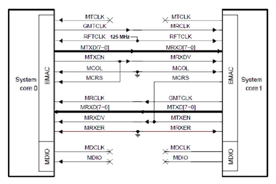

What is the best way to interface the AM389x to another processor via Gigabit Ethernet? The other processor has GMII interface, can the 2 be connected directly via GMII to GMII? Or must there be Phys in between?

    Thanks, I guess the real question is, if we are connecting the Gig E to another processor can you connect the GMII ports of each processor together? or do you need to go from
    GMII to PHY --- then to the PHY to GMII of the next processor? These are both on the same board, so this is not going off board or across cards..Not sure if this is possible.. or would work.

    Thanks for the additional details - I was thinking that the connection would be outside of your system.  In this case GMII can be cross connected (without using PHYs):
    • TXD goes to RXD
    • TXEN goes to RXDV
    • RXER is tied low
    • COLL is tied low
    • CRS is tied low
    • Need to run in gig mode fullduplex

  • Hi Marc,
    1) What about GMTCLK, RXCLK and TXCLK signals?
    2) Could CRS be shorted to TXEN or it has to be tied LOW? I found TI's datasheet about direct connections in the document "Inter-DM6467 Communications Using Direct GMII Connections".

  • Can you help resolve these questions:
    1)      Is the phy in the new AM389x equivalent to that used in the DM6467?
    2)      What are the details for using the EMACs for MCU to MCU Communication?
    3)      Does EMAC_CRS get tied to GND or does it tie to the same MCUs RXDV?

    Please see attached diagram
