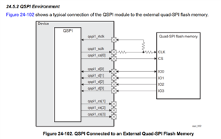

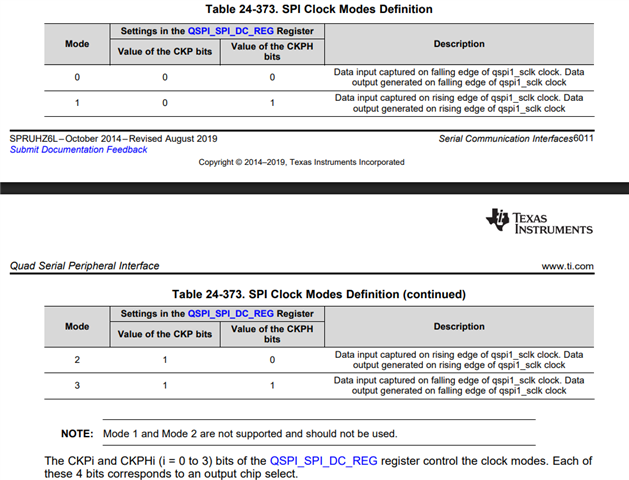

customer configure OSPI as normal SPI, but mode 0 and mode 3, the clock is different,
following is the QSPI diagram,
the description is:

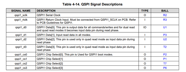

why mode 0 need to connect qspi1_rtclk, and mode 3 doesn't need?
in SOC how qspi1_rtclk and qspi1_sclk works?
