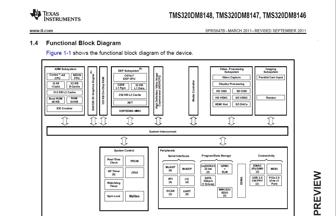

Based on the below diagram and the DSP/EDMA, it looks like the DSP has access to the Serial Ports and USB. But it is not entirely clear that this is the case.
Can you confirm whether or not  the DSP can access the serial ports and the USB through the EDMA MMU.

    More information about the interconnect operation on the device is available in Chapter 5 of the datasheet. Table 5-1 (Page 171) indicates the connection via the L3 bus (for USB connectivity) and Table 5-2 (Page 172) indicates this for the L4 bus (for Serial connectivity). For these peripehals connections exsits between:
    USB - C674x SDMA, C674x CFG
    UART - DSP/EDMA MMU (DEMMU), C674x CFG

    I'm still looking for a code example for the DEMMU, but the best place to start is the System MMU chapter (chapter 1.4) of the TRM (http://www.ti.com/litv/pdf/sprugz8):
    The method for setting up the MMU can be found in section 1.4.4, "MMU Low-Level Programming Models". The fastest way to enable the MMU is to setup a static TLB (the process gets more complicate if you enable  table walking in the MMU), as described in Table 1-49, "MMU Writing TLB Entries Statically". Following this process will enable you to map the appropriate memory to contral external devices via the DSP.
    I'll provide an update if I can find a code example (I assume you want a high level Linux implementation), but the static implementation from the TRM will certainly work.
