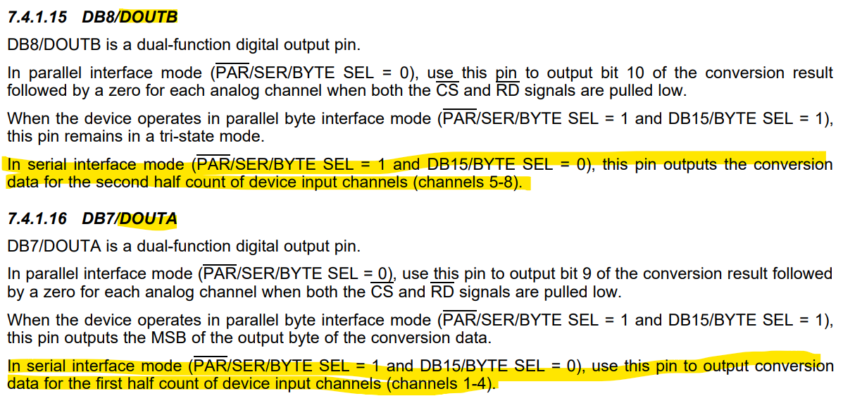

ADS8598S: Is it possible to connect AM62x and ADS8598S via SPI using DOUTA and DOUTB?
Are there any materials or sample codes explaining how to connect?
    I'm not an ADSxxx device expert but according to the device datasheet this should be possible if you use the "serial interface mode". The AM62x would need to operate in SPI master mode it seems, connecting to the CLK, CS, and DOUTA lines. Doing so would give you 4 channels. If you need all 8 channels it looks like this could be done by usinging a second AM62x SPI peripheral module, but operating that one in SPI slave mode (not master), connected to DOUTB. And use the same CLK signal from the SPI master mode peripheral to keep in sync.

    Since a ReceiveOnly connection seems impossible, are the following two patterns correct?
    Yes this won't work, D0 and D1 of the same SPI peripheral can't both be operated in input mode at the same time.
    But what you could do is to first switch D0 to input to read channels 1-4, and then later switch D1 to input to read channels 5-8. If you want to do that you can tell the SPI peripheral whether to use D0 or D1 as an input signal through the 'IS' control bit. And just keep both transmit enable bits for both data lines (DPE0, DPE1) set to 0 to avoid any signal contention.

    ・Communication time will be longer, but use either DOUTA or DOUTB.
    I think as per ADS8598 datasheet DOUTA is tied to specific ADC channels (1-4), and so is DOUTB (channels 5-8). So it is not about longer communication time, but being limited to accessing specific channels, depending on whether you connect DOUTA or DOUTB.
