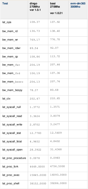

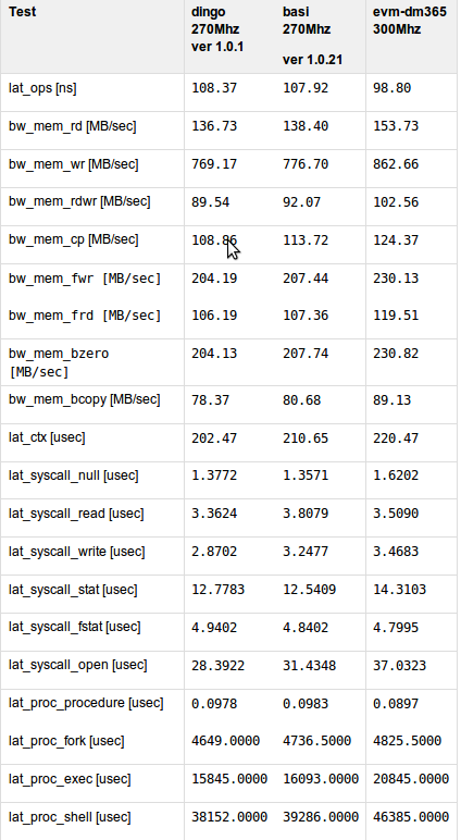

I had some problems with many processes running on my  board and so I have done some measurements like the
http://e2e.ti.com/support/embedded/linux/f/354/t/93186.aspx
post.
I have found similar poor performances (lat_ctx for example, but also other numbers).
I have based my comparison on http://www.ptxdist.org/development/kernel/arm-benchmarks-20100729_en.html .
dingo # opkg install /lmbench_3.0-a9-r4.6_armv5te.ipk
dm365 at 270Mhz and  112MB of free RAM.
The comparison table lacks by now evm-dm365, as I have some problems to bring up again, but I will do.
Any suggestion to enhance the performances?
