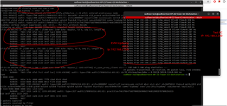

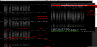

    I have tested on my side using TI SDK as is with the default configuration.
    The SDK used to test the ETHFW client networking is as captured below.
    Connected the Test PC network cable to EVM via CPSW Port-2 (Switch port interface).  Please find the ping log from the virtual switch port interface (eth1) to the test PC below.
    The default port mapping of QSGMII is as follows.
    https://software-dl.ti.com/jacinto7/esd/processor-sdk-rtos-j784s4/latest/exports/docs/ethfw/docs/user_guide/ethfw_c_ug_top.html#ethfw_depend_evm_quadport_j7200
    Tested MAC Port-1, via virtual MAC only port interface on Linux to test PC. Please refer to the ping log below.
    Sudheer
