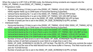

If we look into the processors reference manual (SPRUJ28E) we found the following:
VBP -> vertical field blanking no 2 for odd field
VFP -> vertical field blanking no 1 for odd field
HBP -> vertical field blanking no 2 for even field
HFP -> vertical field blanking no 1 for even field
This sounds a little bit different from the FAQ. Can someone please clarify it?
What does the "vertical frame/field blanking" values stand for? Is the 1-value the start of the blanking period and the 2-value the end?

  • In your FAQ you wrote for example: "vBackPorch: This parameter is used to specify vertical frame blanking-1 for the odd field". In this quote you find the number "1".
    And the reference manual (SPRUJ28E, page 1699) states: "Vertical field blanking No.2 for Odd Field is set in the DSS0_VP_TIMING_V[31-20] VBP bit field." Here we can read blanking no 2.
    These are the numbers we are interested in!

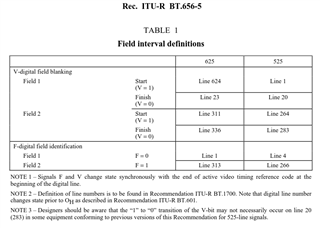

  • When we look into the Bt656 specification we can't find "Vertical field blanking No.1".
    Can someone please explain the mapping of TI's description to the parameters in the Bt656 specification?

  • Thanks again Nikolay for your answer but sorry, maybe it's because friday, I'm more confused.
    If I look into the Bt656 specification:
    I can see 4 values specifying the vertical blanking. For NTSC (525 lines, right column) these are: (Line) 1, (Line) 20, (Line) 264 & (Line) 283. And these 4 values should be used (as I understand it correctly) for configuring the vertical blanking parameters:
    (image taken from SPRUJ28E, page 1699)
    I need the information how does the values from the Bt656 specification match to the blanking parameter in the reference manual of the processor.

  • I understand it like this:
    1. line 1 to line 20 - vertical field blanking for even field
    2. line 264 to line 283 vertical field blanking for odd field
    Other lines are active video with horizontal blanking at the end.
    the vertical field blanking for even field consists of vertical field blanking no 1 for odd field + vertical field blanking no 2 for even field according to TI implementation.
    the vertical field blanking for odd field consists of vertical field blanking no 1 for even field + vertical field blanking no 2 for odd field field according to TI implementation.
    I am not sure which standard these 4 blanking periods are compatible with. I do not know how to explain it better.

    [SPRUJ28E, page 1698]
    In interlaced mode there two of this "fields" form one frame. It makes sense to label it vertical even No.1 (VFP) and No.2 (VBP).
    With all required entries for interlaced mode (NTSC) is this equation fulfilled? (Even and odd field plus vblankings for both)
    LPP + (LPP + DELTA_LPP) + (VBP'No1 + VFP'No1) + (VBP'No2 + VFP'No2) == 525 lines
