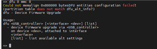

I want to Update an eMMC using DFU,But it fails to perform the command 'dfu 0 mmc 0' in the u-boot prompt.

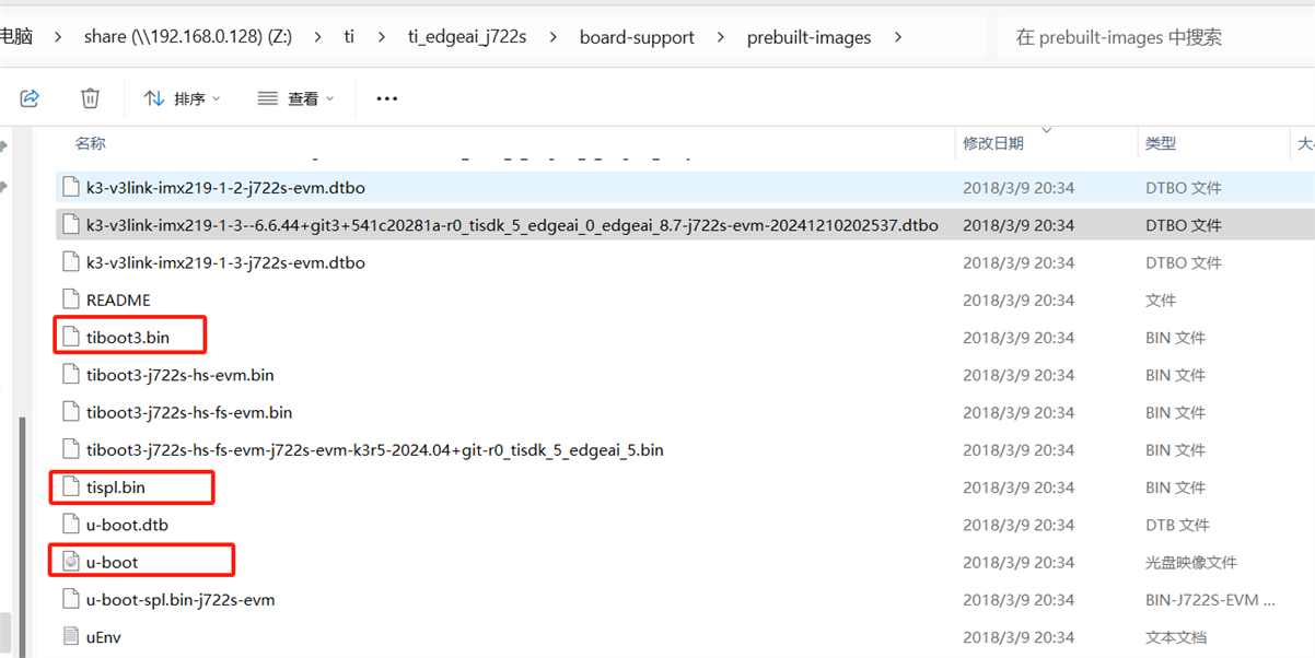

PS Z:\ti\dfu-boot> dfu-util.exe -c 1 -i 0 -a bootloader -D tiboot3.bin

PS Z:\ti\dfu-boot> dfu-util.exe -l
dfu-util 0.11
Copyright 2005-2009 Weston Schmidt, Harald Welte and OpenMoko Inc.
Copyright 2010-2021 Tormod Volden and Stefan Schmidt
This program is Free Software and has ABSOLUTELY NO WARRANTY
Please report bugs to http://sourceforge.net/p/dfu-util/tickets/
Found Runtime: [174f:1820] ver=1112, devnum=1, cfg=1, intf=4, path="4-1", alt=0, name="Camera DFU Device", serial="0001"
Found DFU: [0451:6165] ver=0223, devnum=8, cfg=1, intf=0, path="2-1.4", alt=1, name="u-boot.img", serial="UNKNOWN"
Found DFU: [0451:6165] ver=0223, devnum=8, cfg=1, intf=0, path="2-1.4", alt=0, name="tispl.bin", serial="UNKNOWN"
PS Z:\ti\dfu-boot> dfu-util.exe -c 1 -i 0 -a tispl.bin -D tispl.bin

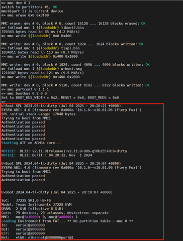

Target Logs:
U-Boot SPL 2024.04-ti-dirty (Jul 01 2025 - 11:31:37 +0800)
SYSFW ABI: 4.0 (firmware rev 0x000a '10.1.6--v10.01.06 (Fiery Fox)')
SPL initial stack usage: 17048 bytes
Trying to boot from DFU
###################################################DOWNLOAD ... OK
Ctrl+C to exit ...
Authentication passed
init_env from device 10 not supported!
Starting ATF on ARM64 core...
NOTICE:  BL31: v2.11.0(release):v2.11.0-906-g58b25570c9-dirty
NOTICE:  BL31: Built : 04:20:32, Nov  1 2024
U-Boot SPL 2024.04-ti-dirty (Jul 01 2025 - 20:47:12 +0800)
Ctrl+C to exit ...
U-Boot 2024.04-ti-dirty (Jul 01 2025 - 20:47:12 +0800)
SoC:   J722S SR1.0 HS-FS
Model: Texas Instruments J722S EVM
DRAM:  2 GiB (effective 8 GiB)
Core:  79 devices, 29 uclasses, devicetree: separate
MMC:   mmc@fa10000: 0, mmc@fa00000: 1
Loading Environment from FAT... Unable to read "uboot.env" from mmc0:1...
In:    serial@2800000
Out:   serial@2800000
Err:   serial@2800000
Net:   eth0: ethernet@8000000port@1
Hit any key to stop autoboot:  0

=> env default -f -a
## Resetting to default environment
=> setenv dfu_alt_info ${dfu_alt_info_emmc}
=> gpt write mmc 0 ${partitions}
Writing GPT: success!
=> dfu 0 mmc 0
Could not memalign 0x800000 bytesDFU entities configuration failed!
(partition table does not match dfu_alt_info?)

6. it fails to perform the command 'dfu 0 mmc 0' in the u-boot prompt.as show below:
Can you please help to solve the error(above setp6)? could you please correct the setps mentioned  above ?

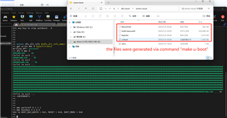

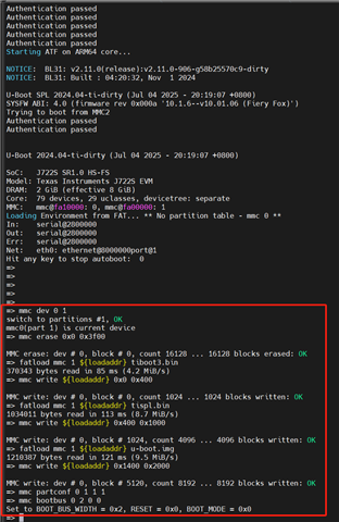

  • Hi,Gokul
    thank you for your respone and suggestion
    you mentions the above changes, I have rebuild tiboot3.bin,tispl.bin and u-boot, the command "dfu 0 mmc 0" is work fine for me,but I have a new problem that dosen't boot from eMMC.
    1.flashing images(tiboot3.bin,tispl.bin,u-boot and tisdk-base.ext4) to eMMC via dfu tool, it's show that all of things are work fine. as show below:

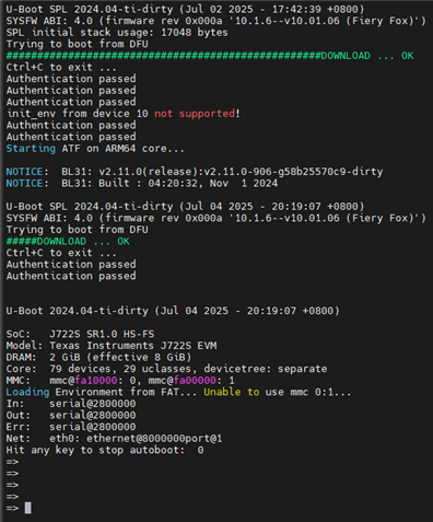

    Target logs:
    U-Boot SPL 2024.04-ti-dirty (Jul 02 2025 - 17:42:39 +0800)
    Ctrl+C to exit ...
    U-Boot SPL 2024.04-ti-dirty (Jul 02 2025 - 16:22:28 +0800)
    Ctrl+C to exit ...
    U-Boot 2024.04-ti-dirty (Jul 02 2025 - 16:22:28 +0800)
    Loading Environment from FAT... Unable to use mmc 0:1...
    In:    serial@2800000
    Out:   serial@2800000
    Err:   serial@2800000
    => mmc part

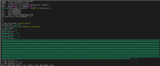

    => dfu 0 mmc 0
    ##DOWNLOAD ... OK
    Ctrl+C to exit ...
    ####DOWNLOAD ... OK
    Ctrl+C to exit ...
    Ctrl+C to exit ...
    ################################################################################################################################################################################################################################################################################################################################################################################################################################################################################################################################################################################################################################################################################################################################################################################################################################################################################################################################################################################################################################################################################################################################################################################################################################################################################################################################################################################################################################################################################################################################################################################################################################################################################################################################################################################################################################################################################################################################################################################################################################################################################################################################DOWNLOAD ... OK
    Ctrl+C to exit ...

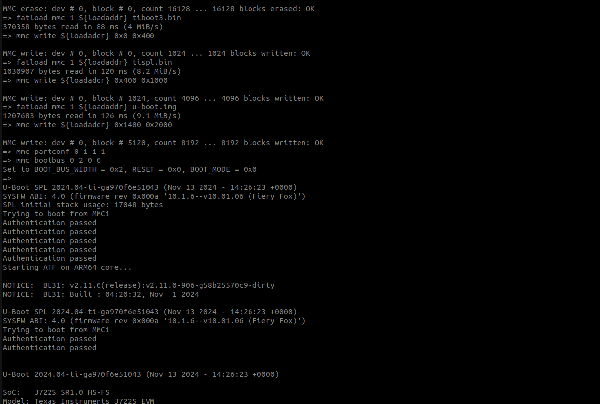

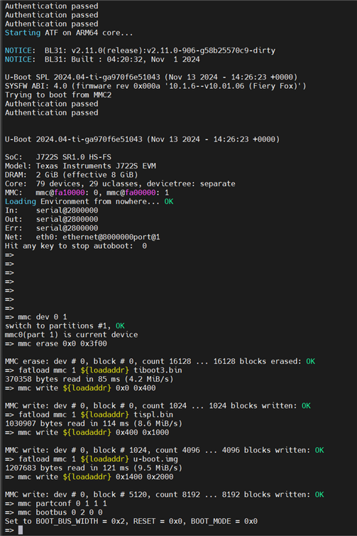

    => mmc partconf 0 1 7 1
    => mmc bootbus 0 2 0 0
    Set to BOOT_BUS_WIDTH = 0x2, RESET = 0x0, BOOT_MODE = 0x0

  • Hi Maojiang,
    The dfu flashes the boot files to boot 0 partition of emmc as we only have support for that.
    Hence you will have to have the following commands in u-boot:
    => mmc partconf 0 1 1 1
    Boot switch settings : To boot from Boot0 partition of eMMC.
    SW3[1:8] = 11010011
    SW4[1:8] = 00000000
    Gokul

    Can you mention where you are trying to take the boot files(tiboot3.bin,tispl.bin,u-boot.img) from?
    Also can you share the file sizes of the boot files(tiboot3.bin,tispl.bin,u-boot.img)?
    Gokul
  • Regards
    Hi,Gokul
    You have used alt_info_emmc right, not alt_info_mmc,right.
    yes,it's alt_info_emmc ,as show figure below:
    Maojiang
  • Hi Maojiang,
    Sorry for the delayed response.
    Can you flash the files in your [PS Z:\ti\dfu-boot] into the eMMC as those files were booting fine using dfu boot.
    Also can you share the output of the below command at u-boot command prompt:
    printenv dfu_alt_info_emmc
    Gokul
  • Hi,Gokul
    thank you for your response.
    Q1, Can you flash the files in your [PS Z:\ti\dfu-boot] into the eMMC as those files were booting fine using dfu boot.
    after perform command the 'dfu 0 mmc 0", and than to flash the files in my[PS Z:\ti\dfu-boot] into the eMMC, Is this the operation that is required?
    Q2,  Also can you share the output of the below command at u-boot command prompt:
    dfu_alt_info_emmc=rawemmc raw 0 0x800000 mmcpart 1; rootfs part 0 1; tiboot3.bin.raw raw 0x0 0x400 mmcpar  t 1; tispl.bin.raw raw 0x400 0x1000 mmcpart 1; u-boot.img.raw raw 0x1400 0x2000 mmcpart 1; u-env.raw raw   0x3400 0x100 mmcpart 1; sysfw.itb.raw raw 0x3600 0x800 mmcpart 1
    => printenv dfu_alt_info_emmc
    dfu_alt_info_emmc=rawemmc raw 0 0x800000 mmcpart 1; rootfs part 0 1; tiboot3.bin.raw raw 0x0 0x400 mmcpart 1; tispl.bin.raw raw 0x400 0x1000 mmcpart 1; u-boot.img.raw raw 0x1400 0x2000 mmcpart 1; u-env.raw raw 0x3400 0x100 mmcpart 1; sysfw.itb.raw raw 0x3600 0x800 mmcpart 1
    => <INTERRUPT>
    dfu_alt_info=rawemmc raw 0 0x800000 mmcpart 1; rootfs part 0 1; tiboot3.bin.raw raw 0x0 0x400 mmcpart 1; tispl.bin.raw raw 0x400 0x1000 mmcpart 1; u-boot.img.raw raw 0x1400 0x2000 mmcpart 1; u-env.raw raw 0x3400 0x100 mmcpart 1; sysfw.itb.raw raw 0x3600 0x800 mmcpart 1
    Maojiang

  • Hi,Gokul
    following the setps,
    1.building the ti-uboot project, The below command was performd ( add a config file "j722s_evm_r5_usbdfu.config"), and then will be generate new tiboot3.bin,tispl.bin and u-boot.img
        $(MAKE) -j $(MAKE_JOBS) -C $(UBOOT_SRC_DIR) ARCH=arm $(UBOOT_MACHINE_R5) j722s_evm_r5_usbdfu.config\
            O=$(UBOOT_R5_BUILD)
        $(MAKE) -j $(MAKE_JOBS) -C $(UBOOT_SRC_DIR) ARCH=arm CROSS_COMPILE=$(CROSS_COMPILE_ARMV7) \
            BINMAN_INDIRS=$(TI_LINUX_FIRMWARE) \
            O=$(UBOOT_R5_BUILD)
    2.dip swtitch change to boot from usb,and hardware reset
    SW3[1:8] = 1100 1010  SW4[1:8] = 0000 0000
    3. download images to j722S target board via dfu tool
    3.1 host log
    dfu-util 0.11
    Warning: Invalid DFU suffix signature
    A valid DFU suffix will be required in a future dfu-util release
    Opening DFU capable USB device...
    Device ID 0451:6165
    Device DFU version 0110
    Claiming USB DFU Interface...
    Setting Alternate Interface #0 ...
    Determining device status...
    DFU state(2) = dfuIDLE, status(0) = No error condition is present
    DFU mode device DFU version 0110
    Device returned transfer size 512
    Copying data from PC to DFU device
    Download        [=========================] 100%       350591 bytes
    Download done.
    DFU state(6) = dfuMANIFEST-SYNC, status(0) = No error condition is present
    unable to read DFU status after completion (LIBUSB_ERROR_PIPE)
    dfu-util 0.11
    Device ID 0451:6165
    Device returned transfer size 4096
    Download        [=========================] 100%      1034011 bytes
    Download done.
    DFU state(7) = dfuMANIFEST, status(0) = No error condition is present
    Done!
    PS Z:\ti\dfu-boot> dfu-util.exe -c 1 -i 0 -a u-boot.img  -D u-boot.img
    dfu-util 0.11
    Device ID 0451:6165
    Setting Alternate Interface #1 ...
    Download        [=========================] 100%      1210387 bytes
    Download done.

    3.2 target log
    4. septs for target, as show below.
    5.septs for host, as show below. flashing images to eMMC from host via DFU
    NOTE: tiboot3.bin,tispl.bin and u-boot.img are same above step3
    5.1 the below command was failed in the my folder "Z:\ti\dfu-boot>"
    dfu-util.exe  -a tiboot3.bin.raw -D tiboot3.bin
    5.2 So, I perform the below command to downlaod image to eMMC in the my folder "Z:\ti\dfu-boot>"
    dfu-util.exe -c 1 -i 0 -a tiboot3.bin.raw -D tiboot3.bin
    dfu-util.exe -c 1 -i 0 -a tispl.bin.raw -D tispl.bin
    dfu-util.exe -c 1 -i 0 -a u-boot.img.raw  -D u-boot.img
    5.2.1 host log
    PS Z:\ti\dfu-boot> dfu-util.exe -c 1 -i 0 -a tiboot3.bin.raw -D tiboot3.bin
    dfu-util 0.11
    Device ID 0451:6165
    Setting Alternate Interface #2 ...
    Download done.
    Done!
    PS Z:\ti\dfu-boot> dfu-util.exe -c 1 -i 0 -a tispl.bin.raw -D tispl.bin
    dfu-util 0.11
    Device ID 0451:6165
    Setting Alternate Interface #3 ...
    Download done.
    Done!
    PS Z:\ti\dfu-boot> dfu-util.exe -c 1 -i 0 -a u-boot.img.raw  -D u-boot.img
    dfu-util 0.11
    Device ID 0451:6165
    Setting Alternate Interface #4 ...
    Download done.
    Done!
    5.2.2 target log
    6. set for target
    7.dip swtitch change to boot from eMMC
    SW3[1:8] = 1101 0011  SW4[1:8] = 0000 0000
    8. reboot TI evm board(hardware reset SW5)
    9.there is not any log ibformation to output for my linux terminal

    1. I performd below command to dowaload images to eMMC
    => mmc dev 0 1
    => fatload mmc 1 ${loadaddr} tiboot3.bin
    => mmc write ${loadaddr} 0x0 0x400
    => fatload mmc 1 ${loadaddr} tispl.bin
    => mmc write ${loadaddr} 0x400 0x1000
    => fatload mmc 1 ${loadaddr} u-boot.img
    => mmc write ${loadaddr} 0x1400 0x2000
    2. .dip swtitch change to boot from eMMC
    3. reboot TI evm board(hardware reset SW5)
    4.there is not any log ibformation to output for my linux terminal
    Maojiang
  • HI Maojiang,
    I tried the same on my end and it is working fine for me where it is booting from eMMC BOOT 0.
    Logs:
    • Can you provide the SDK version which you are using?
      • I tried with J722S SDK version 10_00_00_08.
    • Can you try flashing with files[tiboot3.bin,tispl.bin and u-boot.img] present in <SDK_DIR>/board-support/prebuilt-images folder?
    Gokul
  • Q1,Can you provide the SDK version which you are using?
    Q2, Can you try flashing with files[tiboot3.bin,tispl.bin and u-boot.img] present in <SDK_DIR>/board-support/prebuilt-images folder?
    1.
     I have tried flashing with files[tiboot3.bin,tispl.bin and u-boot.img] present in <SDK_DIR>/board-support/prebuilt-images folder,as show below

  • Hi Maojiang,
    I tried the same on 10.01.00.04 and it works on my end.
    Logs:
    Can you ensure the following :
    SW2[1:8] = 00011100
    Also,can you make sure you are connecting to the 3rd instance of UART(ttyUSB2) for seeing the logs.
    Replug the power cable instead of hardware reset.
    Gokul
  • Hi,Gokul

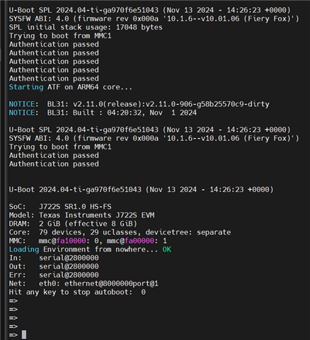

    thank you for your respone,
    I build a new u-boot, it doesn't work after rebooting TI evm board(hardware reset SW5),but  it works fine when booting from the eMMC after re-powering the TI evm board, there are similar issues regarding the 10.01.00.04 as well..
    1. logs
    2. .dip swtitch change to boot from eMMC after flashing image to eMMC, as above figure below.
    SW3[1:8] = 1101 0011  SW4[1:8] = 0000 0000 SW2[1:8] = 00011100
    3.reboot TI evm board
    3.1 hardware reset SW5,there is not any log ibformation to output for my linux terminal
    3.2 re-powering via type-C(J24), it works fine when booting from the eMMC after re-powering the TI evm board,as show below
    4. I take a picture of the TI evm board.
    Maojiang
  • Hi Maojiang,
    Thanks for the confirmation. Actually the  boot switches we set on the board sets the DEV_STAT register based on which the BOOTROM fetches which boot media to take boot files from.
    However, the DEV STAT register does not get updated when doing hardware reset using SW5. Hence, if the boot switches have to be changed(ie:the boot media has to be changed),you will have to power off and power on the board.
    However,if the you want to reset the board without changing the boot media,hardware reset(SW5) will work fine.
    Gokul
  • Hi,Gokul
    thank you for your suggestion,
    I'm still a little confused about  booting from eMMC partition 0.
    1.dip swtitch change to boot from eMMC after flashing image to eMMC, as above steps.
    2.power-on the board of J722S
    it's works fine for me,as show below.
    3. don't change the power supply state and the boot switches, after hardware reset SW5 there is not any log ibformation to output for my linux terminal,
     Is it correct?
    Maojiang
  • Hi Maojiang.
    What you have stated is perfectly correct.
    The only thing is power cycle the board after flashing files to eMMC. Do not do hardware reset using SW5 as it is having issues and we will report this to the hardware team as well regarding SW5 issue.
    Basically, in short the steps are:
    • Flash files to eMMC boot0
    • power off the board
    • change the boot switch settings to boot from eMMC boot 0 partition.
    • Power on the board.
    Gokul
