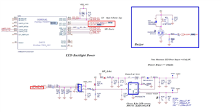

Hi Expert,
Why can two PWMs only use the same period value?
Pin define
B17
EHRPWM2_A
EHRPWM
PWM,Buzzer Control
A17
EHRPWM2_B
EHRPWM
PWM,LCM Backlight Control
DTS:
lcd_bl: backlight {
                compatible = "pwm-backlight";
                power-supply = <&vcc_3v3_sys>;
                pwms = <&epwm2 1 50000 0>;
                enable-gpios = <&main_gpio0 34 GPIO_ACTIVE_HIGH>;
                brightness-levels = <0  1  2  3  4  5  6  7  8  9 10 11 12 13 14 15 16 17 18 19 20
                                                           21 22 23 24 25 26 27 28 29 30 31 32 33 34 35 36 37 38 39 40
                                                           41 42 43 44 45 46 47 48 49 50 51 52 53 54 55 56 57 58 59 60
                                                           61 62 63 64 65 66 67 68 69 70 71 72 73 74 75 76 77 78 79 80
                                                           81 82 83 84 85 86 87 88 89 90 91 92 93 94 95 96 97 98 99 100>;
                default-brightness-level = <100>;
        main_epwm2_pins_backlight: main-epwm2-backlight-pins {
                pinctrl-single,pins = <
                        AM62X_IOPAD(0x01ec, PIN_OUTPUT, 8) /* (A17) I2C1_SDA.EHRPWM2_B */
        main_epwm2_pins_buzz: main-epwm2-buzz-pins {
                        AM62X_IOPAD(0x01e8, PIN_OUTPUT, 8) /* (B17) I2C1_SCL.EHRPWM2_A */
&epwm2 {
        pinctrl-names = "default";
        pinctrl-0 = <&main_epwm2_pins_buzz>, <&main_epwm2_pins_backlight>;
        status = "okay";
