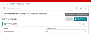

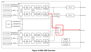

We are working with the AM62P SoC, and our goal is to achieve early display output on both LVDS and DPI display interfaces.
We are considering implementing this at the SBL2 stage.
We plan to use Falcon boot mode, with the boot sequence being: PMIC - ROM - SBL1 - SBL2 - TF-A + OPTEE + Kernel.
Currently, we have noticed that TI provides an example for DSS in the MCU+ SDK, but we have not found any example that outputs to both LVDS and DPI interfaces simultaneously.
Our questions are:
Is it possible to achieve this using the MCU+ SDK?
If so, how should we configure DSS in TI SysConfig?
We look forward to your feedback.
MCU+ SDK: 11_00_00_16
Linux: 10.01.10.04
Thank you very much.
