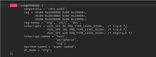

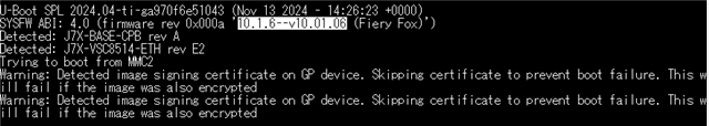

    Yes, the issue I’m facing is on Linux. When I connect a USB 3.0 flash drive to the USB Type-C port (which is supposed to support USB 3.1), it only gets recognized as a USB 2.0 device both on J721E and J721S2.

    [   43.543294] xhci-hcd xhci-hcd.21.auto: Host supports USB 3.0 SuperSpeed
    [   43.550385] hub 1-0:1.0: USB hub found
    [   43.554159] hub 1-0:1.0: 1 port detected
    [   43.558327] usb usb2: We don't know the algorithms for LPM for this host, disabling LPM.

    In addition, on the J721S2 EVM board, the USB 2.0 Type-A port is completely non-functional — the system does not detect any devices connected to it.
    Could you please advise how to resolve these issues or let us know if there are any known limitations?
    Liu
  • Hi zemiaou,
    Can you share the following files which you are using :
    • k3-j721e-common-proc-board.dts
    • k3-j721e-main.dtsi
    Also can you share the SW3 setting which you are setting on the board.
    This is because since J721S2 EVM has only 1 USB DRD controller at a time either C type or USB2.0 type-A port can only be enabled.
    Hence,by default type C port is enabled.
    If you want to enable USB TYPE A port , please follow the below FAQ:
    https://e2e.ti.com/support/processors-group/processors/f/processors-forum/1303008/faq-j721s2xsomxevm-enable-usb-2-0-hub-on-j7200-j721s2-j784s4
    Gokul
  • Hi Gokul,
    Thanks for your response.
    Yes, I intend to use the USB Type-C port since I need USB 3.0 speed support.
    I will send the requested files in the next message.
    Liu
  • Here are the files

  • Hi Zemiao,
    Can you make the following changes:
    • Can you change to dr_mode="host" in k3-j721e-common-proc-board.dts.
    • Can you change to dr_mode="host" in k3-j721e-main.dtsi.
    • Can you ensure SW3.3=0 and SW3.4=0.
    Gokul
  • Hi Gokul,
    Thanks for the support.
    I’ve updated the Device Tree with dr_mode = "host" and rebuilt the DTB successfully.
    After booting, I confirmed via /proc/device-tree that the dr_mode is correctly set to host.
    root@j721e-evm:/# strings /proc/device-tree/bus@100000/cdns-usb@4104000/usb@6000000/dr_mode
    host
    Also, I’ve set SW3.3 = 0 and SW3.4 = 0 as suggested.
    However, when I connect a USB 3.0 flash drive to the USB Type-C port, it still gets
