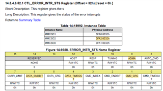

    Hello, TI Expert,
    Few question
    (1)I think it trigger SDHCI ADMA error, is it correct?
    (2) Once ADMA error, it call "sdhci_dumpregs()"  function, log as below.
    but I check adma_err_status, it seems return 0 (no error), Do you have any comment?
    What's normal register value looks like?

    Related register as below.
