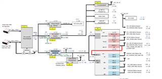

Hi TI Team,
We are currently custom designing a Automotive DMS using AM62A34 processor.
We have the following queries regarding the power supply configuration for the AM62A34:
AM62A34 EVK power current management:
  • The EVK reference schematic shows the PD controller output current as 2483.17 mA, which is insufficient to directly power the AM62A34 processor, since the processor requires up to 6.7A (6.5A for VCC_CORE and 0.2A for VDDR_CORE) according to the AM62A34 datasheet, how did increase that current using BUCK REG (3.3V) LM5141-Q1.In the reference schematic, the BUCK REG (3.3V) LM5141-Q1 shows an input current is 2133.913 mA and an output current is 8729.64 mA.
  • Could you please provide the design guidelines?
Please find bellows images of Power current diagram. We would appreciate your feedback on these queries,
