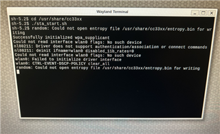

  • Hi Sabeeh,
    I got these errors when I tried doing the instructions listed on the link. I also attached the dmesg log that I got below.

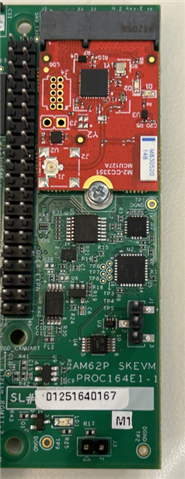

  • Hi Tapan,
    Could you share an image of the M.2 card plugged into the AM62P board?

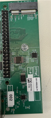

  • Hi Tapan,
    Since you're working with the AM62B, can you check if you have the R6 0 Ohm resistor installed? You can read about it here on our hardware section:
    https://dev.ti.com/tirex/content/CC33XX_LINUX_MPU_1_00_00_09__all/docs/linux/html/linux/getting-started/sk-am62b-p1.html#evaluation-hardware
  • Hi Tapan. I reached out to you offline to try to help expedite this. Please feel free to respond there or continue here. As a sanity check, I was able to get WIFI working by following the same instructions referenced in this thread, and I believe I have the same H/W as you and.

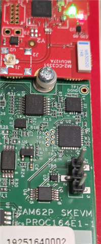

    Can you please provide another picture of your H/W with the camera zoomed in on the WIFI board and on the SK-AM62P markings. I am attaching a picture of my board for reference. Do you have more than one board.
  • Hi Ruben,
    Sorry for the delay. I was sick the last two weeks so I did not have the chance to respond to your messages. Attached below is a zoomed in picture of the SK-AM62P Board.
  • The other board I have is the SK-AM62B. Here is a zoomed in picture for that. The same issue persists for both boards.
  • I found the placeholder for the resistor but there is nothing installed there. On the link you sent it sad there should be a 10k ohm resistor but your comment mentioned a 0 ohm resistor. Could you clarify what resistor value you meant?
  • Hi Tapan,
    yes you're correct. my mistake. It should be a 10k Ohm.

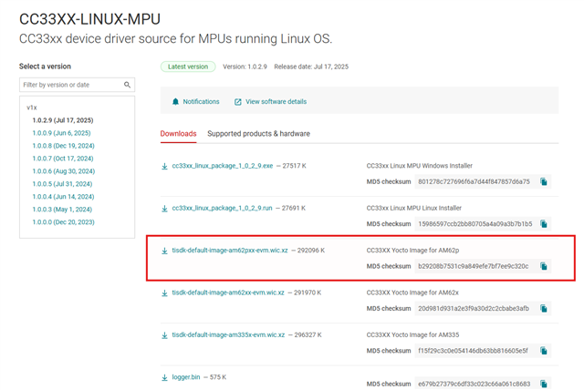

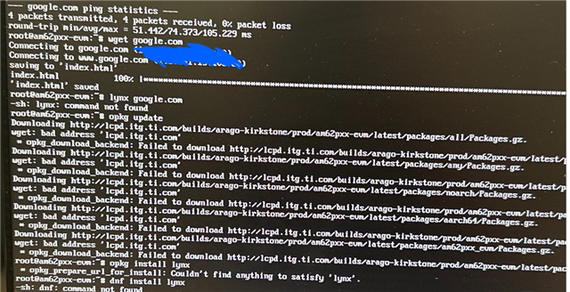

  • When I tested with this prebuilt image (https://www.ti.com/tool/download/CC33XX-LINUX-MPU/1.0.2.9), I was able to connect to Wi-Fi without having to follow these steps (https://software-dl.ti.com/processor-sdk-linux/esd/AM62X/11_00_09_04/exports/docs/linux/How_to_Guides/Target/How_To_Enable_M2CC3301_in_linux.html). However, with the initial image I flashed, which led me to make this post, the Wi-Fi was not recognized even after following the steps in the second link. The image I tried to use was from this link (https://www.ti.com/tool/PROCESSOR-SDK-AM62P). I navigated to the PROCESSOR-SDK-LINUX-AM62P and went to tisdk-default-image-am62pxx-evm-11.01.05.03.rootfs.wic.xz. This was according to the instructions on this link (Quick Start Guide)
    Is there potentially an issue with the image I am downloading? Also, if that image doesn’t work, how do I enable the graphical interface for the one that did work? I tried to update the available packages and encountered errors, as listed below, or when trying to install a text-based browser.

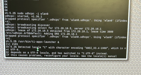

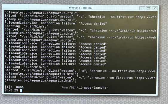

  • Hi Tapan,
    Is your screenshot from the AM62P terminal log? Looks like the WiFi is working since you are able to talk to google.com.
    The reason the opkg fails is because the opkg system is trying to talk to lcpd.itg.ti.com, which is a internal TI site. So you will not be able to access this site. Is there a particular package you are trying to update?
  • Yeah I got wifi working when flashing the image Ruben sent me. I am trying to access a web browser because the image does not have a GUI.
  • Tapan thank you for confirming this. The point of suggesting this test was just to confirm that your H/W is working correctly. The "tisdk-default-image-am62pxx-evm-11.01.05.03.rootfs.wic.xz." SD card image that you first attempted to use from the Quick Start Guide should have worked. In fact, I used this with the same SK-AM62P + M2-CC3351 H/W and it worked for me, so I have not been able to reproduce the behavior you reported.

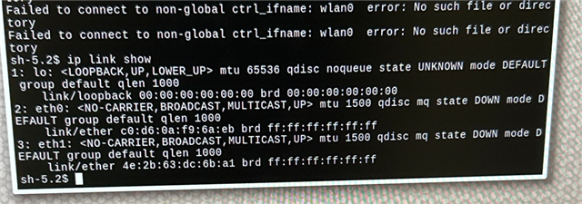

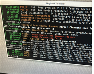

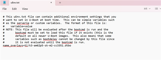

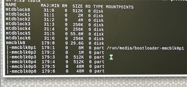

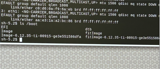

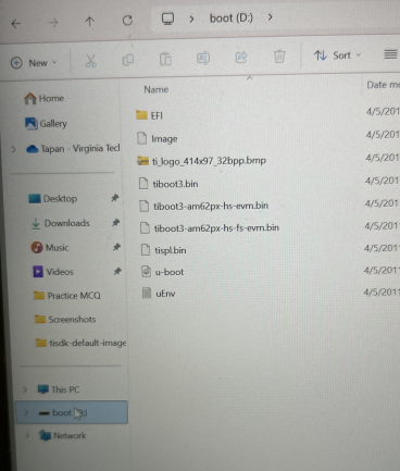

  • I tried these steps again but I still had the same issue. Here are pictures of what I was encountering.  I used this command ./sta_connect.sh -s WPA-PSK -n <SSID> -p <PASSWORD> but it failed to connect as shown in the image. After that I decided to check if the board was reading the text file correctly.  The file explorer image shows the directory of the uEnv.txt on my host computer. However when I ran the command when connected to the board it does not seem to recognize it. I saw that when I ran lsblk to see the mountpoint I saw the mountpoint also did not contain the txt file.
  • Tapan thank you for the update and good catch on the uEnv.txt file not making it over to the Linux filesystem correctly. We would expect you to have problems if you don't enable the DT overlays so we need to try that again. Do you think the file was not written back to the card when you undocked it from your PC? You could try using he Windows "Safely Remove Hardware and Eject Media" option to make sure the file is written back before pulling the card. The other thing I'm thinking could be a factor is the editor you use to modify the .txt file. Make sure there aren't any Windows-only ASCII encodings. I used Notepad++ to edit this file and it worked correctly.
  • I used Notepad to modify the file. After encountering the error on the board, I reconnected the SD card to my computer and opened the text file. It displayed the correct info, indicating that the file was successfully written back to the card. However, it seems that the board is not reading the file properly. I attached a picture of the text file below.
  • Hello Tapan,
    We can easily confirm that the uEnv is being read correctly from the AM62P. Can you send the entire output of the 'dmesg' command?
    Note: it may be easier for you to work with if you use the serial console on the AM62P rather than the HDMI gui. You can then use a program like putty or teraterm to launch a serial session and communicate with the AM62P board that way. It may be easier to copy/paste rather than taking pictures of your screen and uploading them here.

  • Hello Tapan,
    Thanks for this. From this log it is clear that the uEnv.txt is not getting read correctly. Can you please show me the output of 'ls -R /run/media/'?
    Edit: sorry, i forgot to add -R in the command above.
  • /run/media:
    boot-mmcblk1p1 bootloader-mmcblk0p1 mnt
    /run/media/boot-mmcblk1p1:
    EFI tiboot3-am62px-hs-evm.bin u-boot.img
    Image tiboot3-am62px-hs-fs-evm.bin uEnv.txt
    'System Volume Information' tiboot3.bin
    ti_logo_414x97_32bpp.bmp.gz tispl.bin
    /run/media/boot-mmcblk1p1/EFI:
    BOOT
    /run/media/boot-mmcblk1p1/EFI/BOOT:
    bootaa64.efi grub.cfg
    '/run/media/boot-mmcblk1p1/System Volume Information':
    IndexerVolumeGuid WPSettings.dat
    /run/media/bootloader-mmcblk0p1:
    tispl.bin u-boot.img
    /run/media/mnt:
    vendor
    /run/media/mnt/vendor:
    pers-mmcblk0p19
    /run/media/mnt/vendor/pers-mmcblk0p19:
    lost+found tee
    /run/media/mnt/vendor/pers-mmcblk0p19/lost+found:
    /run/media/mnt/vendor/pers-mmcblk0p19/tee:
    0 1 2 3 4 dirf.db
  • So I see the uEnv.txt in /run/media/boot-mmcblk1p1 folder. You can try editing this directly on the Am62P with this command:
    $ vi /run/media/boot-mmcblk1p1
    And then add the
    name_overlays=ti/k3-am62p5-sk-m2-cc3351.dtbo
    line.
  • Thanks! I finally got the wifi to connect. However I had one small issue. When I run the command "/usr/bin/ti-apps-launcher &"  to reopen the gui, I try to access chromium but when I click launch it does not seem to open. The images below show the output when I ran the above command and when I tried accessing chromium.
  • Tapan this is excellent news. Good work and many thanks for Sabeeh for the help on this. Regarding the Chromium browser within the AM62P apps launcher, this is working for me with WIFI. When I boot the board and connect to WIFI I am able to launch the Chromium browser from the GUI and it connects to a webgl animation of a fish aquarium. If you continue to have problems with that can you open a new thread on this forum so we can let Sabeeh close the WIFI thread?
  • Yes sounds good. Thank you Ruben and Sabeeh for your help!
