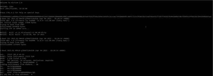

  • Hi kazuya,
    We tested this on our end on J722S TI board and it is working fine.
    Logs:
    Hence, it would be some custom changes on your board which is causing the issue.
    Can you help us by briefly elaborating all the custom changes(both hardware and software) made,so that we can narrow down the issue.
