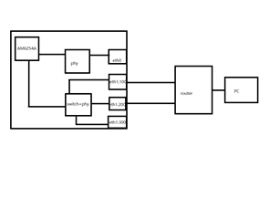

Network connection schematic
The network is distributed as follows
eth0 Link encap:Ethernet HWaddr 98:03:8A:76:13:E9
inet addr:192.168.0.2 Bcast:192.168.0.255 Mask:255.255.255.0
UP BROADCAST MULTICAST MTU:1500 Metric:1
RX packets:0 errors:0 dropped:0 overruns:0 frame:0
TX packets:0 errors:0 dropped:0 overruns:0 carrier:0
collisions:0 txqueuelen:1000
RX bytes:0 (0.0 B) TX bytes:0 (0.0 B)

When eth1.100,eth1.200, eth1.300, any two of the net ports is connected to the same router, the memory resources will be nervous and the system crashes, and how should I solve it?
sched: RT throttling activated
irq/205-8000000: page allocation failure: order:0, mode:0x820(GFP_ATOMIC), nodemask=(null)
