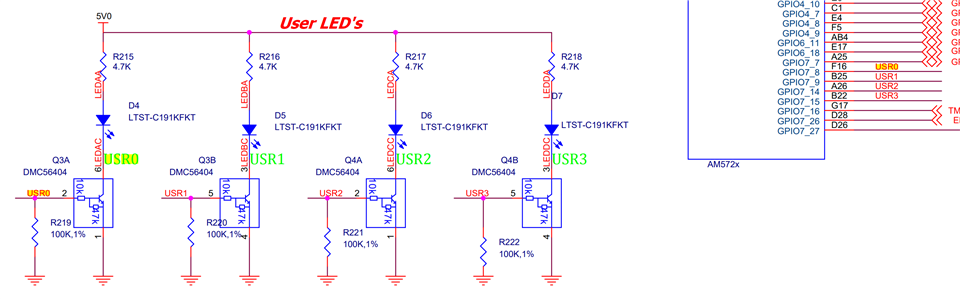

GPIO can be set to pull-up or pull-down, but can it be set to open drain?
Do I have to set up an external open drain circuit?

As an example, let's connect an LED.
Since +5V will be connected to the LED, open drain is required.
Other companies' MCUs allow for push-pull and open-drain settings.

Hi Yamada-san,
I understand. In this case, I believe you will need to setup an external open-drain circuit.
Here is an example snippet from the TMDSEVM572X EVM schematic.
