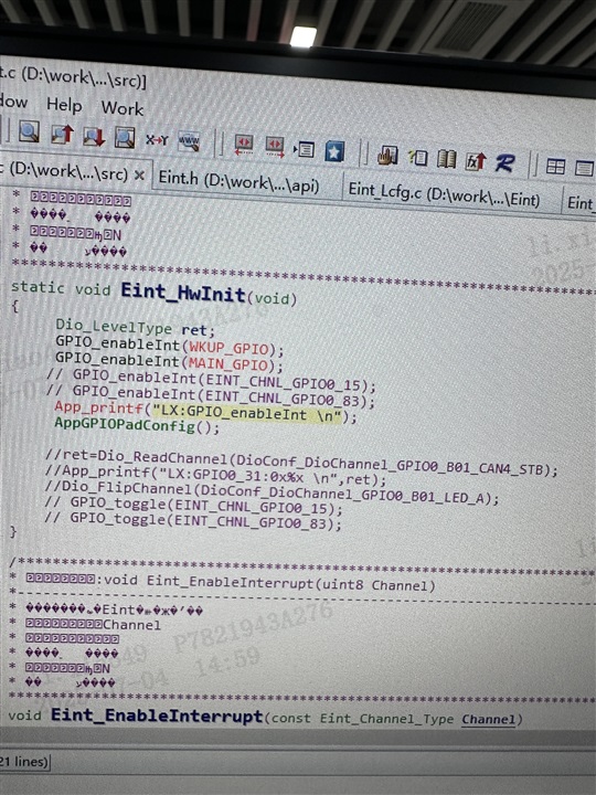

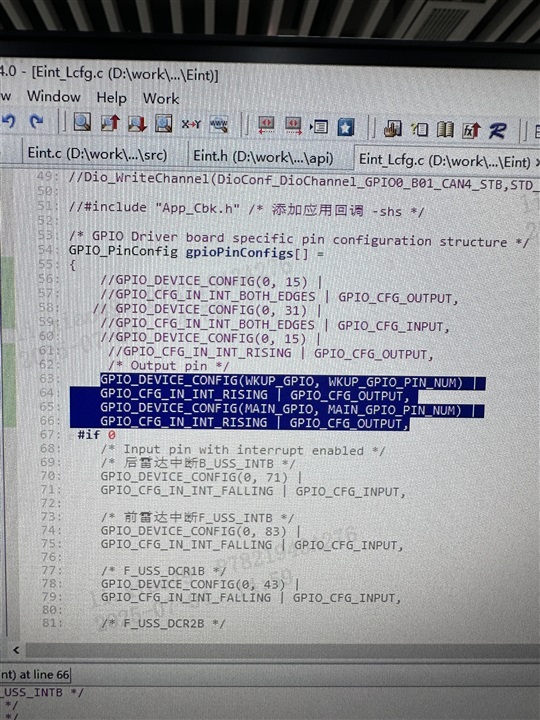

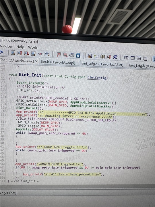

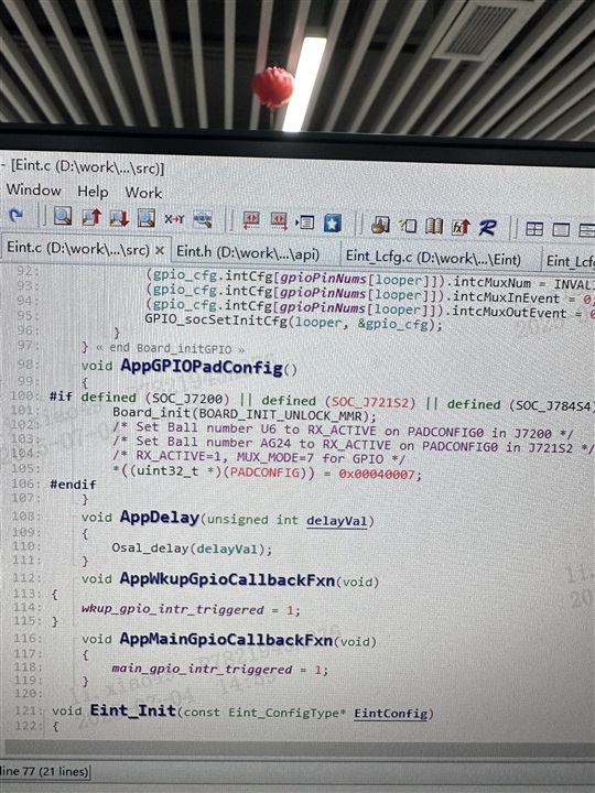

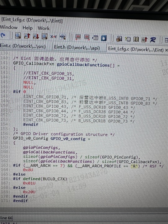

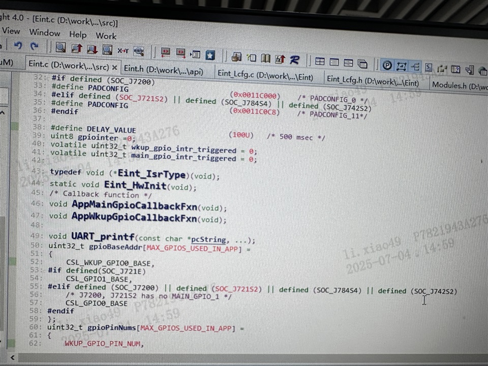

Hello, TI team:
    I found that the interrupt could not be triggered when using the interrupt trigger of GPIO, I refer to the code of the led_blink under the test folder of the gpio module in pdk10.0, I used the GPIO0_15 of the MAIN domain, set it as the output, call Board_initGPIO () first, then call GPIO_init(), then call GPIO_setCallback(), then call GPIO_enable(), When calling AppGPIOConfig() and then calling GPIO_toggle flipping the level so that an interrupt can be triggered, but the interrupt is not actually triggered, or even entering the GPIO_V0_hwiFxn(), the values of the BINTEN, DIR01, SET_DATA01, SET_RIS_TRIG01 registers of GPIO0 are the same as the settings, but the value of the corresponding bit of the INTSTAT01 is 0, indicating that no interrupt has occurred , the value of the specific register and the code I put below, please experts help me see as soon as possible, to achieve interrupt triggering, the project is urgent, and the trouble is as soon as possible.
  • The code implementation is as follows
    The values of the registers are as follows
    Please expect a delay in responses due to holidays in the US.

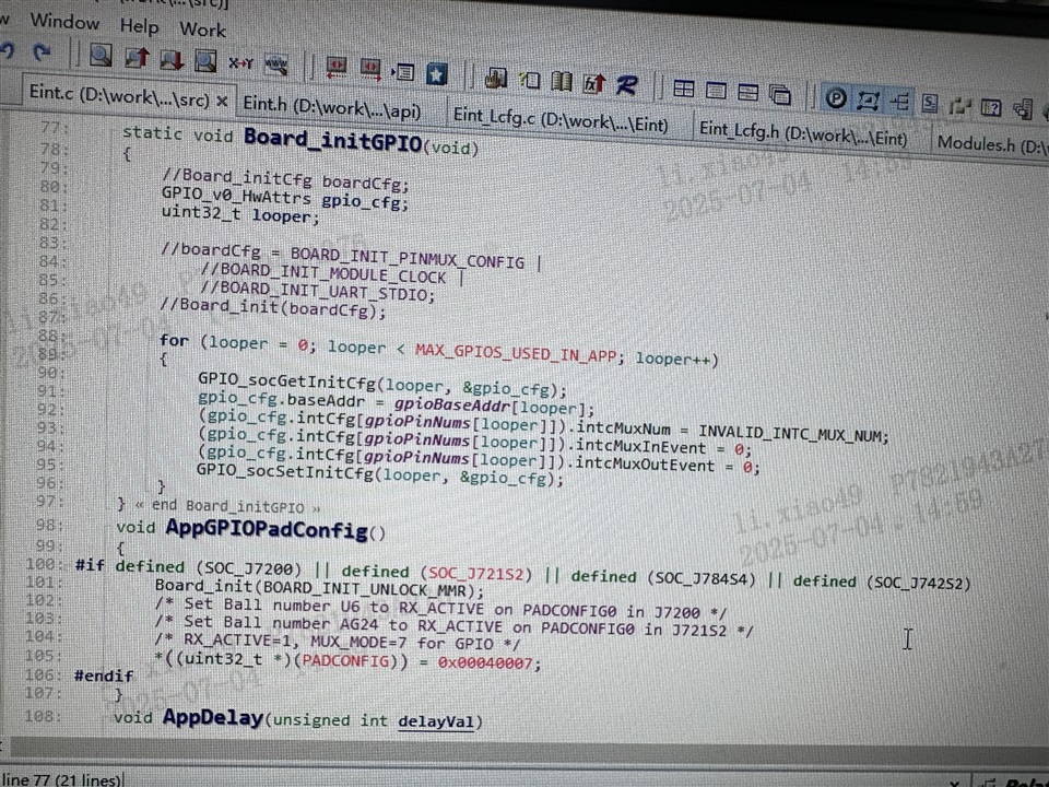

  • I have reviewed some posts and would like to provide additional information to help you locate the issue more quickly. 1. The return value of GPIO_socConfigIntrPath is CSL_PASS. 2. The boardCfg=BOARD_INIT_MODULE_CLOCK has been added in the Board_initGPIO() function, followed by Board_init(boardCfg). 3. The clock frequency of GPIO0 is 125,000,000, and GPIO0_15 is configured to drive an LED on our project board. Calling GPIO_toggle successfully toggles the light, confirming that GPIO0_15 is outputting correctly. 4. I also attempted to use GPIOs from the WKUP domain, specifically WKUP domain GPIO0_11, but I was unable to trigger an interrupt. Similarly, using GPIO0_11 in led_blink also failed to trigger an interrupt.

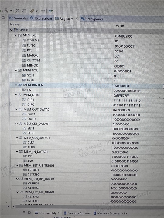

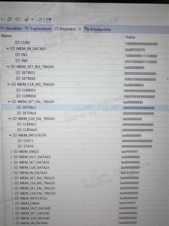

  • Hello, the output of the gel script is as follows. I debugged it, but I still did not enter the interrupt handling function.
    MCU_Cortex_R5_0: GEL Output: Reg_0x0011C03C = 0x00030007
    MCU_Cortex_R5_0: GEL Output: Reg_0x4301C0D4 = 0x00030007
    MCU_Cortex_R5_0: GEL Output: Reg_0x4301C0BC = 0x00030007
    MCU_Cortex_R5_0: GEL Output: Reg_0x42200004 = 0x00000000
    MCU_Cortex_R5_0: GEL Output: Reg_0x42200008 = 0x00000000
    MCU_Cortex_R5_0: GEL Output: Reg_0x4220000C = 0x00000000
    MCU_Cortex_R5_0: GEL Output: Reg_0x42200010 = 0x0001006A
    MCU_Cortex_R5_0: GEL Output: Reg_0x42200014 = 0x00000000
    MCU_Cortex_R5_0: GEL Output: Reg_0x42200018 = 0x00000000
    MCU_Cortex_R5_0: GEL Output: Reg_0x4220001C = 0x00000000
    MCU_Cortex_R5_0: GEL Output: Reg_0x42200020 = 0x00000000
    MCU_Cortex_R5_0: GEL Output: Reg_0x42200024 = 0x00000000
    MCU_Cortex_R5_0: GEL Output: Reg_0x42200028 = 0x00000000
    MCU_Cortex_R5_0: GEL Output: Reg_0x4220002C = 0x00000000
    MCU_Cortex_R5_0: GEL Output: Reg_0x42200030 = 0x00000000
    MCU_Cortex_R5_0: GEL Output: Reg_0x42200034 = 0x00000000
    MCU_Cortex_R5_0: GEL Output: Reg_0x42200038 = 0x00000000
    MCU_Cortex_R5_0: GEL Output: Reg_0x4220003C = 0x00000000
    MCU_Cortex_R5_0: GEL Output: Reg_0x42200040 = 0x00000000
    MCU_Cortex_R5_0: GEL Output: Reg_0x42200044 = 0x00000000
    MCU_Cortex_R5_0: GEL Output: Reg_0x42200048 = 0x00000000
    MCU_Cortex_R5_0: GEL Output: Reg_0x4220004C = 0x00000000
    MCU_Cortex_R5_0: GEL Output: Reg_0x42200050 = 0x00000000
    MCU_Cortex_R5_0: GEL Output: Reg_0x42200054 = 0x00000000
    MCU_Cortex_R5_0: GEL Output: Reg_0x42200058 = 0x00000000
    MCU_Cortex_R5_0: GEL Output: Reg_0x4220005C = 0x00000000
    MCU_Cortex_R5_0: GEL Output: Reg_0x42200060 = 0x00000000
    MCU_Cortex_R5_0: GEL Output: Reg_0x42200064 = 0x00000000
    MCU_Cortex_R5_0: GEL Output: Reg_0x42200068 = 0x00000000
    MCU_Cortex_R5_0: GEL Output: Reg_0x4220006C = 0x00000000
    MCU_Cortex_R5_0: GEL Output: Reg_0x42200070 = 0x00000000
    MCU_Cortex_R5_0: GEL Output: Reg_0x42200074 = 0x00000000
    MCU_Cortex_R5_0: GEL Output: Reg_0x42200078 = 0x00000000
    MCU_Cortex_R5_0: GEL Output: Reg_0x4220007C = 0x00000000
    MCU_Cortex_R5_0: GEL Output: Reg_0x42200080 = 0x00000000
    MCU_Cortex_R5_0: GEL Output: Reg_0x42110000 = 0x44832905
    MCU_Cortex_R5_0: GEL Output: Reg_0x42110004 = 0x00000001
    MCU_Cortex_R5_0: GEL Output: Reg_0x42110008 = 0x00000008
    MCU_Cortex_R5_0: GEL Output: Reg_0x4211000C = 0x00000000
    MCU_Cortex_R5_0: GEL Output: Reg_0x42110010 = 0xFFFFF7DF
    MCU_Cortex_R5_0: GEL Output: Reg_0x42110014 = 0x00000000
    MCU_Cortex_R5_0: GEL Output: Reg_0x42110018 = 0x00000000
    MCU_Cortex_R5_0: GEL Output: Reg_0x4211001C = 0x00000000
    MCU_Cortex_R5_0: GEL Output: Reg_0x42110020 = 0x019AE006
    MCU_Cortex_R5_0: GEL Output: Reg_0x42110024 = 0x00000000
    MCU_Cortex_R5_0: GEL Output: Reg_0x42110028 = 0x00000000
    MCU_Cortex_R5_0: GEL Output: Reg_0x4211002C = 0x00000000
    MCU_Cortex_R5_0: GEL Output: Reg_0x42110030 = 0x00000000
    MCU_Cortex_R5_0: GEL Output: Reg_0x42110034 = 0x00000000
    MCU_Cortex_R5_0: GEL Output: Reg_0x42110038 = 0xDFFFFFFF
    MCU_Cortex_R5_0: GEL Output: Reg_0x4211003C = 0x20000000
    MCU_Cortex_R5_0: GEL Output: Reg_0x42110040 = 0x20000000
    MCU_Cortex_R5_0: GEL Output: Reg_0x42110044 = 0x20000000
    MCU_Cortex_R5_0: GEL Output: Reg_0x42110048 = 0x83008001
    MCU_Cortex_R5_0: GEL Output: Reg_0x4211004C = 0x20000000
    MCU_Cortex_R5_0: GEL Output: Reg_0x42110050 = 0x20000000
    MCU_Cortex_R5_0: GEL Output: Reg_0x42110054 = 0x00000000
    MCU_Cortex_R5_0: GEL Output: Reg_0x42110058 = 0x00000000
    MCU_Cortex_R5_0: GEL Output: Reg_0x4211005C = 0x00000000
    MCU_Cortex_R5_0: GEL Output: Reg_0x42110060 = 0xFFFFFFFF
    MCU_Cortex_R5_0: GEL Output: Reg_0x42110064 = 0x00000000
    MCU_Cortex_R5_0: GEL Output: Reg_0x42110068 = 0x00000000
    MCU_Cortex_R5_0: GEL Output: Reg_0x4211006C = 0x00000000
    MCU_Cortex_R5_0: GEL Output: Reg_0x42110070 = 0x00800007
    MCU_Cortex_R5_0: GEL Output: Reg_0x42110074 = 0x00000000
    MCU_Cortex_R5_0: GEL Output: Reg_0x42110078 = 0x00000000
    MCU_Cortex_R5_0: GEL Output: Reg_0x4211007C = 0x00000000
    MCU_Cortex_R5_0: GEL Output: Reg_0x42110080 = 0x00000000
    MCU_Cortex_R5_0: GEL Output: Reg_0x42110084 = 0x00000000
    MCU_Cortex_R5_0: GEL Output: Reg_0x42110088 = 0xFFFFFFFF
    MCU_Cortex_R5_0: GEL Output: Reg_0x4211008C = 0x00000000
    MCU_Cortex_R5_0: GEL Output: Reg_0x42110090 = 0x00000000
    MCU_Cortex_R5_0: GEL Output: Reg_0x42110094 = 0x00000000
    MCU_Cortex_R5_0: GEL Output: Reg_0x42110098 = 0x00000000
    MCU_Cortex_R5_0: GEL Output: Reg_0x4211009C = 0x00000000
    MCU_Cortex_R5_0: GEL Output: Reg_0x421100A0 = 0x00000000
    MCU_Cortex_R5_0: GEL Output: Reg_0x421100A4 = 0x00000000
    MCU_Cortex_R5_0: GEL Output: Reg_0x421100A8 = 0x00000000
    MCU_Cortex_R5_0: GEL Output: Reg_0x421100AC = 0x00000000
    MCU_Cortex_R5_0: GEL Output: Reg_0x421100B0 = 0xFFFFFFFF
    MCU_Cortex_R5_0: GEL Output: Reg_0x421100B4 = 0x00000000
    MCU_Cortex_R5_0: GEL Output: Reg_0x421100B8 = 0x00000000
    MCU_Cortex_R5_0: GEL Output: Reg_0x421100BC = 0x00000000
    MCU_Cortex_R5_0: GEL Output: Reg_0x421100C0 = 0x00000000
    MCU_Cortex_R5_0: GEL Output: Reg_0x421100C4 = 0x00000000
    MCU_Cortex_R5_0: GEL Output: Reg_0x421100C8 = 0x00000000
    MCU_Cortex_R5_0: GEL Output: Reg_0x421100CC = 0x00000000
    MCU_Cortex_R5_0: GEL Output: Reg_0x421100D0 = 0x00000000
    MCU_Cortex_R5_0: GEL Output: Reg_0x421100D4 = 0x00000000
    MCU_Cortex_R5_0: GEL Output: Reg_0x40F80400 = 0x00000000
    MCU_Cortex_R5_0: GEL Output: Reg_0x40F80420 = 0x30000080
    MCU_Cortex_R5_0: GEL Output: Reg_0x40F80440 = 0x00000008
    MCU_Cortex_R5_0: GEL Output: Reg_0x40F80460 = 0x00000000
    MCU_Cortex_R5_0: GEL Output: Reg_0x40F80480 = 0x00100000
    MCU_Cortex_R5_0: GEL Output: Reg_0x40F804A0 = 0x00000000
    MCU_Cortex_R5_0: GEL Output: Reg_0x40F804C0 = 0x00000000
    MCU_Cortex_R5_0: GEL Output: Reg_0x40F804E0 = 0x00000001
    MCU_Cortex_R5_0: GEL Output: Reg_0x40F80500 = 0x00000000
    MCU_Cortex_R5_0: GEL Output: Reg_0x40F80520 = 0x00000000
    MCU_Cortex_R5_0: GEL Output: Reg_0x40F80540 = 0x00000000
    MCU_Cortex_R5_0: GEL Output: Reg_0x40F80560 = 0x00100000
    MCU_Cortex_R5_0: GEL Output: Reg_0x40F80580 = 0x00000000
    MCU_Cortex_R5_0: GEL Output: Reg_0x40F805A0 = 0x00000000
    MCU_Cortex_R5_0: GEL Output: Reg_0x40F805C0 = 0x00000000
    MCU_Cortex_R5_0: GEL Output: Reg_0x40F805E0 = 0x00000000
    MCU_Cortex_R5_0: GEL Output: Reg_0x40F80404 = 0x00000000
    MCU_Cortex_R5_0: GEL Output: Reg_0x40F80424 = 0x00000080
    MCU_Cortex_R5_0: GEL Output: Reg_0x40F80444 = 0x00000000
    MCU_Cortex_R5_0: GEL Output: Reg_0x40F80464 = 0x00000000
    MCU_Cortex_R5_0: GEL Output: Reg_0x40F80484 = 0x00000000
    MCU_Cortex_R5_0: GEL Output: Reg_0x40F804A4 = 0x00000000
    MCU_Cortex_R5_0: GEL Output: Reg_0x40F804C4 = 0x00000000
    MCU_Cortex_R5_0: GEL Output: Reg_0x40F804E4 = 0x00000000
    MCU_Cortex_R5_0: GEL Output: Reg_0x40F80504 = 0x00000000
    MCU_Cortex_R5_0: GEL Output: Reg_0x40F80524 = 0x00000000
    MCU_Cortex_R5_0: GEL Output: Reg_0x40F80544 = 0x00000000
    MCU_Cortex_R5_0: GEL Output: Reg_0x40F80564 = 0x00000000
    MCU_Cortex_R5_0: GEL Output: Reg_0x40F80584 = 0x00000000
    MCU_Cortex_R5_0: GEL Output: Reg_0x40F805A4 = 0x00000000
    MCU_Cortex_R5_0: GEL Output: Reg_0x40F805C4 = 0x00000000
    MCU_Cortex_R5_0: GEL Output: Reg_0x40F805E4 = 0x00000000
    MCU_Cortex_R5_0: GEL Output: Reg_0x40F80408 = 0x00000000
    MCU_Cortex_R5_0: GEL Output: Reg_0x40F80428 = 0x00000080
    MCU_Cortex_R5_0: GEL Output: Reg_0x40F80448 = 0x000003C0
    MCU_Cortex_R5_0: GEL Output: Reg_0x40F80468 = 0x00000000
    MCU_Cortex_R5_0: GEL Output: Reg_0x40F80488 = 0x00000000
    MCU_Cortex_R5_0: GEL Output: Reg_0x40F804A8 = 0x00000000
    MCU_Cortex_R5_0: GEL Output: Reg_0x40F804C8 = 0x00000000
    MCU_Cortex_R5_0: GEL Output: Reg_0x40F804E8 = 0x00000000
    MCU_Cortex_R5_0: GEL Output: Reg_0x40F80508 = 0x00000000
    MCU_Cortex_R5_0: GEL Output: Reg_0x40F80528 = 0x00000000
    MCU_Cortex_R5_0: GEL Output: Reg_0x40F80548 = 0x00000000
    MCU_Cortex_R5_0: GEL Output: Reg_0x40F80568 = 0x07000000
    MCU_Cortex_R5_0: GEL Output: Reg_0x40F80588 = 0x00000000
    MCU_Cortex_R5_0: GEL Output: Reg_0x40F805A8 = 0x00000000
    MCU_Cortex_R5_0: GEL Output: Reg_0x40F805C8 = 0x00000000
    MCU_Cortex_R5_0: GEL Output: Reg_0x40F805E8 = 0x00000000
    MCU_Cortex_R5_0: GEL Output: Reg_0x40F80410 = 0x00000000
    MCU_Cortex_R5_0: GEL Output: Reg_0x40F80430 = 0x00000080
    MCU_Cortex_R5_0: GEL Output: Reg_0x40F80450 = 0x00000000
    MCU_Cortex_R5_0: GEL Output: Reg_0x40F80470 = 0x00000000
    MCU_Cortex_R5_0: GEL Output: Reg_0x40F80490 = 0x00000000
    MCU_Cortex_R5_0: GEL Output: Reg_0x40F804B0 = 0x00000000
    MCU_Cortex_R5_0: GEL Output: Reg_0x40F804D0 = 0x00000000
    MCU_Cortex_R5_0: GEL Output: Reg_0x40F804F0 = 0x00000000
    MCU_Cortex_R5_0: GEL Output: Reg_0x40F80510 = 0x00000000
    MCU_Cortex_R5_0: GEL Output: Reg_0x40F80530 = 0x00000000
    MCU_Cortex_R5_0: GEL Output: Reg_0x40F80550 = 0x00000000
    MCU_Cortex_R5_0: GEL Output: Reg_0x40F80570 = 0x00000000
    MCU_Cortex_R5_0: GEL Output: Reg_0x40F80590 = 0x00000000
    MCU_Cortex_R5_0: GEL Output: Reg_0x40F805B0 = 0x00000000
    MCU_Cortex_R5_0: GEL Output: Reg_0x40F805D0 = 0x00000000
    MCU_Cortex_R5_0: GEL Output: Reg_0x40F805F0 = 0x00000000

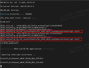

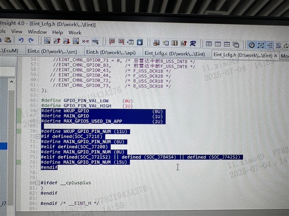

    We have also attempted interrupts on the GPIO in the WKUP domain, but we were equally unable to trigger them.
    Can you confirm the GPIO_socConfigIntrPath() return value when setting up the WKUP_ GPIO interrupt?
    Currently, our project only requires WKUP_GPIO0_5 and WKUP_GPIO0_61 for GPIO interrupts.
    I typed this question earlier, as follows
    Which are you testing with? Or are you testing with WKUP_GPIO0_11? I am trying to understand which bank you are using.
    Currently, we have attempted GPIO0_15, GPIO0_31, GPIO0_11, WKUP_GPIO0_11, WKUP_GPIO0_5, WKUP_GPIO0_61, and WKUP_GPIO0_6, but none of them have been able to trigger an interrupt.
  • According to the register dump, currently only "Reg_0x42200010 = 0x0001006A" of CSL_WKUP_GPIOMUX_INTRTR0 configured.  That means WKUP_GPIO0_GPIO_BANK_3( WKUP_GPIO0_48 to WKUP_GPIO0_63) interrupt configured.   The WKUP_GPIO0_61 should work.  Note here, you are enabled bank interrupt.
    If your purpose is WKUP_GPIO0_5 and WKUP_GPIO0_61works in interrupt mode separately, please follow the below setting

  • OK.  if the goal is wkup_gpio0_5 and wkup_gpio0_61 trigger MCU1_0 interrupt separately, please follow my demo code and dump the register let me check.
  • Hello, there are some issues with the register values provided last time. The new register values are as follows. Regarding the test code you sent me, I would like to confirm whether it is unnecessary to call GPIO_init_v0() if I am using your test code's interface. I noticed that the GPIO_init_v0() code includes interrupt settings.
    MCU_Cortex_R5_0: GEL Output: Reg_0x42200004 = 0x00010067
    MCU_Cortex_R5_0: GEL Output: Reg_0x42110008 = 0x00000009
    MCU_Cortex_R5_0: GEL Output: Reg_0x42110014 = 0x00000020
    MCU_Cortex_R5_0: GEL Output: Reg_0x42110018 = 0x00000020
    MCU_Cortex_R5_0: GEL Output: Reg_0x4211001C = 0x00000020
    MCU_Cortex_R5_0: GEL Output: Reg_0x42110020 = 0x07FA6006
    MCU_Cortex_R5_0: GEL Output: Reg_0x42110024 = 0x00000020
    MCU_Cortex_R5_0: GEL Output: Reg_0x42110028 = 0x00000020
    MCU_Cortex_R5_0: GEL Output: Reg_0x42110048 = 0x8300803C

  • GPIO_init_v0() is used for bank interrupt. You can share your office phone number; I will call you directly.
  • OK,My phone number is 15290006072
  • Hello, I tried the method of communication on the phone, and I didn't call GPIO_init() (what I understand is that the interrupt of bank is not used now, so there is no need to call GPIO_init()), call MCU_GPIO0_5_configIntRouter() and MCU_GPIO0_61_configIntRouter() first, and then call interrupt configuration, intrPrms.corepacConfig.isrRoutine=Callback (Callback is my callback function), intrPrms.corepacConfig.intVecNum=124 (WKUP_GPIO0_61 is 125), call Osal_RegisterInterrupt (&intrPrms, &hwiHandle) GPIO_enable() is called, the WKUP_GPIO0_5 and WKUP_GPIO0_61 are set to input, and the falling edge triggers, but there is no interrupt. The following uses the value of the register that debugs when waiting for the interrupt to trigger after initialization is complete:

  • MCU_Cortex_R5_0: GEL Output: Reg_0x42110010 = 0xFFFFF7DF
    This means the WKUP_GPIO0_5 set as output, please change to input mode ( bit5 should be 1, the actual is 0 as output)
     WKUP_GPIO0_61  set as output , please change to input mode ( bit29 should be 1, the actual is 0 as output)
  • Hello, I can't trigger the interrupt after I change it to input, the register value is as follows
    MCU_Cortex_R5_0: GEL Output: Reg_0x4301C0D4 = 0x00070007
    MCU_Cortex_R5_0: GEL Output: Reg_0x4301C0BC = 0x00070007
    MCU_Cortex_R5_0: GEL Output: Reg_0x42200008 = 0x0001003D
    MCU_Cortex_R5_0: GEL Output: Reg_0x42110010 = 0xFFFFF7FF
    MCU_Cortex_R5_0: GEL Output: Reg_0x42110020 = 0x07FA6026
    MCU_Cortex_R5_0: GEL Output: Reg_0x42110034 = 0x00000020
    MCU_Cortex_R5_0: GEL Output: Reg_0x42110038 = 0xFFFFFFFF
    MCU_Cortex_R5_0: GEL Output: Reg_0x42110048 = 0x8300003C
    MCU_Cortex_R5_0: GEL Output: Reg_0x4211005C = 0x20000000
    MCU_Cortex_R5_0: GEL Output: Reg_0x40F80460 = 0x80000000
    MCU_Cortex_R5_0: GEL Output: Reg_0x40F80480 = 0x00000000
    MCU_Cortex_R5_0: GEL Output: Reg_0x40F804E0 = 0x00000000
    MCU_Cortex_R5_0: GEL Output: Reg_0x40F80468 = 0x30000000
  • MCU_Cortex_R5_0: GEL Output: Reg_0x0011C03C = 0x00030007
    The PADCONFIG register isn't correct. Please change to 0x50007, that is bit16 is 1, Bit18 is 1.( pull up/down is disabled, and enable the reveiver. )
    Please modify the code as below in the J721S2_pinmux_data.c
    PIN_WKUP_GPIO0_5, PIN_MODE(7) | \
    ((PIN_PULL_DISABLE | PIN_INPUT_ENABLE) & (~PIN_PULL_DIRECTION))
    PIN_WKUP_GPIO0_61, PIN_MODE(7) | \
    PIN_GPIO0_15, PIN_MODE(7) | \
  • Hello, the register values of the WKUPGPIO0_5 and WKUP_GPIO0_61 have been modified according to what you said, or can not trigger the interrupt, I can guarantee that the read level is changed by the jump, but still not into my interrupt handler, the new register value and the log print read the level value as follows:
    MCU_Cortex_R5_0: GEL Output: Reg_0x0011C03C = 0x00020007
    MCU_Cortex_R5_0: GEL Output: Reg_0x4301C0D4 = 0x00050007
    MCU_Cortex_R5_0: GEL Output: Reg_0x4301C0BC = 0x00050007
    MCU_Cortex_R5_0: GEL Output: Reg_0x40F804C0 = 0x00000002

  • MCU_Cortex_R5_0: GEL Output: Reg_0x42200010 = 0x0001006A
    Currently the bank3 interrupt is enabled. And the interrupt no. 127 happened. Below is the raw interrupt. I suppose this is caused by GPIO0_61.
    As my expectation, the Reg_0x42200004 = 0x00010005, why enabled bank0 here?
    Could you please make sure the change output value just the same as below?
    MCU_Cortex_R5_0: GEL Output: Reg_0x42200004 = 0x00010005
    MCU_Cortex_R5_0: GEL Output: Reg_0x42200010 = 0x00000000
    Thanks.
    In addition, can you confirm the return value of GPIO_socConfigIntrPath is CSL_PASS for all of the GPIO and WKUP_GPIO pins?
    Neehar
  • Hello, it has been modified according to what you said, and the interrupt was not triggered normally, and the modified register values are as follows:
    MCU_Cortex_R5_0: GEL Output: Reg_0x42110020 = 0x019AE026
    MCU_Cortex_R5_0: GEL Output: Reg_0x42110048 = 0xA3000001

  • Hello, your colleague has asked me to use the code he provided to debug the gpio interrupt, seeing the question you asked, I used the method in the PDK package again, and confirmed that the return value of the GPIO_socConfigIntrPath is CSL_PASS through the log output, but at present we only use WKUPGPIO0_5 and WKUPGPIO0_61, and I only confirmed these two. The log output is as follows:
  • MCU_Cortex_R5_0: GEL Output: Reg_0x42110024 = 0x00000020
    Currently the Wkup_GPIO0_5 is rising edge trigger the interrupt.  So the initialized logic should be Low to trigger the interrupt.
    The WKUP_GPIO0_61 is also rising edge trigger the interrupt. So the initialized logic should be  Low also.
  • Hello, now our interrupt can be triggered into the callback function normally, thank you very much for your help, but we use the code in the PDK package to do the trigger, adjust the test code, but what you said 0x40F80460 the value of this register has always been 0, but the values of 0x4211005C and 0x42110034 are correct, marking the interrupt triggering。
  • After the ISR executed the interrupt state will be clean. the 0x40F80460 value your read is before the ISR or end the ISR?
