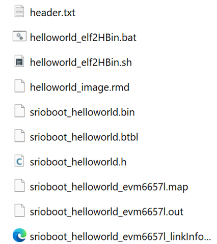

Hello Ti team,
How can I make these files from .out and .map files by Command Prompt?
Is this header file the final result for flashing on KeyStone I?
Eric

Hello TI team,
I am trying to generate a NOR flash boot image for the TMS320C6657. I used a batch file called elf2HBin.bat
to create a .bin
file from my .out
file, but the board does not boot from NOR flash with this file.

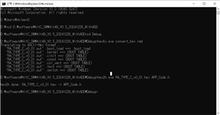

Hello Betsy,
Yes. I didn't use ibl.
RA_TYPE_C_v0_01.out
-map RA_TYPE_C_v0_01.map
-a
-image
-zero
-order L
-memwidth 8
-romwidth 16
-boot
-bootorg 0x70000900
-bootsection .boot_load 0x70000000
ROMS
FLASH: org = 0x70000000, len = 0x20000, romwidth = 16, files = {RA_TYPE_C_v0_01.hex}
This process generates an App_Code.h
file from a single-core .out
file, and it works as expected.

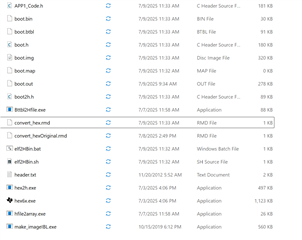

set C6000_CG_DIR="C:\ti\ccsv5\tools\compiler\c6000"
set TOOL_DIR="..\..\..\..\..\..\"
set TARGET=6657
set ENDIAN=little
set PATH=%PATH%;%SystemRoot%\system32;%SystemRoot%;
@echo off
echo C6000_CG_DIR set as: %C6000_CG_DIR%
echo TARGET set as: %TARGET%
echo IBL_ROOT_DIR set as : %IBL_ROOT_DIR%
echo Converting .out to HEX ...
if %ENDIAN% == little (
hex6x -order L convert_hex.rmd boot.out
) else (
hex6x -order M convert_hex.rmd boot.out
hex2h.exe boot.btbl boot2h.h
Bttbl2Hfile boot.btbl boot.h boot.bin
hfile2array boot.h APP1_Code.h bootCode
make_imageIBL.exe boot.out boot.img
-a
-boot
-e _c_int00
ROMS
ROM1: org = 0x80000000, length = 0x20000, memwidth = 32, romwidth = 32
files = { boot.btbl }
This section describes how to generate dual-core .out
files (from a single source), and then convert them into .bin
and boot2h.h
files for flash boot.
Eric
Hi Eric,
Just mentioning below the steps we need to follow to generate the .btbl:
// You can use Hex conversion utility 1. Create a Hex conversion command file (.cmd/.rmd) 2. Run the hex utility using the created .cmd/.rmd and .out file 3. The "step :2" will generate a .btbl 4. Burn the .btbl to flash.
Added a note here for reference.
Betsy Varughese

Hi Eric,
Thanks alot.
I checked the helper function for this version, and it only supports the image option. That’s the reason you’re getting an invalid error when using the btbl option. Let me check on the other possibilites and let you know.
Betsy Varughese
