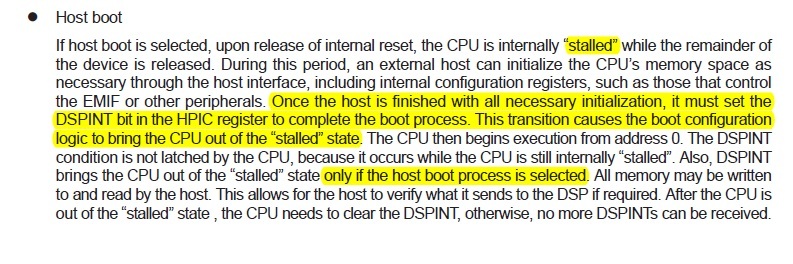

We are having an in issue with a TMS320C6713B.  Most of the time, our code is executing with no issues; we power up using Host Boot mode and all is well.  However, sometimes on power up we program in Host Boot mode (and read back the checksum over the HPI bus and all appears to be well), but the processor appears to never start.
We have checked the state of all HD pins when the reset is released.  They all appear OK, including the 'Do Not Oppose' pins in the datasheet.
We have checked the nTRST, EMU0/1 and they are the correct state on power up.  The CLK0 pin is also correct.
We have checked the length of the rest pulse.  It  quite sufficient and appears stable (no extra glitches).  We have verified that the reset pulse occurs after the power supplies are stable.
We have altered the power supply sequencing so that the 3.3V doesn't even start coming up until the core voltage is stable.  No change.
What are some other things we should be checking?  It is very odd in that once the processor does not start on a power up, subsequent pulses of the reset line do nothing....  it is some state on a particular power up that is permanent until we cycle the power again.

  • Hello Randy,
    I still have not found a solution to the issue.  I have yet to find a specification violation (not saying there couldn't be one... but I haven't found it yet).  It appears that the core is just not starting on certain power ups.
    Yesterday, we measured the EMIF Clk pin that goes to the RAM we are running out of.  There is a clock there after the DSP turns on, and the clock runs while we program the RAM through the DSP via our HPI interface with the host.  We do successfully read back the image from the RAM.    When things run successfully, the clock frequency of this pin changes dramatically after the DSPINT bit is written (and the DSPINT bit is written - we have read that register back over the HPI bus on a success and failure in booting).
    When we have a boot failure, that frequency does NOT change after writing the DSPINT bit - which also would seem to point at the dsp core not starting up when the DSPINT bit is written.
    What can so severely lock up a DSP that not only does it fail to boot properly, but subsequent pulses of the reset line do nothing at all?  It is in such a latched up state that it requires a full power cycle to come back up.
    This issue seems to be more severe at cold temperatures, btw...  Not sure what this might mean, but I thought I'd mention it.
    Is there some sort of a test mode we could be booting up into?  Are there any registers that I can try to read over the HPI interface that might indicate this invalid mode?  If we were in a test mode, what could I do to get out of it?
    Thank you for any thoughts on the matter,
    Katherine

  • Hi Katherine
    How are you initialising the PLL? If you're booting from the HPI, the PLL comes up at 50MHz and you have to set up the registers first thing in your code. If you don't follow the TI guidelines on order of operations and delays, it may not start reliably.
    Also, the HPI timings are slower before the PLL has been initialised, because the clock to the DSP's HPI hardware is slower. This has caused me mysterious crashes in the past.
    If you want to get the max speed out of the HPI, you have to slow down your host processor's bus timings while you load the code into the DSP, and then speed them up once you know the DSP has initialised and got up to full clock speed.

  • Hi Randy,
    Some additional results:
    We now have an XDS510USB emulator and the most recent version of Code Composer Studio 5.  We are unable to connect with the emulator to a failed board, although we can successfully connect to a board running normally.  It would appear that the JTAG interface is totally dead.
    We tried adding the pullups to the JTAG lines (had them already on EMU0/1) and a pull down on NTRST.  No change.
    Some of the measurements you asked for:
    CLKout2 pin - on a successful boot, it has been reconfigured ast GP2 and has a signal with frequency around 562 Khz (not a constant clock, but the pulses are that frequency).
    CLKout2 pin - on a failed boot, it is 18.75 Mhz
    CLKout3 - on a successful boot, it is 37.8 Mhz.  On a failed boot, it is 4.68 Mhz
    CLKMODE 0 - always seems to be high, fail or success.
    NMI - always seems to be low, fail or success.
    ARDY, HOLDz, HOLDaz are not accessible (not connected to anything and can't get to the pin.  After a failure, CE0 is high with two 55ns low pulses occurring 213 ns apart approximately every 45us.  CE1 and 2 and 3 are high.
    I haven't been able to try anything with the PLL yet from your later post.
    Katie

  • Hallo Katherine,
    here are our newest state, after having got some hints from europeen customer venter in Munich.
    They pointed out to the ERRATA-Sheet and there to the PULL-UPs and -Downs at the JTAG signals
    and e.g. CLKOUT3 (we do not use this PIN). I asked them about second functions of this PIN during Reset

    From the device DS, the term stalled is mysterious to me with regard to the emulator operation.
    I suggest you modify your FPGA to not SET the DSPINT bit, and see if you can grab the CPU with the emulator.  If you are successful, then the problem is not there, whether you use small or large foot print code.

    Sam - I like your idea on the dspint.  We haven't tried grabbing the emulator in that fashion, but that would be a fairly easy test to accomplish.

  • So just to clarify, the issue is:
    The first thing it does on coming out of reset is push the value of B0 to the stack, but the stack pointer isn't yet initialised, so it overwrites a random memory location?
    I guess that would fit with the symptoms.
  • Hello everyone,
    Update:
    I tried to get a failure this morning prior to setting the DSPINT...  and although this failure has never been 100% reproducible, I could not get a failure to connect with the emulator at any time prior to setting the DSPINT bit.  This was a much easier test for me than building a new code load - so thanks to Sam for mentioning it!!!
    That gave me a confidence boost that the issue really IS software related and I was really liking the other forums posts about the reset vector at that point....
    Then, I noticed something else..... B15 is NOT reset to 0x0 on a power up - it changes every time we power up according to what I read with the emulator prior to setting DSPINT.  So, it would appear not to be a register affected by the reset pulse (read earlier posts.... reset doesn't help/hurt this situation.....).  B15 is rather random, but on a board that has readily show cold boot failures, 1's appear more often when it is cold.  It is very typical for B15 to start with 0x28 or 0x2A when not cold,, and 0x3(something) when sprayed with cold spray.  This was as easily reproducible as the reset failures for the board I was looking at, and seemed to follow the same pattern.  Hit with cold - B15 started with 3.... let it set and it starts with a 2.  I have only checked this on one board, but the correlation was very good.  It may be that different DSPs are more/less susceptible to cold wrt the default contents of this register value.... which might be why we don't seem to see this on some boards.
    Now I'm starting to grin.....
    Then....  (to get all pertinent info in same place) Ralf's posts in his thread "Start Problem after HPI Boot with C6713" have mentioned he has two chips - one with BIOS (that NEVER fails) and one without.  The one without BIOS (using the default vector table macros) is the one that fails.  So both of us are having almost identical issues, but I didn't know if we were using BIOS until the post today which showed the reset vectors.... Seemed that I had the same sort of code for the reset vector as Ralf.
    Grinning more......
    I only have access to the converted-to-hex output file, which I program over HPI.  However, based on the posts this morning, I rewrote the hex for the reset vector so that it doesn't mess with B15.  It does as was suggested - just loads the address and branches.
    Results:  well, we're still testing.  We're having one of those days where the fault condition has been hard to reproduce, but if you can't tell, I'm very optimistic because what I've seen thus far FITS the profile.  So far we haven't had a failure with the 'fix', but it really is too early to confirm.  I will repost later with results of more boards.
    Thanks for all of the great suggestions!
    -Katherine
