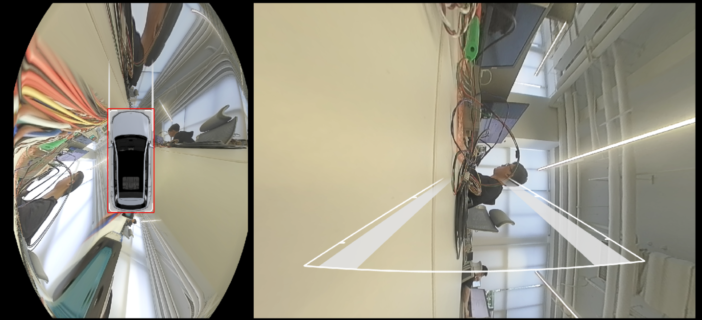

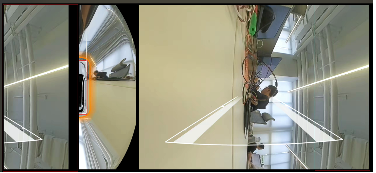

I want to convert a 2560 * 1440 RGBX format image to NV12 while using the displayM2M node, but the following problem occurs in the converted image. Could you please help me analyze the reason?
original image:
Converted image:
    Is this a duplicate question?
    Tanmay
  • The platform I am using is TDA4VE, and I made a mistake with TDA4VM, but I don't know how to delete the previous one, so I had to raise this issue again.
  • Hi Damon
    What app are you used to test dispm2m color convert?
    Adam
  • Hi Damon,
    Can you share your graph creation part with the config values, and also how are you save the image ?
    Gokul

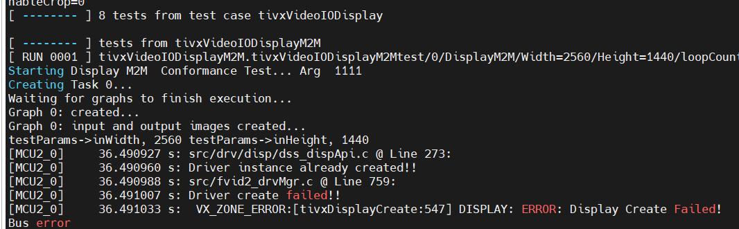

  • Hi Damon,
    Can you try this test program video_io/kernels/video_io/test/test_display_m2m.c?
    run ./vx_app_conformance_video_io.out --filter=tivxVideoIODisplayM2M* under /opt/vision_apps/
    Adam
  • Hi Adam
    I have already tested this program, and the results are as follows.
    Before the resolution is modified, the program can run normally
    Damon
  • Hi Damon,
    Can you please check this in latest sdk once, we saw some issue on 9.1 at higher resolutions.
    Gokul
  • Hello Gokul,
    I am using SDK version 0901. Do you have any updated versions available for us?
    Damon
  • Hello Gokul,
    We don't have the hardware for this TDA4 VE demo board. How can I verify it, Or do you have any other solutions to verify?
    Damon
  • Hi Damon,
    You should be having an evm right ? or is that a custom board that you have tested with sdk version 9.0.
    Can you share your input image here so that I can give a try in my setup here If i find some time.
    Gokul
  • Hello Gokul,
    Can the SDK 11.00 you provided run on evm bord? Please provide me with an email so that I can send you images in RGBX format. It seems that uploading images in this format is not supported.
    Damon
  • Hi Damon,
    Yes it will run on evm and it is the latest sdk release.
    Can you add it inside .zip file and upload it.
    Gokul
  • Hello Gokus,
    I tried running the SDK program on the EVM board and found that it failed to start. I tried running our program on our own 0901ve board again and found that when the resolution width is greater than 2048, the abnormal situation occurs when the output image format of the displayM2MNode is set to NV12 (which isnormal when the output format is set to yuyv). Can you give me more advice?
    Damon

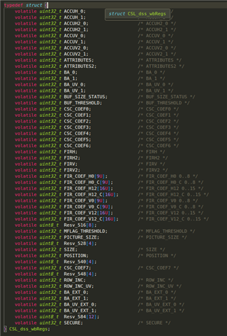

  • Hi Damon,
    Can you share the writeback pipe register dumps,
    from address (0x4af0000UL) and till the size of this struct,
    Gokul
  • Hello Gokul,
    I don't understand what you mean by this. Should I use any tool to operate it or check through logs?
    Damon

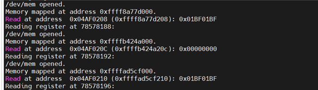

  • Hi Damon,
    While running your application in another linux terminal run this script,
    #!/bin/bash
    BASE_ADDRESS=0x04af0000
    for (( i=$BASE_ADDRESS; i< ($BASE_ADDRESS + 588) ; i+=4 ));
    do
      # Commands to be executed
      echo "Reading register at $i:"
      devmem2 "$i"
    done
    This will dump the writeback pipe registers.
    Gokul
  • Hello Gokul,
    The result of the operation is as follows. Please help analyze it.
    root@Linux:/opt/vision_apps# ./test.sh
    Reading register at 78577664:
    /dev/mem opened.
    Memory mapped at address 0xffffa819f000.
    Read at address  0x04AF0000 (0xffffa819f000): 0x00000000
    Reading register at 78577668:
    /dev/mem opened.
    Memory mapped at address 0xffffabf25000.
    Read at address  0x04AF0004 (0xffffabf25004): 0x00000000
    Reading register at 78577672:
    /dev/mem opened.
    Memory mapped at address 0xffffb6e64000.
    Read at address  0x04AF0008 (0xffffb6e64008): 0x00000000
    Reading register at 78577676:
    /dev/mem opened.
    Memory mapped at address 0xffffb9bc4000.
    Read at address  0x04AF000C (0xffffb9bc400c): 0x00000000
    Reading register at 78577680:
    /dev/mem opened.
    Memory mapped at address 0xffff91d7f000.
    Read at address  0x04AF0010 (0xffff91d7f010): 0x00000000
    Reading register at 78577684:
    /dev/mem opened.
    Memory mapped at address 0xffff8428c000.
    Read at address  0x04AF0014 (0xffff8428c014): 0x00000000
    Reading register at 78577688:
    /dev/mem opened.
    Memory mapped at address 0xffffb7db5000.
    Read at address  0x04AF0018 (0xffffb7db5018): 0x00000000
    Reading register at 78577692:
    /dev/mem opened.
    Memory mapped at address 0xffff81793000.
    Read at address  0x04AF001C (0xffff8179301c): 0x00000000
    Reading register at 78577696:
    /dev/mem opened.
    Memory mapped at address 0xffff9d1d7000.
    Read at address  0x04AF0020 (0xffff9d1d7020): 0x002819FA
    Reading register at 78577700:
    /dev/mem opened.
    Memory mapped at address 0xffff9f142000.
    Read at address  0x04AF0024 (0xffff9f142024): 0x3C000000
    Reading register at 78577704:
    /dev/mem opened.
    Memory mapped at address 0xffff91173000.
    Read at address  0x04AF0028 (0xffff91173028): 0xC54ED000
    Reading register at 78577708:
    /dev/mem opened.
    Memory mapped at address 0xffffa1e38000.
    Read at address  0x04AF002C (0xffffa1e3802c): 0x00000000
    Reading register at 78577712:
    /dev/mem opened.
    Memory mapped at address 0xffff990e0000.
    Read at address  0x04AF0030 (0xffff990e0030): 0xC5619000
    Reading register at 78577716:
    /dev/mem opened.
    Memory mapped at address 0xffff92c01000.
    Read at address  0x04AF0034 (0xffff92c01034): 0x00000000
    Reading register at 78577720:
    /dev/mem opened.
    Memory mapped at address 0xffff8aa28000.
    Read at address  0x04AF0038 (0xffff8aa28038): 0x00001000
    Reading register at 78577724:
    /dev/mem opened.
    Memory mapped at address 0xffffa54af000.
    Read at address  0x04AF003C (0xffffa54af03c): 0x00160008
    Reading register at 78577728:
    /dev/mem opened.
    Memory mapped at address 0xffffa1366000.
    Read at address  0x04AF0040 (0xffffa1366040): 0x0096004D
    Reading register at 78577732:
    /dev/mem opened.
    Memory mapped at address 0xffff8ad7f000.
    Read at address  0x04AF0044 (0xffff8ad7f044): 0x0083001D
    Reading register at 78577736:
    /dev/mem opened.
    Memory mapped at address 0xffff9aec8000.
    Read at address  0x04AF0048 (0xffff9aec8048): 0x07EB0792
    Reading register at 78577740:
    /dev/mem opened.
    Memory mapped at address 0xffff8e64e000.
    Read at address  0x04AF004C (0xffff8e64e04c): 0x07A907D4

    Damon
  • Hi Damon,
    Are you cropping your image from input to output and can you share your input and output image size.
    Gokul
  • Hello Gokul,
    My requirement is to crop the output image of Display M2M into 2 parts, with an input size of 2560 * 1440 and an output image size of 832 * 1120, 1568 * 1120.
    Damon
  • Hi Damon,
    So are you using 2 displaym2m node ? with 2 different output image. The image you posted for which case ?
    Gokul
  • And also can you check with only one output with either 832 * 1120 or 1568 * 1120
    And the register dumps you shared is for which configuration.
    Gokul
  • Hello Gokul,
    You misunderstood my meaning. I am using a scaler node downstream of the display M2M node for crop. As for the input and output resolution of the display M2M node, they are both 2560 * 1440, displayM2M only for changing the color format RGBX ->NV12
    Damon
  • ok, Got it,
    you are using 1 displaym2m node to convert the color and both the input and output image size's are same.
    we are seeing some difference in values between 2 registers ( 0x04AF0208 and 0x04AF0210 ) which is the output and input size registers. Ideally the values should be same if the input and output size is same. Can you check for yuyv output whether this 2 values are same ?
    Gokul

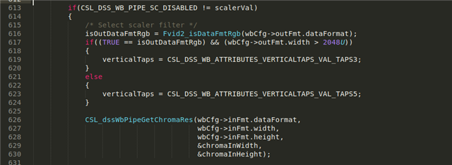

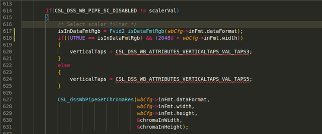

  • Hi Damon,
    Can you change the file in line 616-617 ti-processor-sdk-rtos-j721s2-evm-09_01_00_06/pdk_j721s2_09_01_00_22/packages/ti/csl/src/ip/dss/V4/priv/csl_dssWbPipe.c
    from,
    to,
    and rebuild the sdk.
    Gokul
  • Hello Gokul,
    After this modification, the output image is normal. This solution can solve my problem.
    Damon
