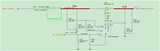

  We used the following GPIO to connect to the EN pin of LM74700. I set it as GPIO function, but when I could not successfully pull it up. And I measured that the voltage values of KL30_VBAT1 and KL30_VBAT1_HS are the
same. I have the following two problems:
1. Why can't EN pin be pulled up normally?
2. What is the function of the EN pin?

  • Note you do have a resistor divider on your enable signal (2.2K resistor and 10K resistor).  If the IO output is 3.3v, then then the voltage at enable pin will only be about 2.7V.  That is very close to the thresholds for the LM74700

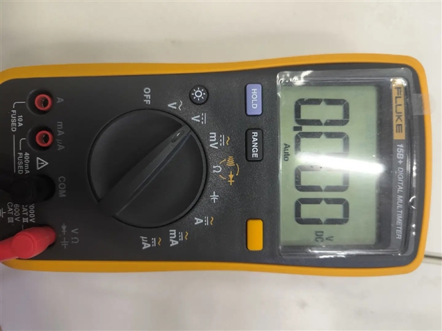

      During my testing here, the voltage value consistently remains at 0V, regardless of whether I configure it in RTOS or Linux, and even after performing a pull-
    up operation, it still remains at 0V.
    Yang

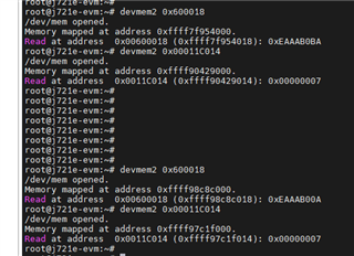

      Actually, I have already sent the register values for AH23 before.
    Yang

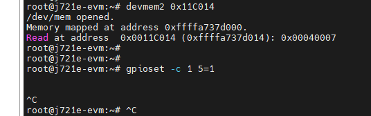

  • Hi Yang,
    Could you please test with Padconfig register set to 0x00040007?
    Is this the only GPIO pin you have issues toggling?
    Note you will have to configure GPIO as an output and drive to high/low - as internal pull resistors are not sufficient to set state.
    Additionally, can you provide a dump of the GPIO dir register? Have you configured the GPIO as input or output?
    Neehar
      I set the register value to 0x00040007 and then used the command in the diagram to pull it up, but its voltage value is still 0V.
      I have tried configuring PINMUX to output a high level before, but its voltage value is still 0V.
    Yang

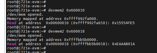

  • Hi Yang,
    Although you have set the Pinmux output to level high, you will also have to configure the GPIO pin direction using the GPIO_DIR01 register.
    The physical address for GPIO_DIR01 is 0x0060 0010.
    Neehar

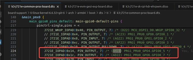

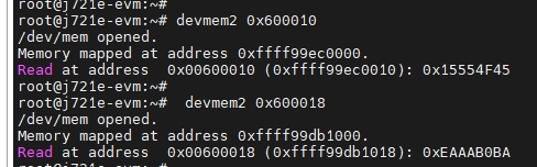

      You are right, when I manually modify the stored value, I can detect that the voltage is pulled up to 3.3V, but I want to know why configuring GPIO as output in Pinmux
    or device tree does not take effect? Did you not successfully modify these two registers?
    I simultaneously modified the GPIO of AH23 and AD22 for comparison:
    devmem2 0x600010 w 0x15554F45
    devmem2 0x600018 w 0xEAAAB0BA
    Yang
  • Hi Yang,
    When setting the pinmux in the device tree as you have shown, it will only update the PADCONFIG register for the pad or pin. You have to also update the GPIO module registers to ensure the GPIO module is aware if the pin is input or output. There will be some default values for the GPIO direction register which may be why it did not previously work for specifically only AH23.
    Neehar
