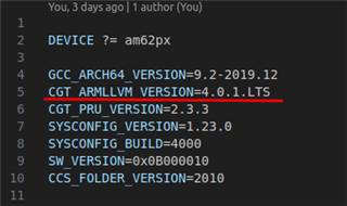

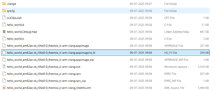

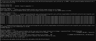

 3.I compiled the hello world application (r5fss0-0_freertos). While trying to flash the prebuilt binary image using the following command,

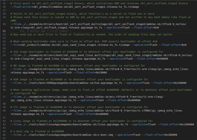

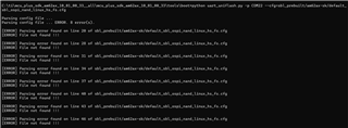

  python uart_uniflash.py -p COM13 --cfg=sbl_prebuilt/am62ax-sk/default_sbl_ospi_nand_linux_hs_fs.cfg
Stage2 binaries which are mentioned in the pre-configured file (default_sbl_ospi_nand_linux_hs_fs.cfg) are not present in the SDK in the mentioned path.
Please find the attached screenshot with error log for reference.
please help me to reslove this.
