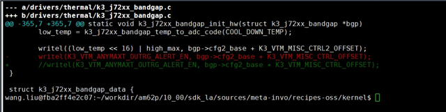

    We can reproduce customer report problem at AM62P EVM board.
    Below is reproduce method.
    HW: AM62P-SK EVM board run at 25C room temperature
    SW: SD card boot method run RDK10.1 AM62P prebuild file system + print out register 0x0451 8178h MMR0_RST_SRC register uboot.
          attached env.c file are our modifyed.

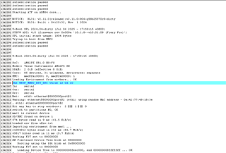

    Test method, power on EVM board run 30 second insure AM62P enter linux OS, then power off 5 second.
    We can find that at log line 1342306 happen thermal reset. We believe it is same as customer side issue it is abnormal thermal reset.
    Please help us reproduce at your side and debug with us together.

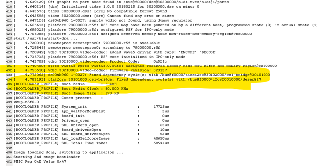

    The environment we reproduced on the TI development board is as follows:
    Boot method: OSPI + eMMC
    MCU program resides in Flash
    SoC program is stored in eMMC
    MCU software: Uses the Hello World program from the SDK with additional register printing (source code provided in the attachment).
    Main domain software: Our proprietary product software.
    Please let us know if further details are needed.

    before this issue occurred, there is no any change related to k3_j72xx_bandgap.c driver and mcu firmware, the orginal SDK10.1 can reproduce this issue on EVM as well. and this issue will not related the bootmode, because we have reproduced the issue using SD card and Nor flash boot.
    something needs to be corrected, after customer clear the bit of WKUP_VTM_MISC_CTRL[0] ANYMAXT_OUTRG_ALERT_EN, customer said the abnormal reset is gone (after over 30000 times test confirm), previous feedback from customer has some misunderstanding.
    so Anshu, we need you help why the temperature sensor value is ~48C(both on chip sensor and on custom board sensor said it is ~48C), VTM still will output the THERM_MAXTEMP_OUTRANGE_ALERT to trig the warm reset.

  • Hi Anshu,
    below log can prove the warm reset has occurred. not just the register value change.
    warm reset log.txt.
    BR,
    Biao

    Can you share the A53 logs of a failed test cycle? Please include the shutdown logs and the next boot log with the RST_SRC output. Also please include the Thermal zone output in the logs. I would like to see if the Linux logs indicate any information.
    Anshu
  • Hi Anshu:
    Thanks for help us check DIE ID information with factory.
    Please check i has send at last week. The AM62P DIE temperature has captured through minicom.
    This log is AM62P EVM board at TI lab and increase Tj to ~105C tested result. I increase Tj to 105C do not  accelerate issue reproduce.
    Test more than >2000 circle i do not reproduce it.
    soclog.txt is customer board capture trigger AM62P thermal reset printout log. I has capture it and the reset happen at AM62P start about 4.7 second.
