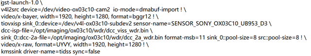

Currently, I am developing a project that cyclically acquires video streams through 4 cameras. However, a problem has arisen during my use of GStreamer: after passing through the tiovxisp plugin, only the NV12 image format can be output, while other YUV formats are used in our project.

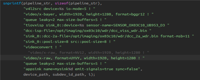

1. I tried using the videoconvert plugin for image format conversion, but it caused  video stream latency.
2. How can I process the video through the ISP but output images in other YUV formats, such as UYVY, instead of NV12?
    You can try adding queues to see if they help with the latency issue. Can you see/send how much CPU is being consumed by GStreamer?

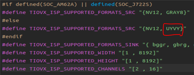

    The tiovxisp plugin only supports the following formats:
    • GRAY8
    • GRAY16_LE
    • NV12
    • I420
    You can read the documentation here: https://github.com/TexasInstruments/edgeai-gst-plugins/wiki/tiovxisp
    You could try to patch and recompile the source code to add another format: https://github.com/TexasInstruments/edgeai-gst-plugins/blob/main/ext/tiovx/gsttiovxisp.c

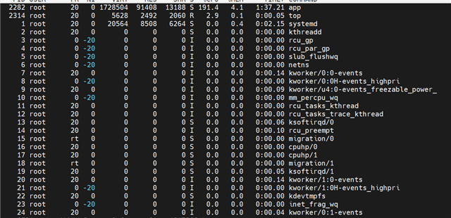

    1. I added queues and caches in ‘gst_parse_launch’, but there is still a delay in the video stream, and the CPU usage is very high.
    2. After testing, the CPU usage rates for the NV12 and UYVY image formats are as shown in the figure below, which are 45.7% and 191.4% respectively.The "app" in the figure refers to my program.
    3.Do you mean that tiovxisp can add output support for other YUV formats? I tried modifying the macro definitions in the picture below, but encountered errors after testing. Could you tell me how to add them properly?
    ERROR:
      1507.681734 s:  VX_ZONE_ERROR:[tivxAddKernelVpacVissValidate:631] NV12_P12 on 'output0' and YUV422 on 'output2' are not possible
      1507.681759 s:  VX_ZONE_ERROR:[ownGraphNodeKernelValidate:556] node kernel validate failed for kernel com.ti.hwa.vpac_viss at index 0
      1507.681766 s:  VX_ZONE_ERROR:[vxVerifyGraph:2041] Node kernel Validate failed
      1507.681773 s:  VX_ZONE_ERROR:[vxVerifyGraph:2213] Graph verify failed
      1507.682043 s:  VX_ZONE_ERROR:[ownReleaseReferenceInt:598] Invalid reference
    ERROR: from element /GstPipeline:pipeline0/GstTIOVXISP:tiovxisp0: Unable to init TIOVX module

    This issue has been resolved. Thank you very much! I have another question to ask you:
