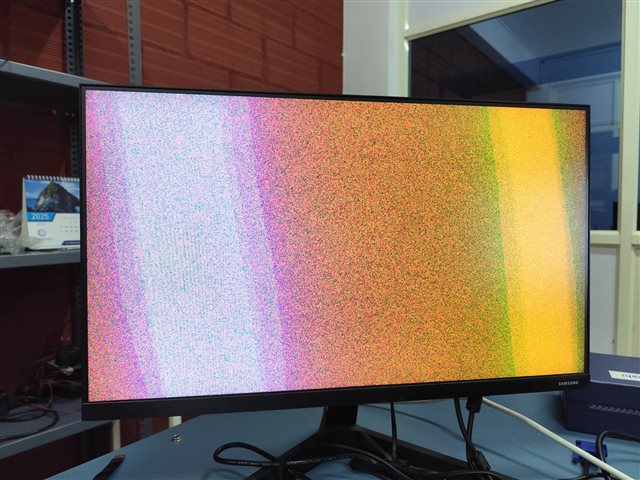

We are currently developing the driver for the OS02C10 sensor on the SK-AM62A-LP starter kit. Using the register settings recommended by the Omnivision team, we have successfully probed and initialized the camera sensor over the I2C interface.
As we proceed to capture a basic stream using a GStreamer pipeline, we are encountering memory allocation issues, which are detailed below.

5. gst-launch streaming issue
# v4l2-ctl -d /dev/video3 \
>   --set-fmt-video=width=1920,height=1080,pixelformat=BA10 \
>   --stream-mmap --stream-count=1 --stream-to=test.raw
		VIDIOC_STREAMON returned -1 (No such file or directory)
# GDEBUG=0 gst-launch-1.0   v4l2src device=/dev/video3 !   video/x-bayer, width=1920, height=1080, format=bggr !   bayer2rgb !   videoconvert !   video/x-raw, format=RGB16, width=1920, height=1080 !   kmssink driver-name=tidss sync=false
Setting pipeline to PAUSED ...
Pipeline is live and does not need PREROLL ...
Pipeline is PREROLLED ...
Setting pipeline to PLAYING ...
New clock: GstSystemClock
ERROR: from element /GstPipeline:pipeline0/GstV4l2Src:v4l2src0: Failed to allocate required memory.
Additional debug info:
../gst-plugins-good-1.20.7/sys/v4l2/gstv4l2src.c(777): gst_v4l2src_decide_allocation (): /GstPipeline:pipeline0/GstV4l2Src:v4l2src0:
Buffer pool activation failed
Execution ended after 0:00:00.076110248
Setting pipeline to NULL ...
ERROR: from element /GstPipeline:pipeline0/GstV4l2Src:v4l2src0: Internal data stream error.
../gstreamer-1.20.7/libs/gst/base/gstbasesrc.c(3127): gst_base_src_loop (): /GstPipeline:pipeline0/GstV4l2Src:v4l2src0:
streaming stopped, reason not-negotiated (-4)
Freeing pipeline ...
What is the issue causing this memory allocation failure? Is it related to format conversion?
Looking forward for your guidance on resolving this.
Thanks in Advance.

    We tried the bggr10 format and are facing the same issue. Below are the detailed logs.
    # v4l2-ctl -d /dev/video3 --list-formats
    ioctl: VIDIOC_ENUM_FMT
    	Type: Video Capture
    	[0]: 'YUYV' (YUYV 4:2:2)
    	[1]: 'UYVY' (UYVY 4:2:2)
    	[2]: 'YVYU' (YVYU 4:2:2)
    	[3]: 'VYUY' (VYUY 4:2:2)
    	[4]: 'BA81' (8-bit Bayer BGBG/GRGR)
    	[5]: 'GBRG' (8-bit Bayer GBGB/RGRG)
    	[6]: 'GRBG' (8-bit Bayer GRGR/BGBG)
    	[7]: 'RGGB' (8-bit Bayer RGRG/GBGB)
    	[8]: 'BG10' (10-bit Bayer BGBG/GRGR)
    	[9]: 'GB10' (10-bit Bayer GBGB/RGRG)
    	[10]: 'BA10' (10-bit Bayer GRGR/BGBG)
    	[11]: 'RG10' (10-bit Bayer RGRG/GBGB)
    	[12]: 'BG12' (12-bit Bayer BGBG/GRGR)
    	[13]: 'GB12' (12-bit Bayer GBGB/RGRG)
    	[14]: 'BA12' (12-bit Bayer GRGR/BGBG)
    	[15]: 'RG12' (12-bit Bayer RGRG/GBGB)
    	[16]: 'RGI0' (10-bit Bayer RGBG/GIrGIr)
    	[17]: 'GRI0' (10-bit Bayer GRGB/IrGIrG)
    	[18]: 'BGI0' (10-bit Bayer BGRG/GIrGIr)
    	[19]: 'GBI0' (10-bit Bayer GBGR/IrGIrG)
    	[20]: 'GIR0' (10-bit Bayer GIrGIr/RGBG)
    	[21]: 'IGR0' (10-bit Bayer IrGIrG/GRGB)
    	[22]: 'GIB0' (10-bit Bayer GIrGIr/BGRG)
    	[23]: 'IGB0' (10-bit Bayer IrGIrG/GBGR)
    # v4l2-ctl -d /dev/video3 --set-fmt-video=width=1920,height=1080,pixelformat=BG10 --stream-mmap --stream-count=10 --stream-to=os02c10.raw
    		VIDIOC_STREAMON returned -1 (Broken pipe)
    # GDEBUG=3 gst-launch-1.0 v4l2src device=/dev/video3 ! video/x-bayer, width=1920, height=1080, format=bggr10 ! bayer2rgb !   videoconvert !   video/x-raw, format=RGB16, width=1920, height=1080 ! kmssink driver-name=tidss sync=false
    WARNING: erroneous pipeline: could not link v4l2src0 to bayer2rgb0, bayer2rgb0 can't handle caps video/x-bayer, width=(int)1920, height=(int)1080, format=(string)bggr10
    # gst-launch-1.0 v4l2src device=/dev/video3 io-mode=dmabuf ! video/x-bayer, format=bggr10, width=1920, height=1080, framerate=30/1 ! tiovxisp sink_0::device=/dev/v4l-subdev0 sensor-name=SENSOR_OV_OS02C10 dcc-isp-file=/opt/imaging/os02c10/linear/dcc_viss.bin sink_0::dcc-2a-file=/opt/imaging/os02c10/linear/dcc_2a.bin format-msb=9 !   video/x-raw, format=NV12, width=1920, height=1080, framerate=30/1 ! kmssink driver-name=tidss sync=false

    We successfully achieved a basic raw format stream from the OS02C10 sensor using the @@ MIPI DCG16 (Combined) configuration at 1920x1080 @ 30fps with a data rate of 720 Mbps.The commands used for the streaming are as below
    # media-ctl -V '"os02c10 4-0036":0 [fmt:SBGGR10_1X10/1920x1080 field:none]'
    # media-ctl -V '"cdns_csi2rx.30101000.csi-bridge":0 [fmt:SBGGR10_1X10/1920x1080 field:none]'
    # media-ctl -V '"30102000.ticsi2rx":0 [fmt:SBGGR10_1X10/1920x1080 field:none]'

    The current stream output appears grainy, with no clear distinguishable image. Attached is a picture of the stream for your reference.
    Kindly let us know if you have any suggestions or insights on how to improve or correct the output.

    We are able to successfully stream using the 1920x1080_linearHCG_120fps_10b_960Mbps register settings for which the default ISP DCC files was generated in linear mode.
    However, with the @@ MIPI DCG16 (Combined) configuration at 1920x1080 @ 30fps, the output remains the same as previously reported that is grainy in structure.
    For DCG16 (Combined), what is the wdr configuration to be done to generate DCC files? What is the format to be set in the driver and the media pipeline? And what is the gstreamer pipeline to stream that data?

    What is MIPI DCG16 (Combined)? Can you capture a raw image and check if it looks good using tools like pixelviewer?
    Jianzhong
